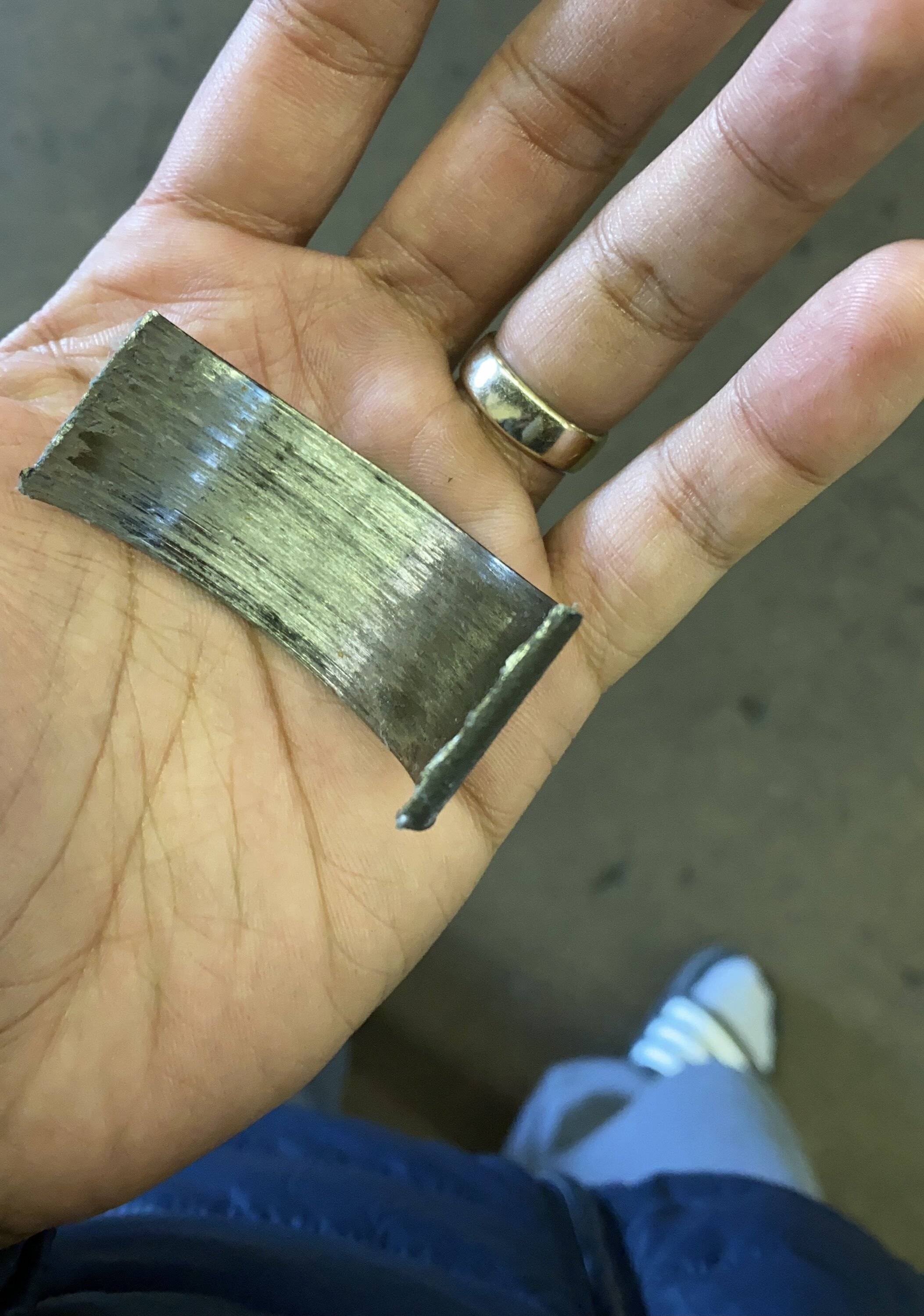

Had similar issue just cruising like 30 mph. Mine was a bearing. Please follow up on your next steps
