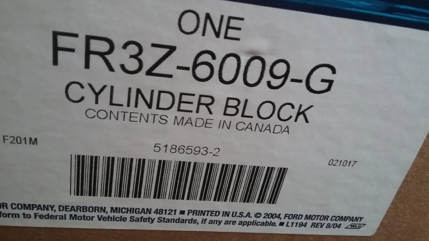

Yes that is crazy a catch can:eyebulge: Did you get a new short block or long block? here`s a pic of part# for short block, our noise was in the piston area with no oil contamination so it was a short block. They only install new engines because no rebuilds available yet for 2015 and up.Fresh engine build date 02/10/17
Just got off the phone. They said I had a piston go crazy which destroyed everything. They put a new long block in, I might be able to take it home today.
He swore up and down that I do not need a catch can and highly recommended against it unless I was going to supercharge or add a turbo. He said that could have been the cause but they cant determine it.
He said they have NEVER seen a 5.0 catastrophic failure this bad. Keep in mind these guys deal with Beefcake racing. They've seen some shit
What should I do? Should I be worried about this? Should I just go for an extended warranty?
