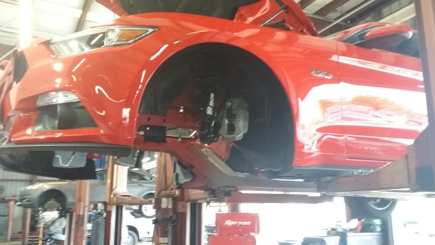

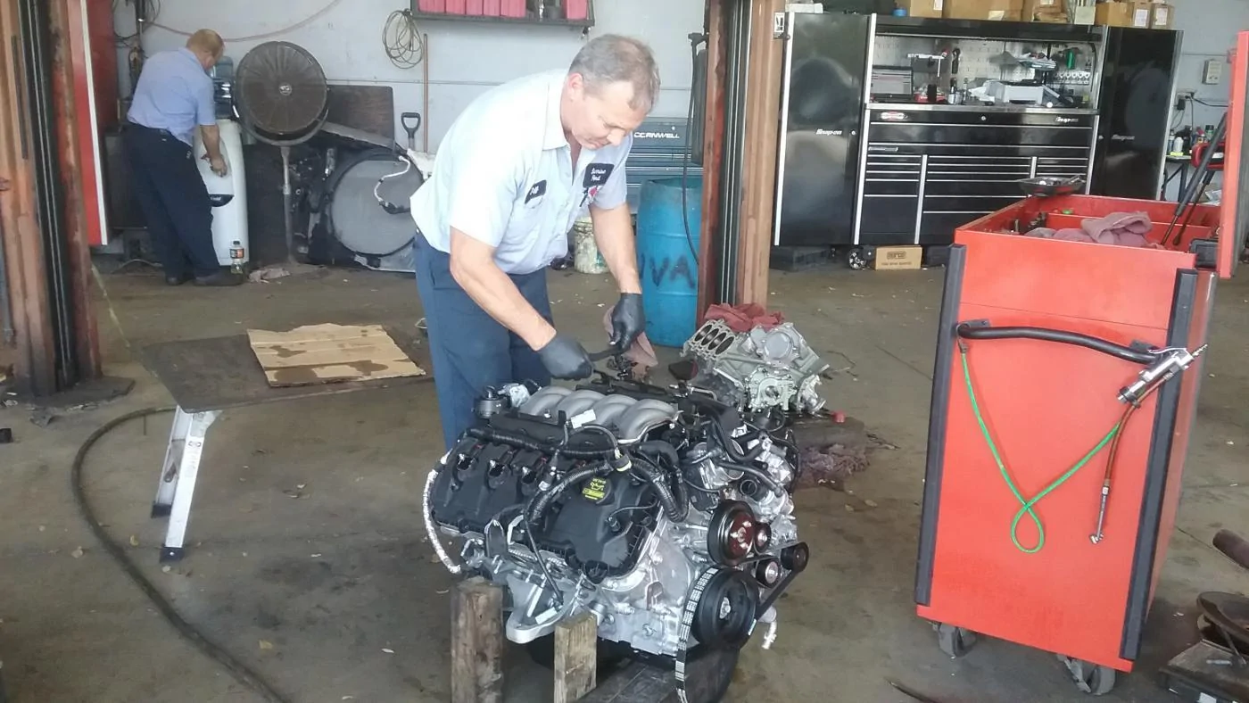

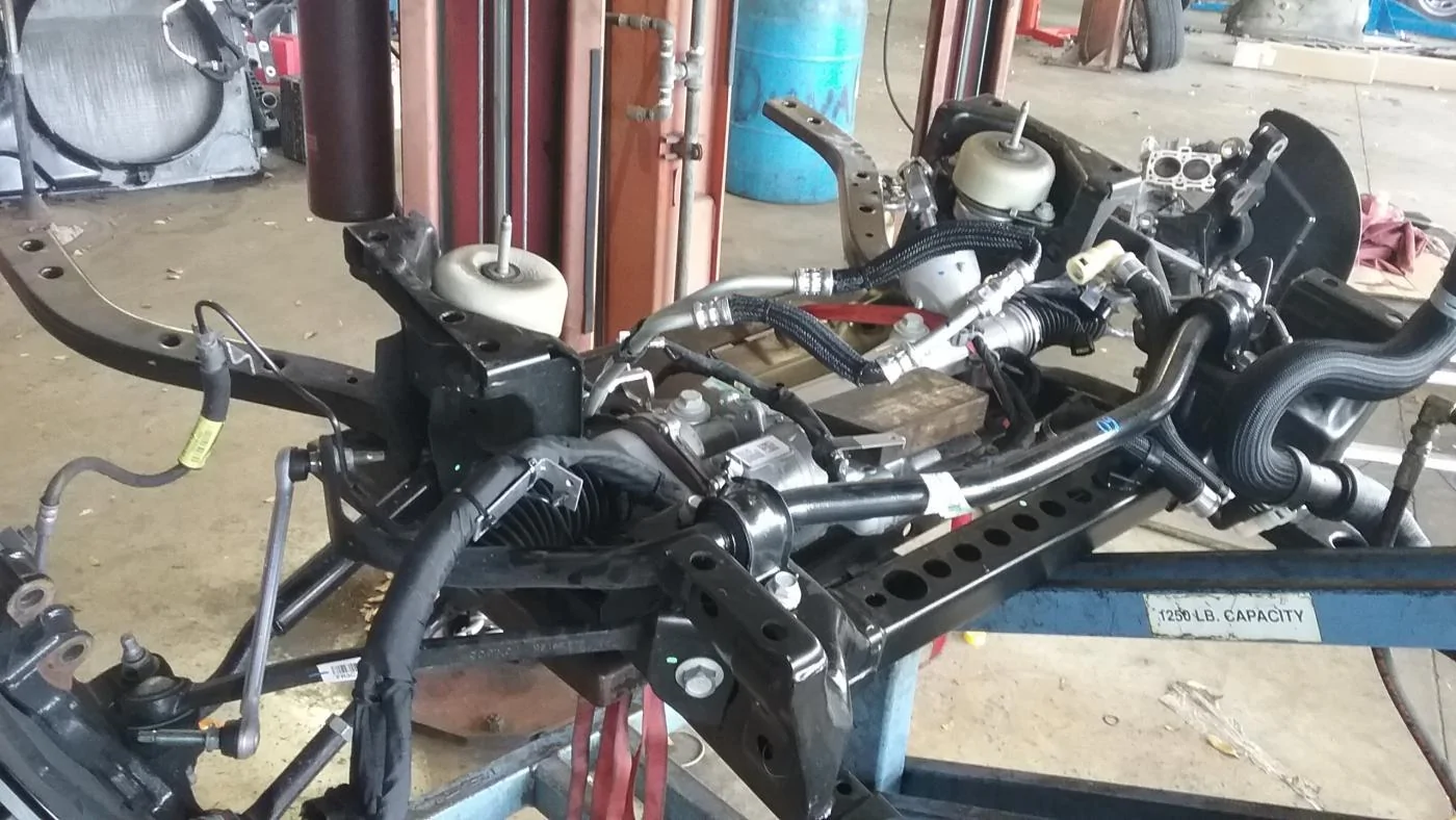

No ,I said that as a joke. They were very good and said sounded like wrist pin piston slap knock. After engine was pulled you could see where # 6 & 7 had some cylinder wall damage from to much clearance, piston slap. We were lucky to have the best mechanic he always dose a great job he`s been there 30 years.:hail: But we were surprised when it start knocking we have had Mustangs for 50 years:eyebulge: And this is the first one that has not been tuned or raced just a garage queen:headbonk:The dealer said that you babied it and that was the cause for the piston knock ?
