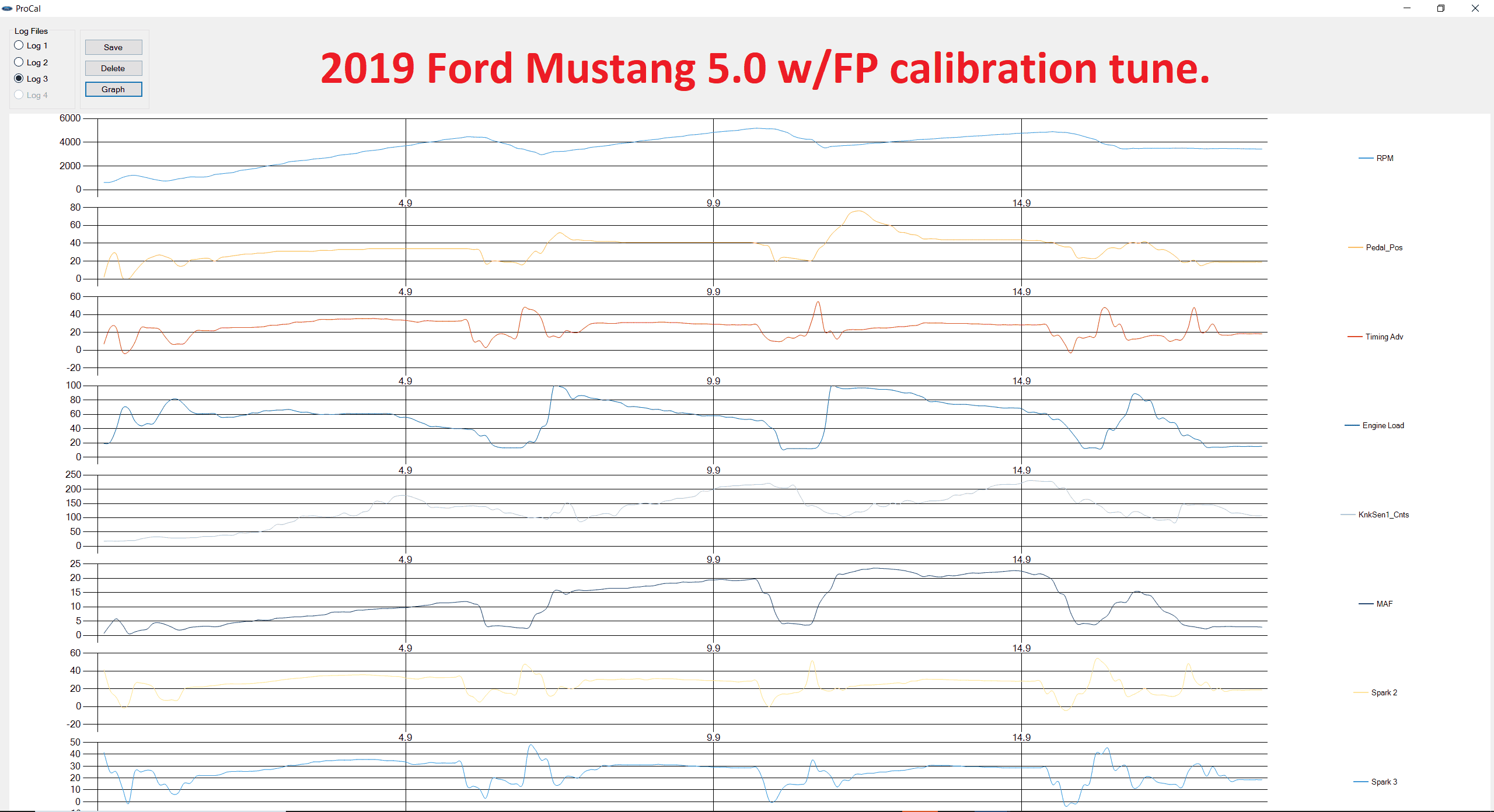

I've ran with the Procal4 data logging. Knock counts don't reveal anything terrible. This was a log I did after the Costco gas was out of the tank. Do you see anything abnormal?

Is there an actual KR value? I think the one you logged is the frequency which is hard to decipher.
Do you mean knock counts? I made this video shortly after the knocking started. I am in neutral lightly revving a few times to see the knock counter. But what I have learned is this is raw data from the sensors. Not indicative of a true knock condition but who knows? I never got a definitive answer on what those numbers mean. I did data log TimingAdv shown in my previous posts.

Knock counts I believe is a sum since the engine was started.
You want the live knock value that is 0 most of the time but then blips positive or negative briefly.
Ah ok. This is the one I should be logging: KnKAdder - "Timing corrections based on knock sensor feedbacks"
I'll grab a few logs with this enabled this evening. Some uphill pulls always guarantee I'll hear the knock.
These are the only parameters I see for knock:
-KnkSen1_Cnts - Raw noise data from Knock sensor bank 1
-KnkSen2_Cnts - Raw noise data from knock sensor bank 2
-Lrnd_knk_Mod - Not sure?
-KnKAdder - Timing corrections based on knock sensor feedbacks
