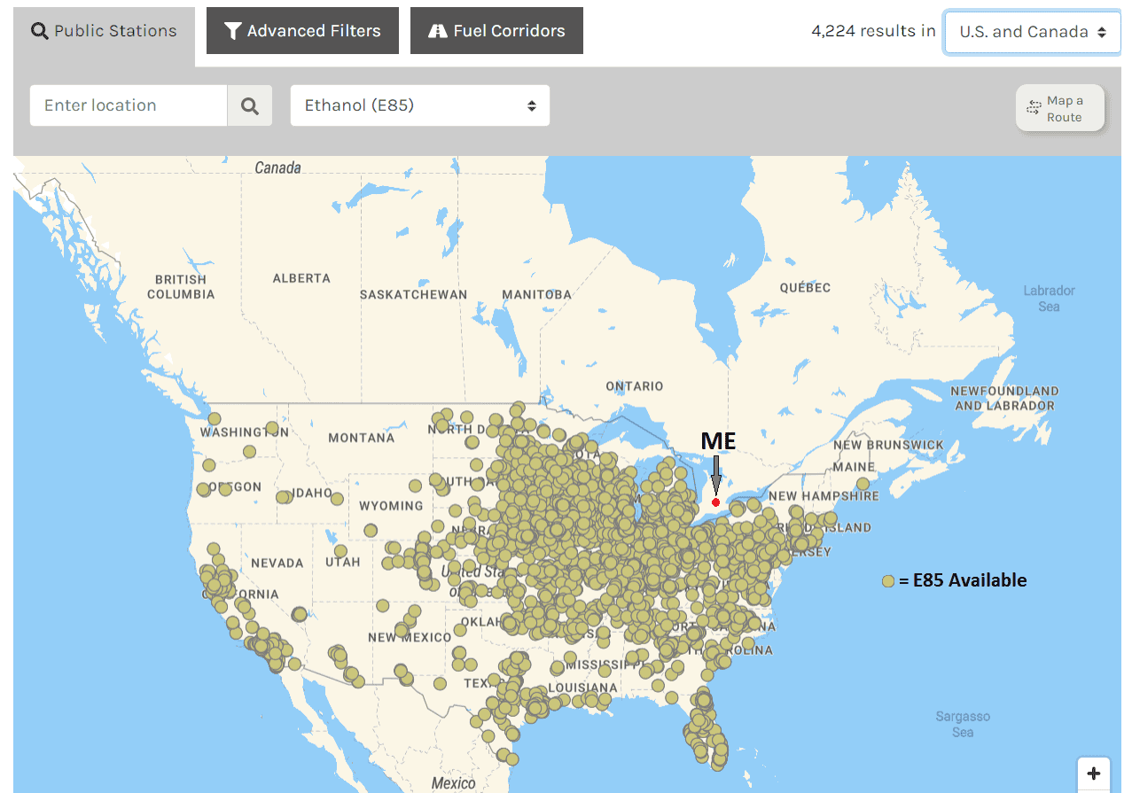

Have you tried adding 2 gallons of e85 to see if the knock goes away. if it does its real if not its mechanical. Lots of low speed timing gives LSPI. it plagued the mzr motor back in 2006-13. adding a bit of corn can help with diag.
E85 is not available in my country. Otherwise I would thry that.
