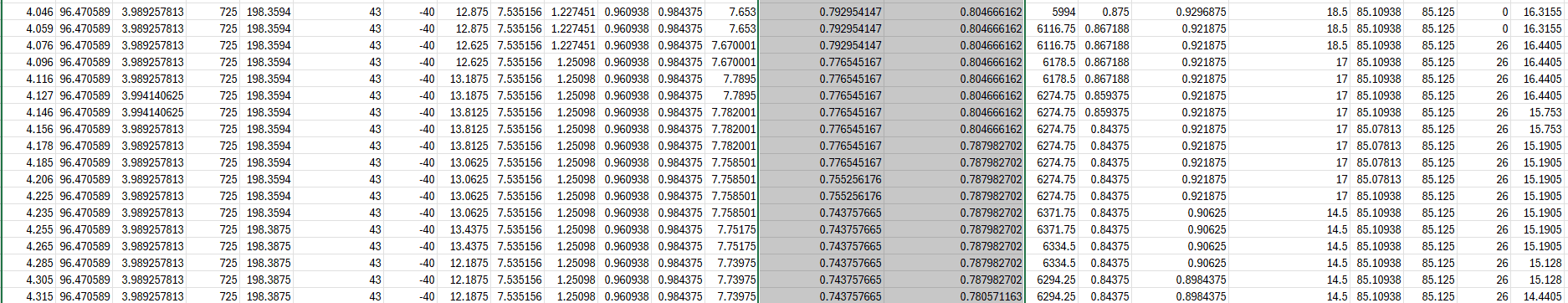

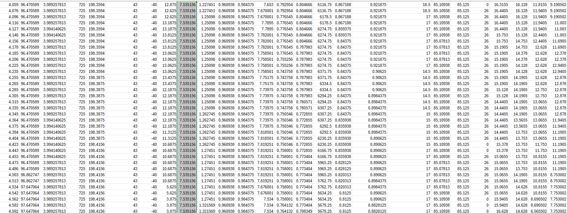

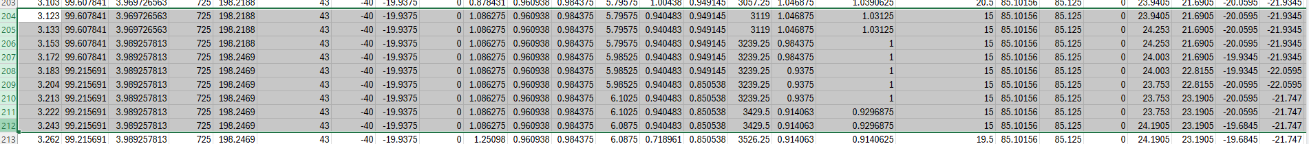

I am still getting a P008A low pressure code on my 21 GT. I have replaced the entire fuel pump, injector rail sensor, and high pressure pump. I have inspected fuel lines to make sure that they are all in the correct direction and orientation and am not sure what else to do. Whenever I accelerate past about 3500, i get a wrench light and the car cuts power and immediately goes into engine management/failure mode.
Got headers, JLT CAI, and full exhaust, and previous owner did remove a supercharger before selling. I attached my latest datalog.
Any suggestions are really appreciated, i need help!

Well,
The PCM is pulling 5 degrees of timing at around 3000 RPM
and you are knocking like crazy Through the rest of most of your pull. Stop doing pulls until you figure this out. Why aren't you logging fuel rail pressure?
THE PCM is adding fuel denoted by the .75 AFR on both banks
Have you done a compression test? What do the spark plugs look like?

I haven't done a real pull in about 2.5 weeks. I've been driving the car under 3k rpm for a while. I'm not sure why that isn't logged. I had the HPFP installed while I was out of town by a friend who used to be a Mustang tech, he said that it's running 20 psi high on the low side and 20 low on the high side. Have not checked the plugs, also was told to check the follower on the passenger side camshaft in between the pump and cam, the lobe on that side is how it was described to me.
