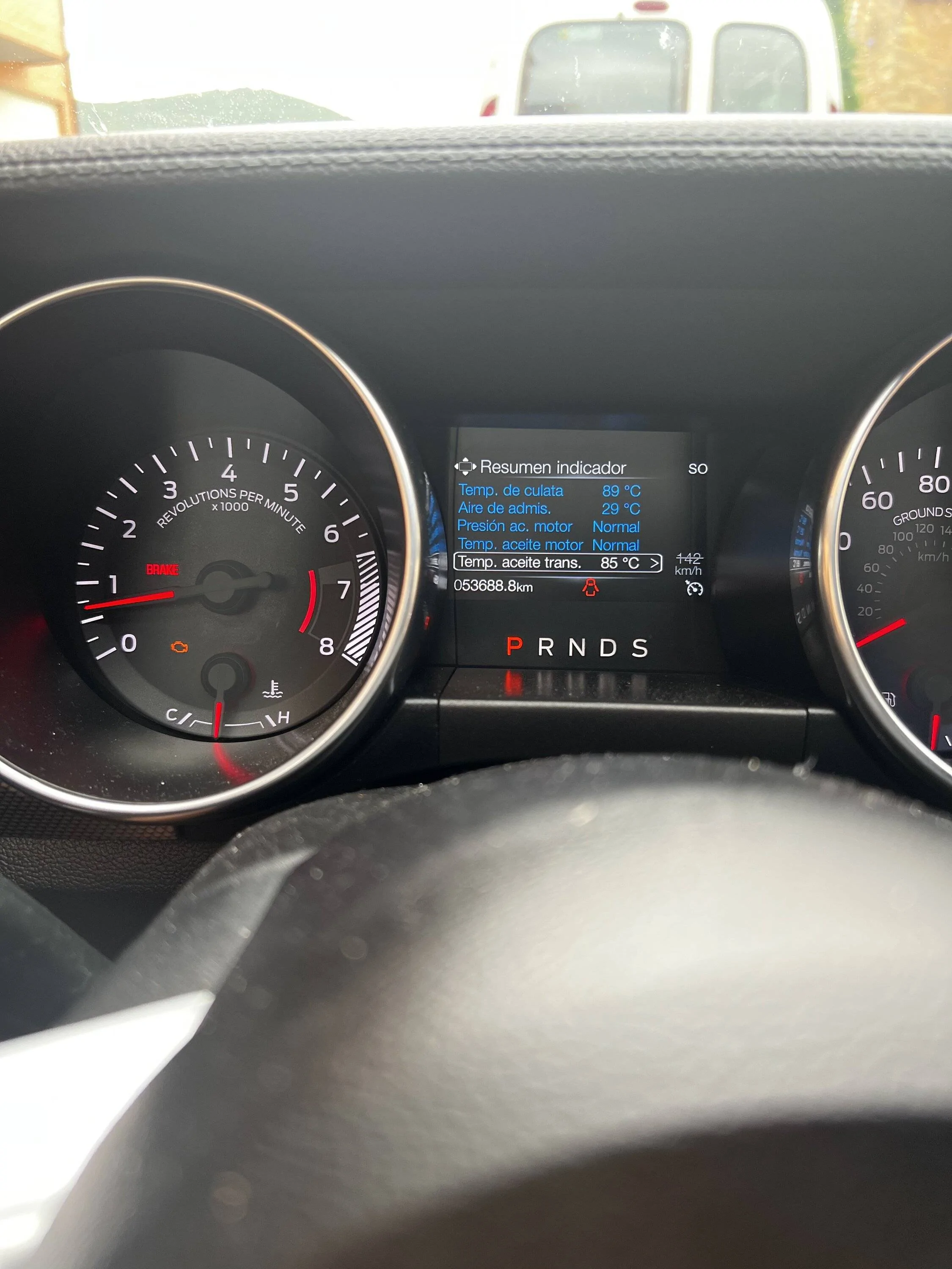

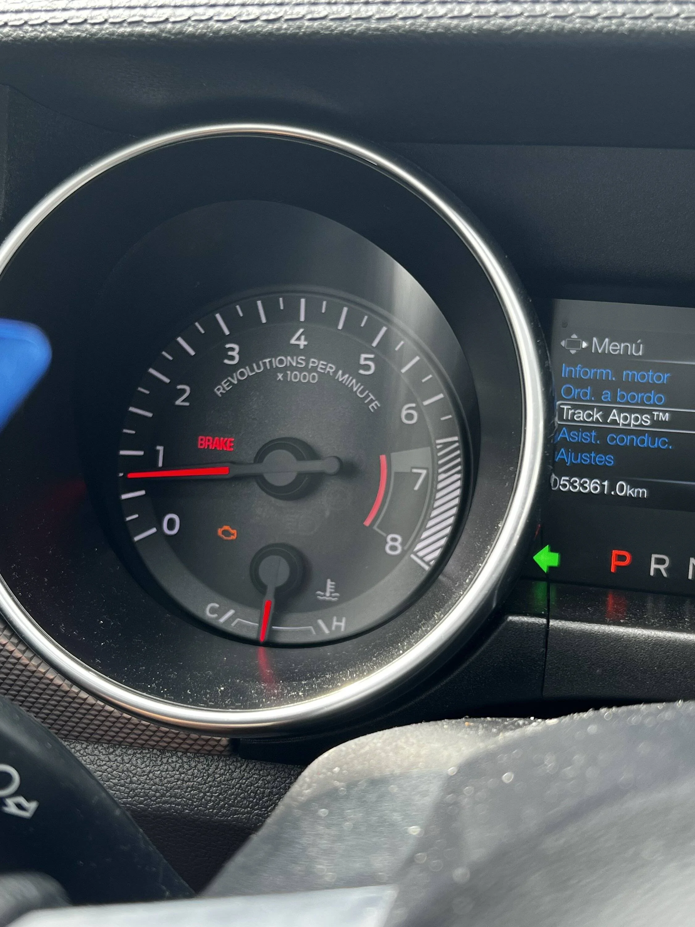

hello guys, does anyone know why this engine failure came out? in the on-board computer all the temperatures are in order, there are no faults I made a trip of 400km with quite a lot of heat 40 degrees I parked it for two days and when I started it the fault came out.

Get a bluetooth obd2 scanner and scan for the codes. It will tell you what the problem is. May be o2 sensor if you dont notice anything wrong.

In the states most auto parts stores will read the codes for free. Maybe there too?
I'm not sure why you went straight to temp readings as that light can be any number of things. It's usually/ always something that will affect emissions but you need to read the code/s before going any further.

Still need to know what codes it is throwing.

The check engine light means there is/was a malfunction somewhere. You need to get the diagnostic codes.

You can pull codes using Engineering Mode...
If you have a 2015-2020 with the ANALOG gauge cluster, you should be able to enter the “Engineer Test Mode”.
Follow this link:
https://www.mustang6g.com/forums/threads/engineering-test-mode.27581/
If you you have a 2018-2020 with the DIGITAL cluster, you should be able to access the same test mode found here:
https://www.mustang6g.com/forums/th...n-18-digital-dash-old-way-doesnt-work.115231/

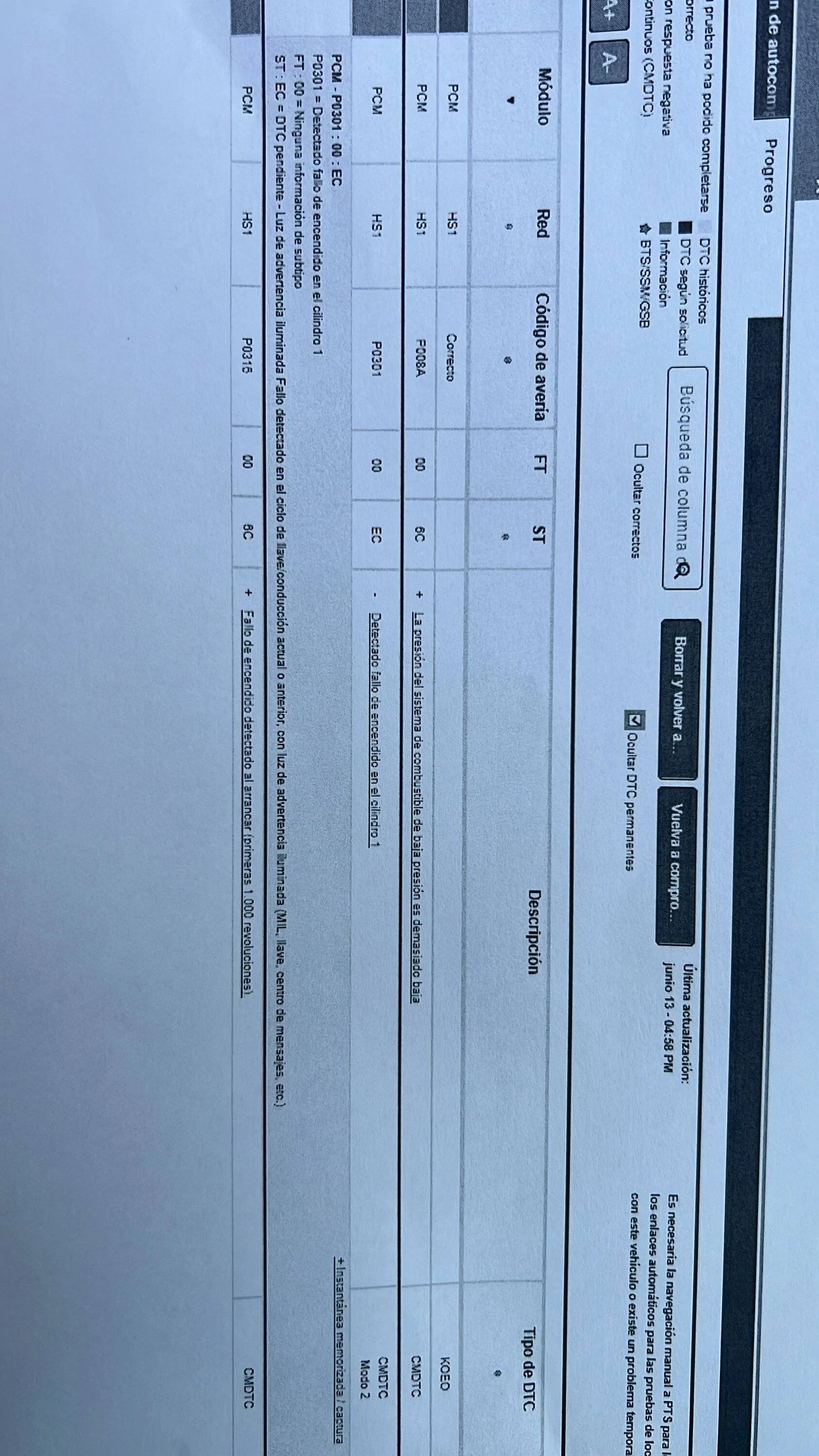

Injector…???
