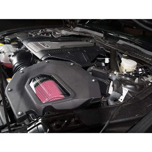

No one makes one. Why? in traffic/drive thru at bank i can regularly see AIT of 140+ in this heat. With Shelbys getting cheaper and more and more people daily driving them, this feels like an untapped market.
Honeybadger has seen an appreciable benefit on his track-only car as well.
Who wants to help me make one? could one from Steeda/others be adapted to work with the GT350? As long as the original maf tube is used, does it matter whats before it?

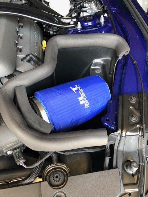

This might be worth trying if you want a better seal. It's cheap and works for me and a few others. Doesn't look bad if you make nice cuts and take your time.
