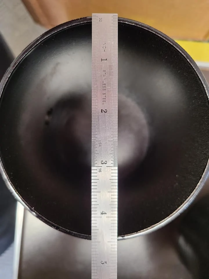

I can't imagine a 4.0 or 4.5 inlet fitting well on a stage 2 P1X/D1X.
They use a reducer. Not much taper on the 4" to 3.5", but that will change.
Im talking about the inlet pipe fitting in general. Blower inlet on p1sc to d1x is 3.75in BTW.

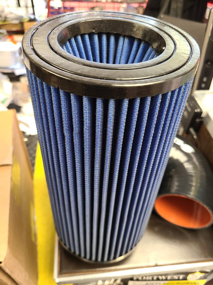

MAK claims they designed the new 4.5" tube to fit with the Big Red BOV, and they have had 2 units testing for 10 months. A P1X & a D1X. I'm sure pics and more info will be out soon. They do include a much larger S&B filter too. The original was supposed to be a solid 20-35HP gain. Less straw sucking effect.

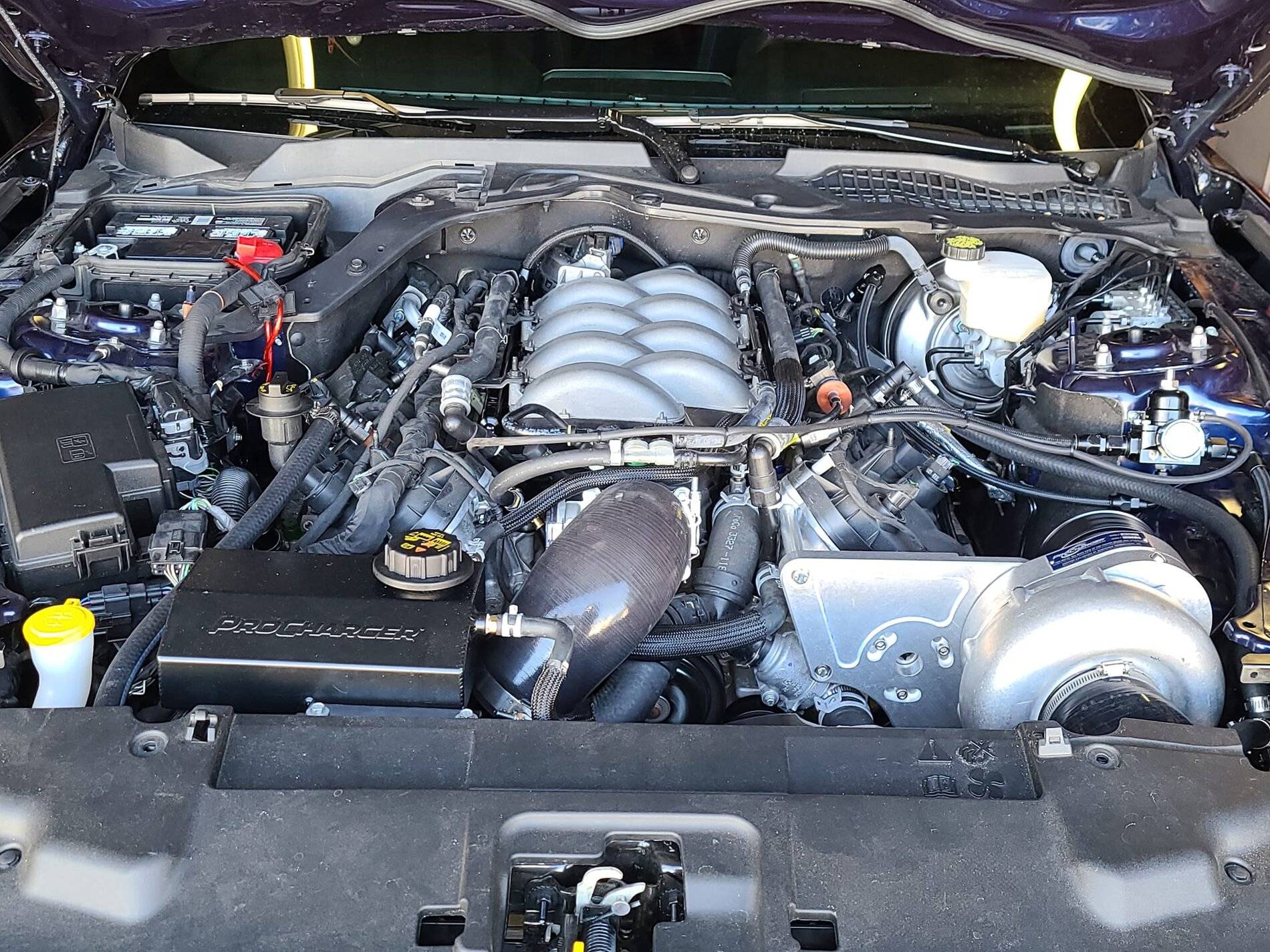

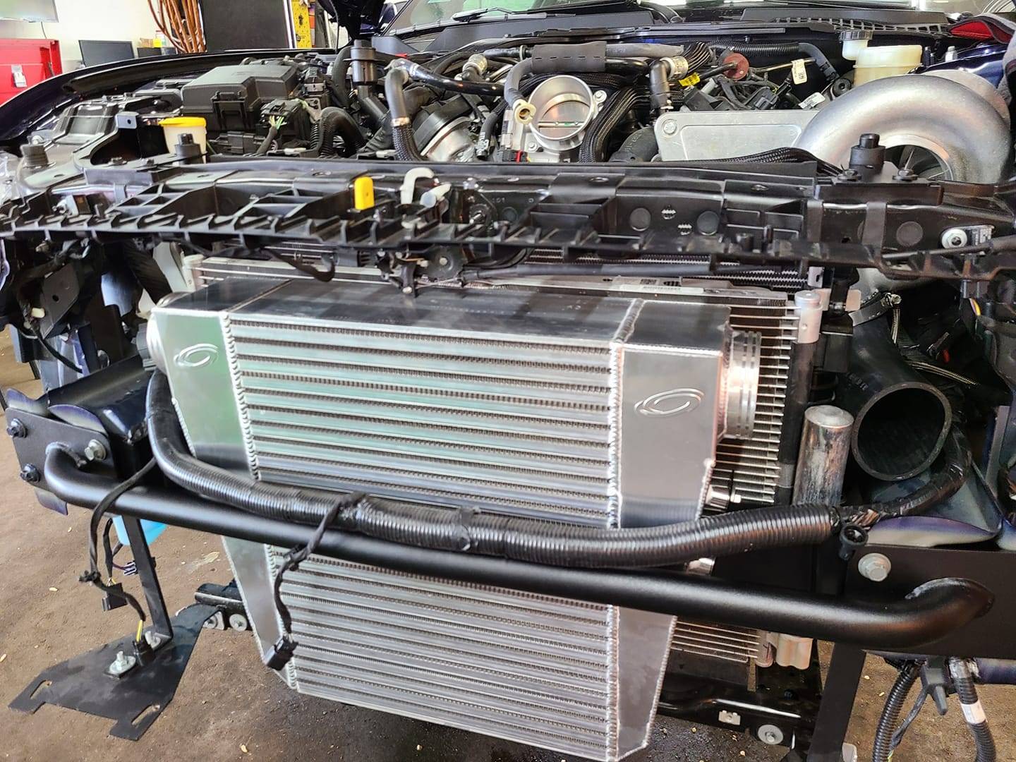

Install is done.
