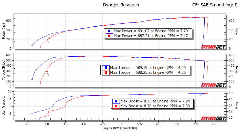

Finally getting the normal driving smoothed out thanks to Rob Shoemaker at Palm Beach Dyno. I only have the Stage1 kit on my '18 A10 'Vert with long tubes on 91 pump gas. I was expecting mid 600's and was surprised to be knocking on the 700 door. Thinking of a GT350 throttle body, BAP and maybe the bigger Stage2 Airbox. This is the first time that I've dyno'd Rob's tune. Also had a lot of help from Chris Groves of The Dyno Edge in Albuquerque. Impressive, I think, for such low boost...

Great numbers!
Curious what pulley is on it with the stage 1. 3.25 still? Boost is less than 9lbs Max. Long tubes are really helping maybe...
May want to rethink the GT350 TB as I’ve been told there’s lots of issues tuning it. Shame though, they’re so much cheaper than the the 90mm ford racing.
Stock injectors from the kit?

The pulley is whatever comes with the Stage-1 kit. I think that it's supposed to be 9psi, but the headers reduce back pressure enough to lower the boost some.
Stock injectors and fuel pump. I did "port" the stock airbox by removing the carbon filter and smoothing out all of the bosses, ridges and casting flash. I also opened up the blocked parts of the grill on the airbox side to improve flow and lower IAT's. The exhaust is stock but without cats and the suitcase resonator. Ford full synthetic 5w20.
For some reason, this engine has always responded better than average to modifications. I probably got lucky on the factory build. Happens sometimes...

The Edelbrock website quotes the stage 1, 18-19 kit as 3.25”.
Having said that, they also state that it will produce 13psi max. which doesn’t seem to add up.

Rob is finally making progress on my stage 1 kit tuning as well. Still not perfect, has some jerkiness and surging at early RPM when you tip into the throttle, but better than it was. Not exactly happy with it, but the car does scoot good when you lay into it, so he's got that going.
Not going to bother trying other tuners until I do fuel system and E85 conversion.
I need to try and get mine on the dyno now, 690 is really good and not expecting that at all. Stage 2 cars aren't even seeing that.

Are your long tubes catted or catless??

Catless. They're the eBay Pypes Step-Up stainless steel clones that cost me $134. My installer thought that they were Pypes originals with black high heat paint on them. The Step-Up model name refers to the tubes being 1-3/4" at the port growing to 1-7/8" all the way to the collector. The mid pipe and the install were the most expensive parts of the exhaust. I replaced the suitcase resonator with a stainless steel H-Pipe and kept the stock mufflers.

You can't run the gt350 TB on a 18+, the GT350 TB is analog, 18+ Coyotes use a digital TB. You would have to run something like a BBK 85/90mm TB if you want something larger in stock bolt pattern that is also a digital TB. That or pick up the 103mm TB, adapter plate and intake

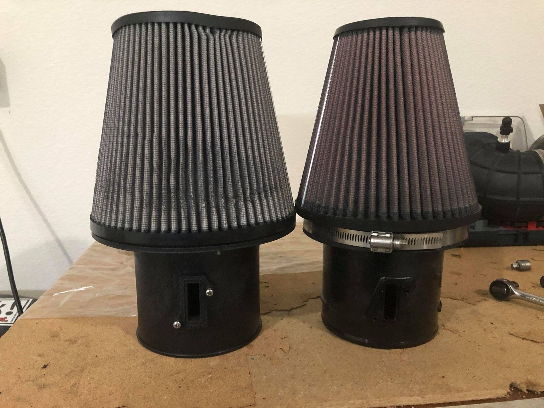

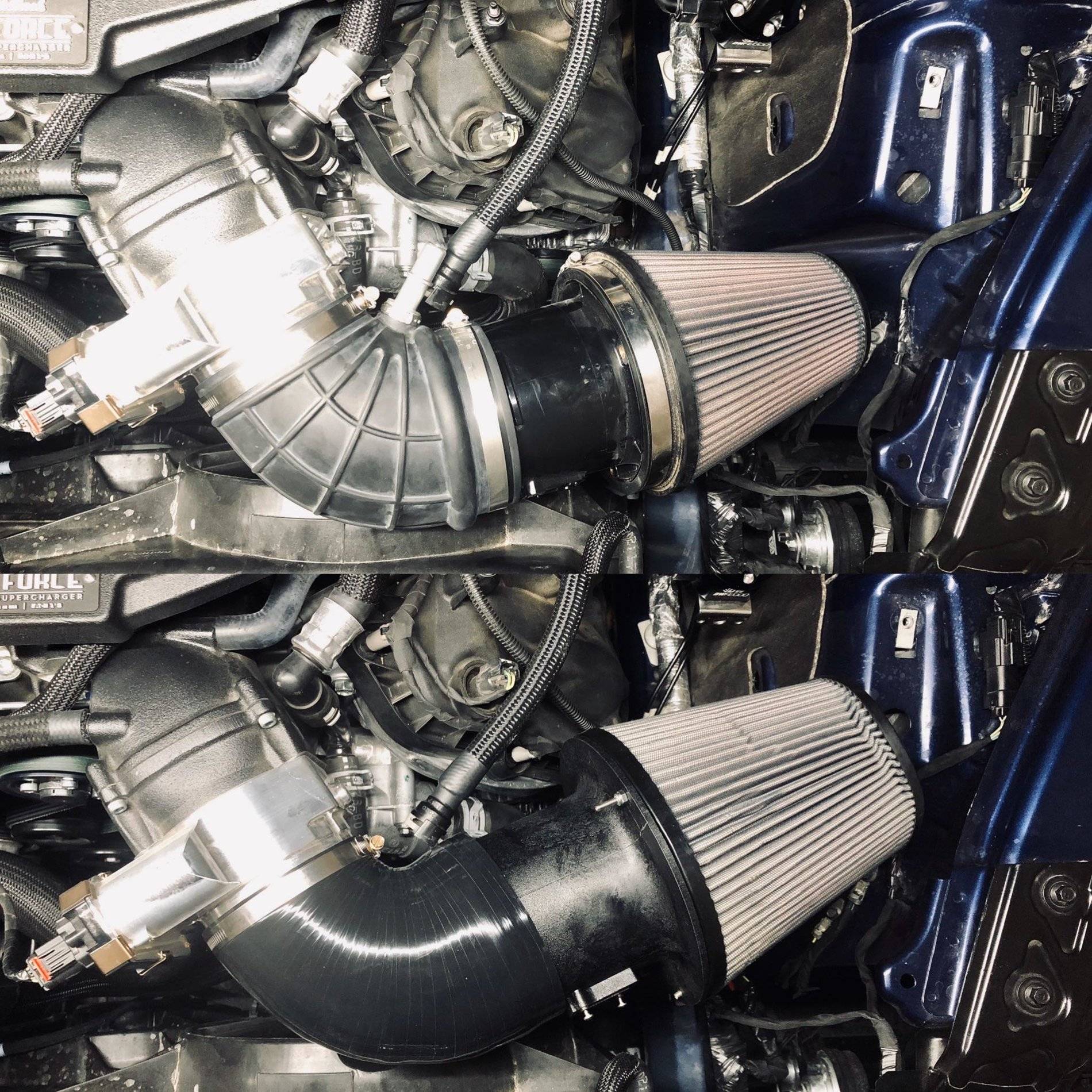

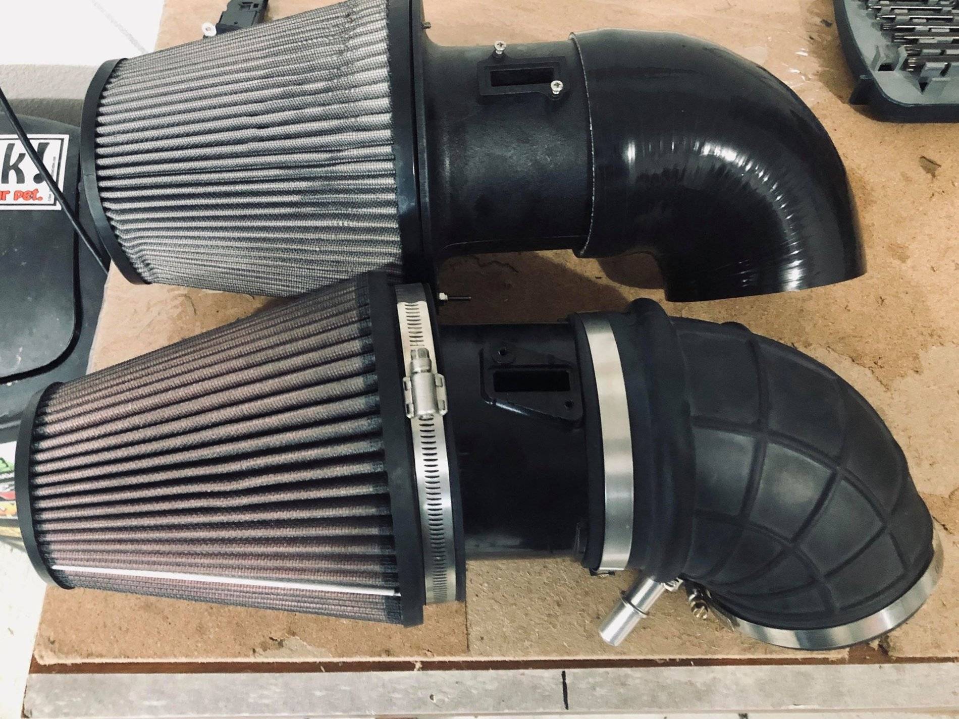

In case ya'll were curious on a side project I've been working on. While this may not be as beneficial to me since I already have the 113mm, the larger PMAS 120 uses a larger filter with more surface area so it doesn't restrict airflow like the Airaid one does.
Don't mind the beat up filter, this is a spare MAF housing that was donated to the cause
havent finalized anything with this new set up yet, I still need to decide whether I'm going to drill the MAF housing in order to add the PCV fitting or go VTA with the PCV to avoid drilling. I also need to figure out whether the PMAS heat shift will still fit, so need to get one ordered in order to check.
