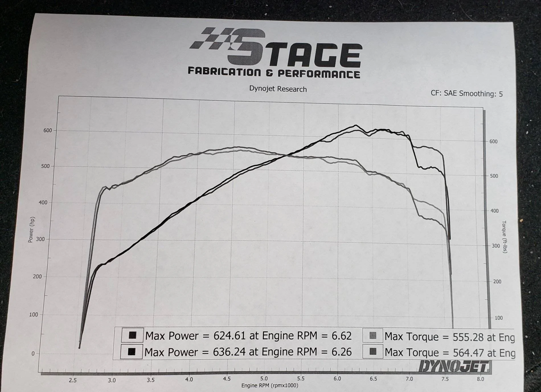

Finally had my 18 dynoed with the 2650. Numbers were lower than expected but I was more concerned about the knock I saw in the higher rpms. Talked to my tuner and basically it was use an additive or get a larger pulley. I just ordered a 3.5 inch 6 rib pulley going from a 3.25 to see if that helps. Just wondering what belt people are using, I dont see a recommendation from edelbrock for 3.5 inch 6 rib.
