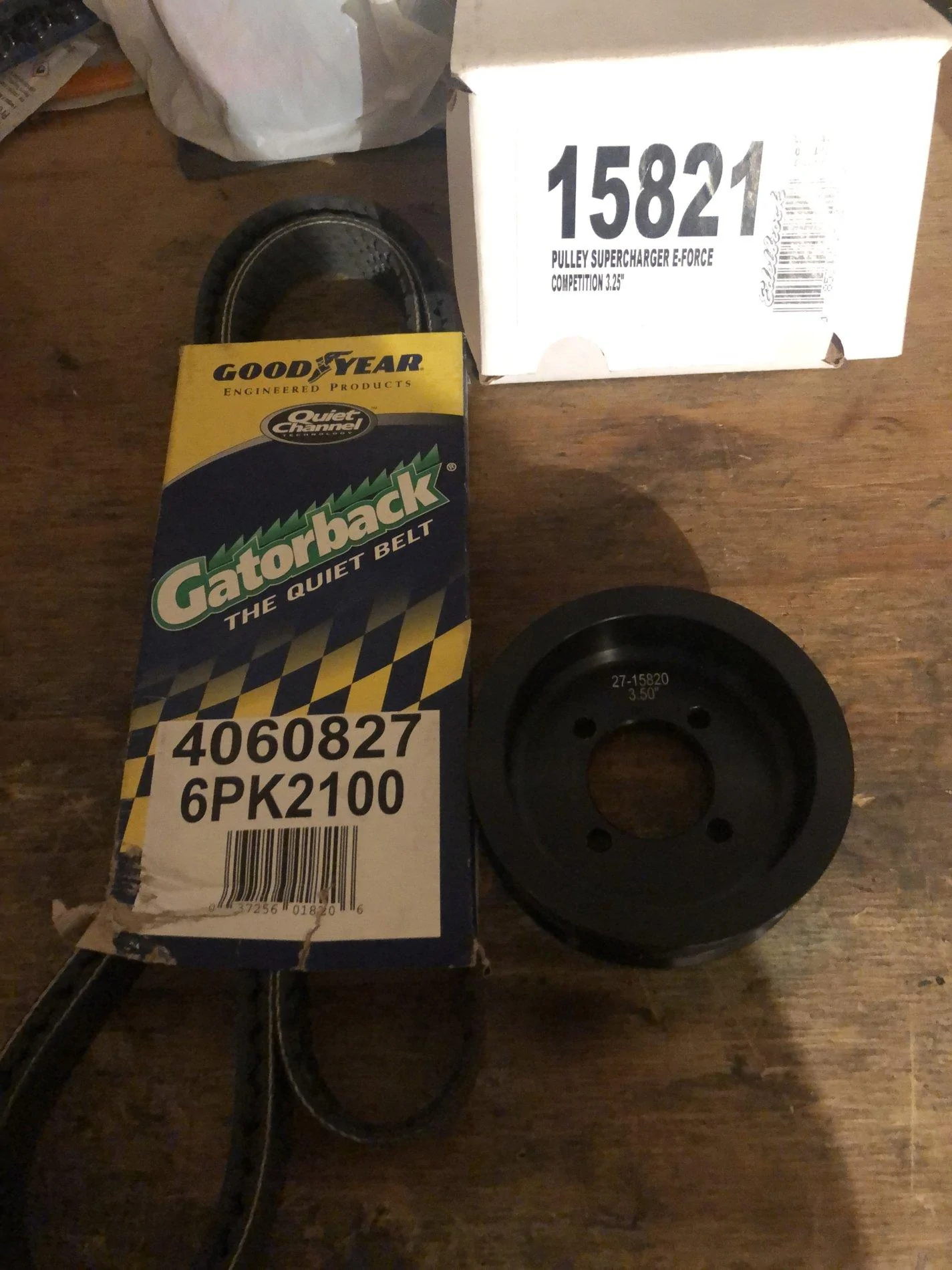

I installed a boost/vacuum gauge in the 1/8 port in the back of the SC. The boost gauge in the dash isn’t accurate. With the 3.5 pully I was getting 7lb of Boost. I am currently running the 3.25 pully getting 9lb of boost. I’m at 971’ elevation here in Ga. If you settle on the 3.25 you will need a Gates K060822 Belt; keeps the tensioner at about 60%.
Which belt were you running with the 3.5 inch pulley?

On the Gates belt for the 3.25 is K060822.
Don’t know what the 3.5 gates number is, I bought 3 different sizes to find the best tightest one for the 3.25.
I got lucky on the 3.5, it was the first one I bought.
