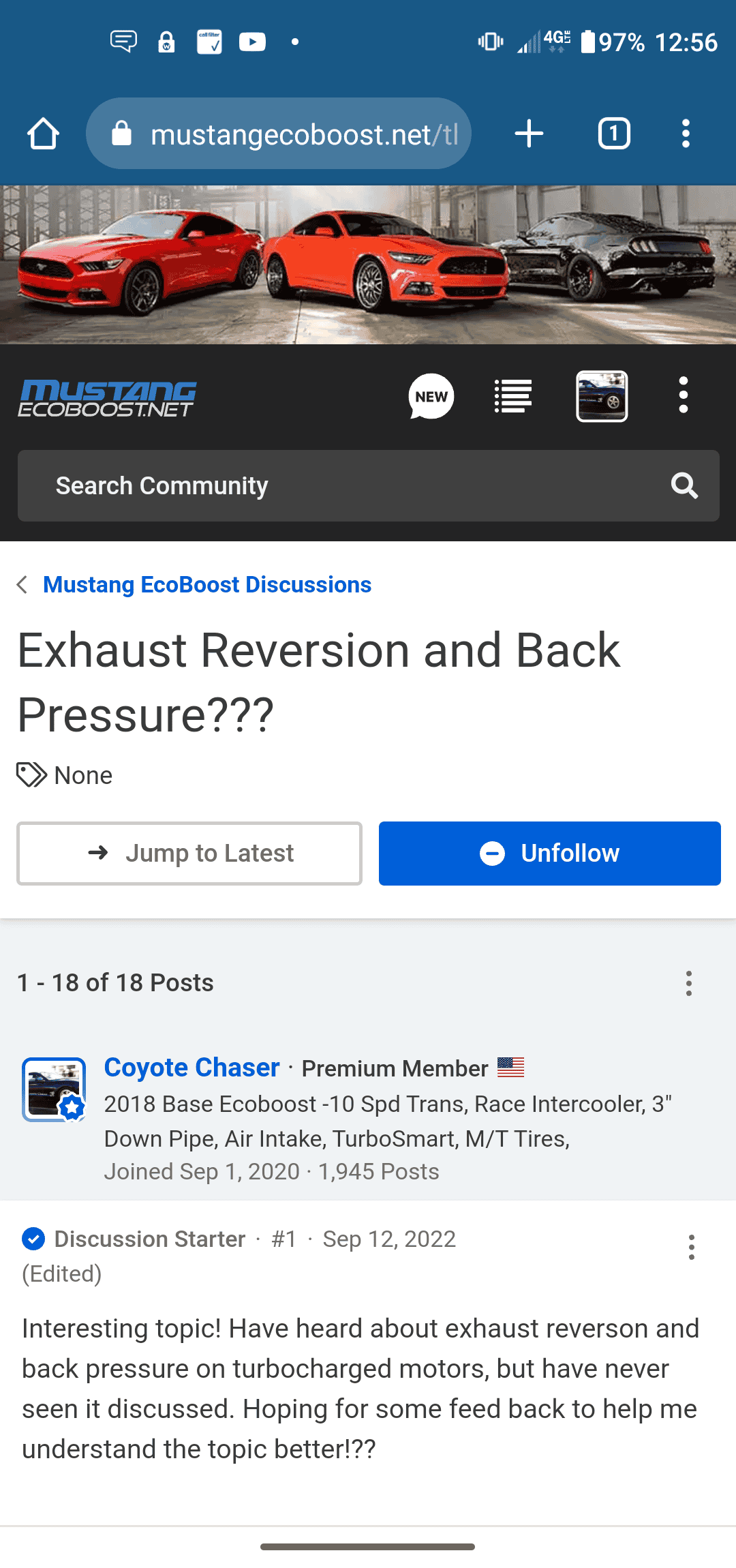

Glad to see someone else is just as curious! I have a thread on another site with some interesting feedback!
