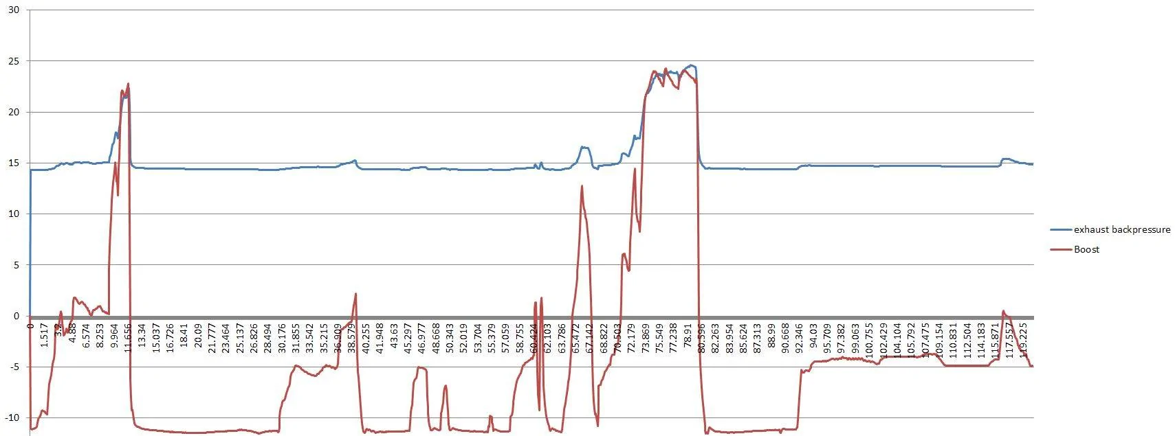

here's a log of boost pressure vs Exhaust MAP – The inferred measurement of exhaust gas backpressure in the exhaust manifold pre-turbine .

The graph is too small to see the numbers and color of which is boost pressure versus exhaust map so cannot make any conclusions from it.

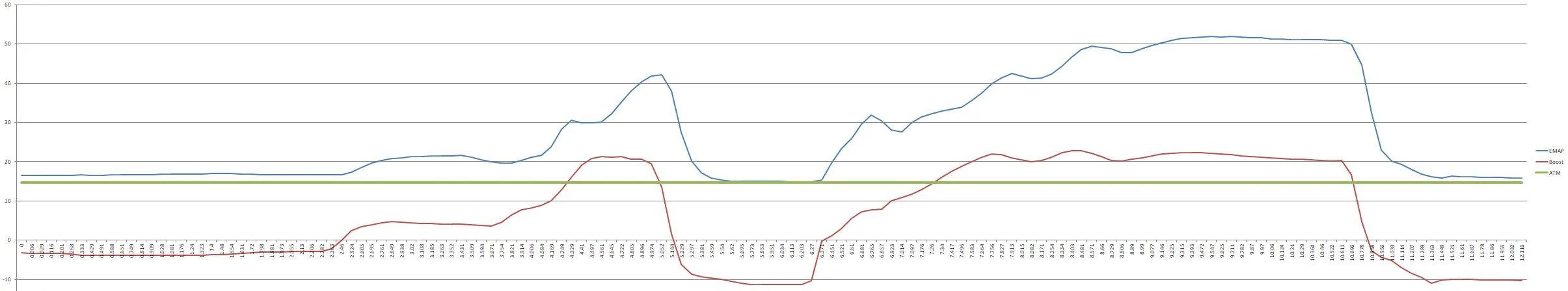

i also logged this parameter from cobb. Its confusing because i checked both parameters back to back with the car idling and they read 14.7 psi but this one only peaks below 25psi. even if one of these is absolute pressure and not gauge pressure things don't quite add up.
Exhaust BP – The inferred measurement of exhaust barometric pressure in the exhaust manifold pre-turbine.

Actually, it does make sense with at idle the boost is a negative pressure signal with it being in a vacuum in the intake and will only go into positive boost at throttle openings above idle and is dependent on how far you push the go pedal as to the max boost you will see. With an OTS cobb tune or the FP tune 24-25 psi boost will be the max you will see at WOT, my FP tune maxes out at 24psi.
The exhaust BP on the other hand will always be a positive number since it is doing work driving the turbine wheel so should be close to 14.7 at idle and rise when under positive boost against the intake's airflow being boosted by the resistance to the intake turbine wheel being spun by the exhaust flow.
What you don't want to see is the exhaust BP to increase more than the boost pressure by over a 1.5 to 1 ratio. Example would be 24 Psi intake boost and 36+ psi exhaust BP readings. Ideal is 1 to 1 or as close as possible to that ratio as possible.

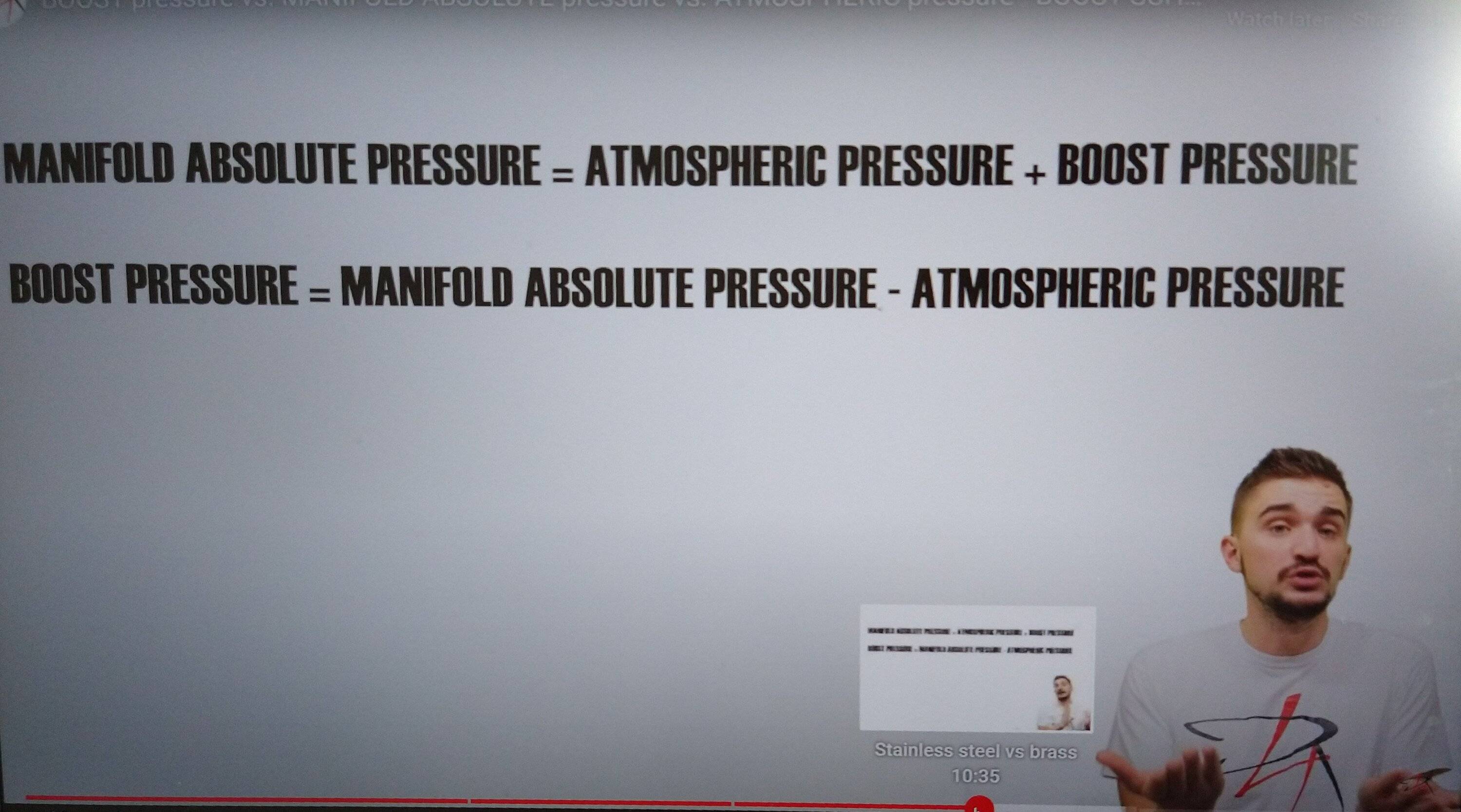

A 2 to 1 EMAP to MAP (not EMAP to Boost) ratio is acceptable for most non performance turbocharged street cars.
Here's a YouTube video that explains my statement.

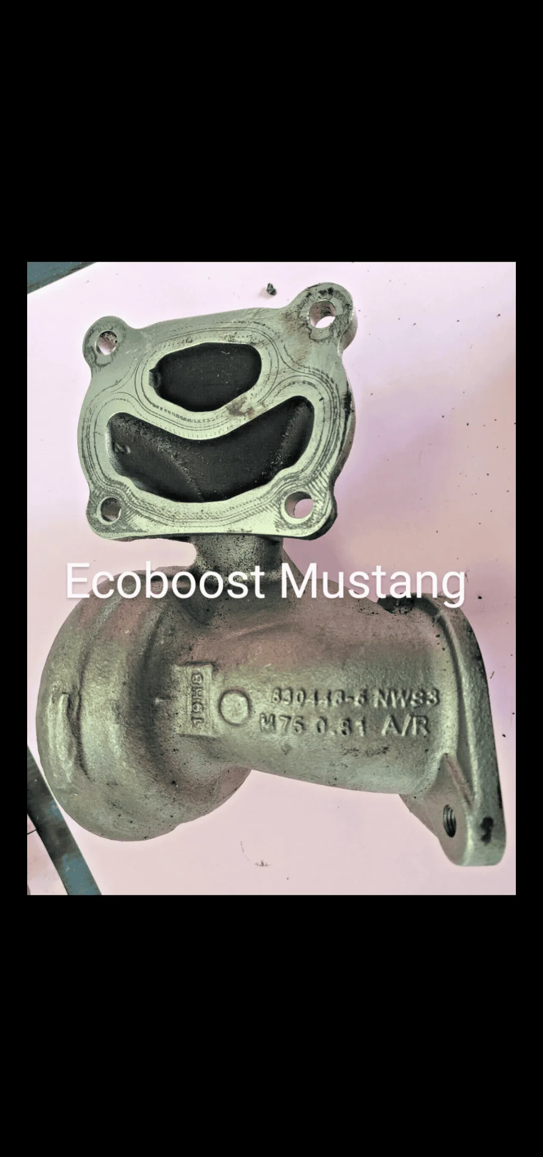

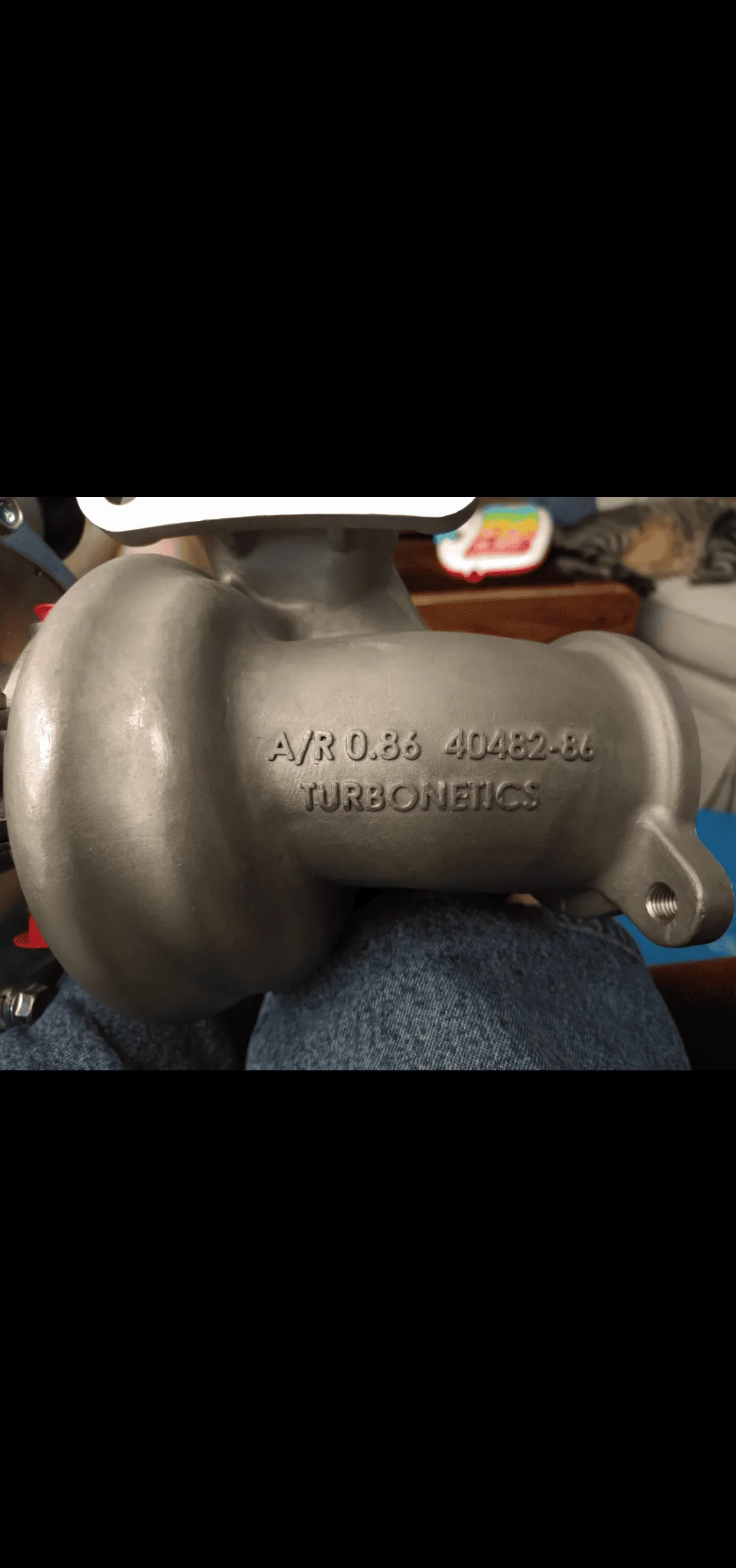

A better flowing head is a big plus for any build. But one of our big issues, lays in the A/R of our turbine housing. I also don't like the integrated head, but I don't have much choice, with a limited racing budget.

I'm planning on running the Precision "drop in" Turbocharger next season. I'm hoping for a ratio of 1 to 1.5, but don't really know what to expect!??
PS: And it will be equipped with an Exhaust Manifold Absolute Pressure gauge.

I've seen it done 2 different ways, psi to psi and EMAP to MAP. What's most important to me is being able to record the information onto my data logger. And someone smarter than me is going to have to figure that out!
