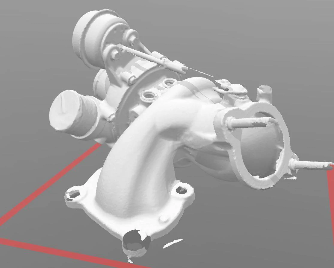

i have a spare turbo that i'm looking at now and it seems like a difficult/risky option to try and put a pressure sensor pre-turbine in the casting due to high temp/stresses. You could have a custom spacer made to fit between the turbo and head and be thick enough to put the sensor in. That could affect any of the various plumbing items though.
real time display/logging could be done with arduino or raspberry pi

I purchased the EMAP kit from Jessie Ringley of EMS (engineered motorsport solutions). And currently, he hasn't decided on the best location.
I like the idea of a spacer with access port!
To date Jessie has added EMAP kits to 2 Ecoboost powered cars. However, neither use the factory or NX2 turbocharger or OEM electronic control units.
