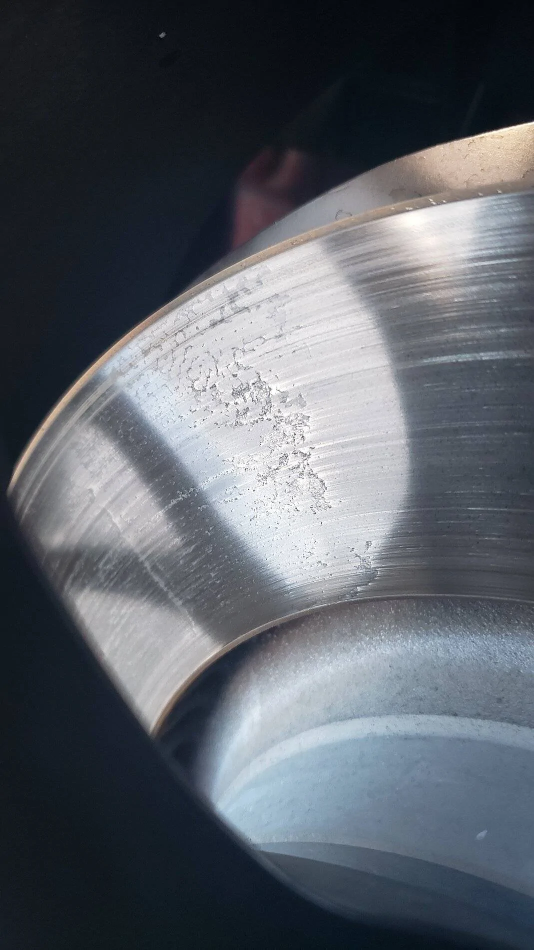

are there any good slotted or blank rotors for the EB PP/ base GT that aren't inverted hat? i also was interested in the DBA's on steeda's website but they confirmed they were inverted hat also. ideally i would like to keep the 4 pistons and upgrade fluid with some 1 piece, non drilled. this happened to my brakes after 1 track day at a fairly slow track (80mph top speed), not sure what exactly it is.

I believe there are some two piece rotors available for the 14" 4 piston system, but they are pricey. You can often find like new 6 piston "take offs", calipers, rotors, pads, ect., for only a couple hundred more than what you'll pay for 14" two piece rotors alone. And these rotors will have to be replaced eventually as well. Once you switch to the 6 piston 15", you can replace rotors for $50 ea. If you plan to use the car on a road course, seriously consider the 6 piston set up. Simple bolt on. Works great.
