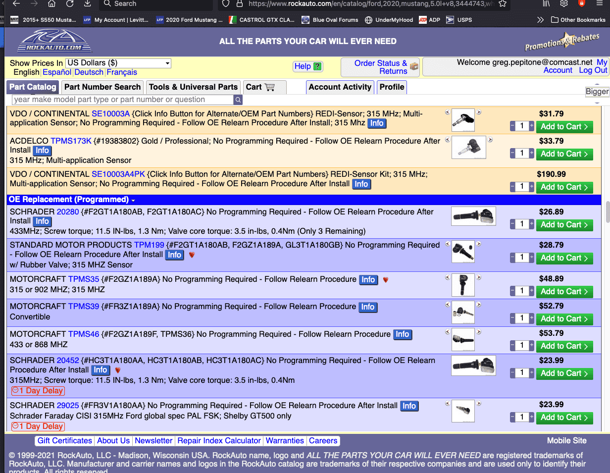

Anyone thought about Rock Auto
I considered it but for the two sensors that are cheaper:
20452: This the only one that doesn't match the OEM part numbers.
29025: Says GT500 only.
Besides the TPMS $28 sensor was only a little bit more and I felt like it was a safer bet.
