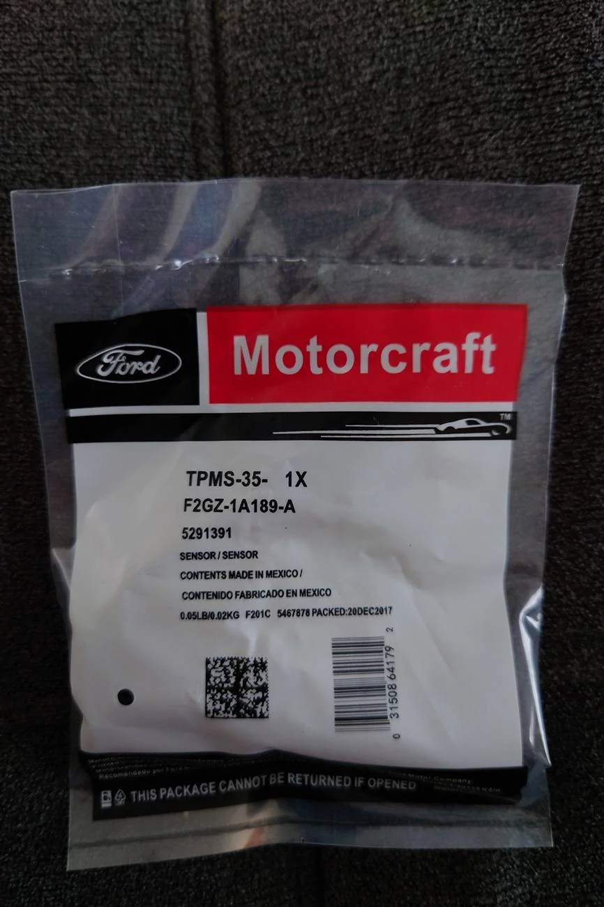

I did a wheel swap a few years ago. Niches for someone's used 2015 PP1 wheels. The PP1 sensors synced after a few days. I just swapped Yokohama BluEarth Winter tires for Yokohama Advan Sport A/S + and had the shop replace, without trying to program, new front wheel tpms sensors. The two front ones had been intermittently dropping off. The new TPMS part number is shown in the picture. I've driven 4 miles and they have not yet synced. I'll reply here with the results after a bit more driving. I have a 2018 GT non-PP1.
Checking the part number, those appear to be the correct type:
https://ford.oempartsonline.com/oem...sure-monitoring-system-tpms-sensor-f2gz1a189a
If that is the actual package of the units you installed, I have a concern: they were bagged in 2017.
TMPS sensors have two primary bits: an accelerometer and a battery.
As the wheel spins and the accelerometer becomes active, the battery is used to power the sensor, the wheel alerting the car.
Just like a bag of batteries of the shelf, I'm worried those units, if eight years old, are nearing end-of-life, or, have already lost a good bit of their power.
If bought on-line from a third party, it would not be unusual they picked them up from somewhere else, from an old inventory purge or stale inventory, and sold. If they don't work, hopefully they have a return policy.
If bought from a dealer or the shop that installed the wheels, save the receipt.
