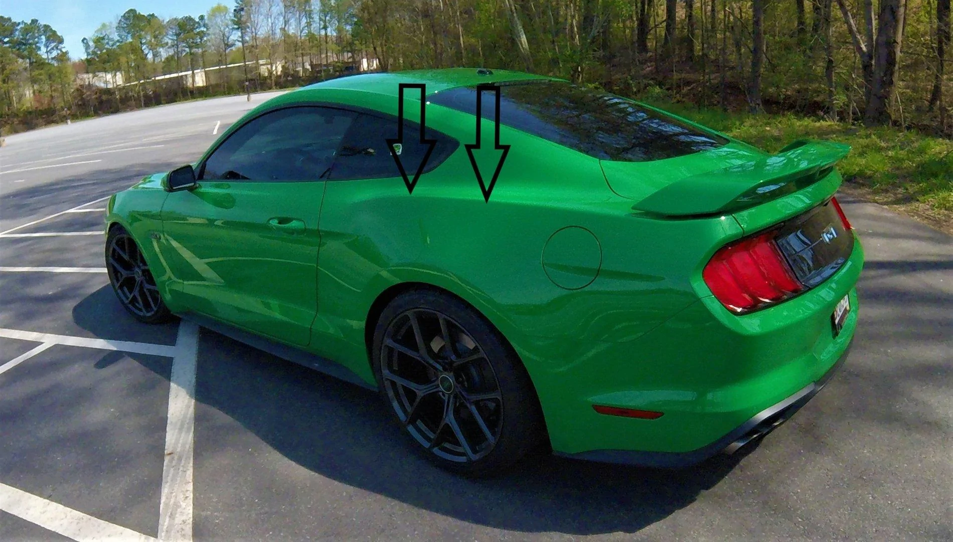

On my 2019 Mustang, I noticed when detailing this past weekend, that the area above the hip has some small dents. I know it's my fault because I place my hand here sometime when I lean against the car when getting gas, but I never put much weight down and never out on the flat section. It seems this is a very thin flimsy piece of metal even close to the crease. I am not sure it their is any access to this from underneath if the fender liner is removed, or I could get one those paintless dent guys to fix it. Anyone ever have this issue?

Well, mine is not on the crease, just above it on the flat area. Sounds like one of these guys may be able to fix this if your friend had his repaired. Thanks for the info.

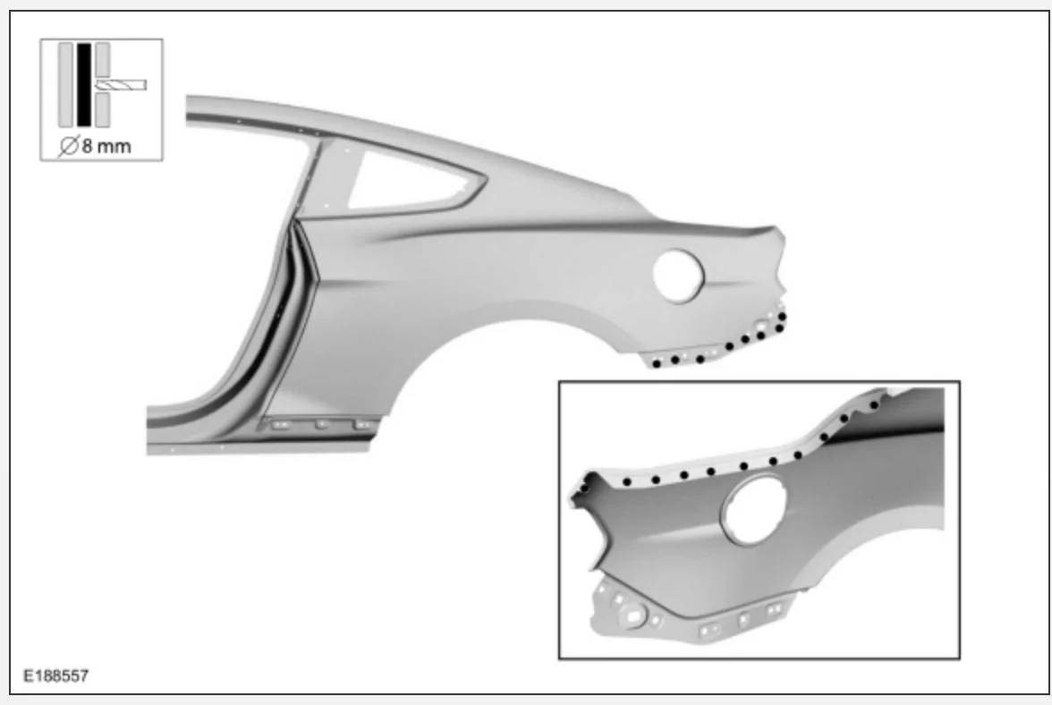

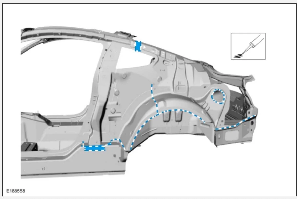

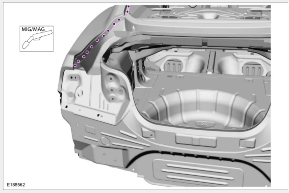

I can’t find it, but when the first S550 owners started posting on here, there was a thread about the early 2015/16’s coming from the factory with imperfections or dents in that same region being discussed. I recall quite a few pics being posted too...
Maybe someone can find that thread...
EDIT:
If the inner wheel well liners are removed you still cannot get to that flat area of the 1/4 panel, you will be blocked by the inner wheel well housing. The only way to PDR that would be coming in from the B-pillar (either through an existing access hole OR the PDR guy would have to drill an access hole to use the tools). Or they could probably get through some other access point within the trunk or from behind the rear interior plastics.
These are the only images I could find that would demonstrate what I’m referring to above.
