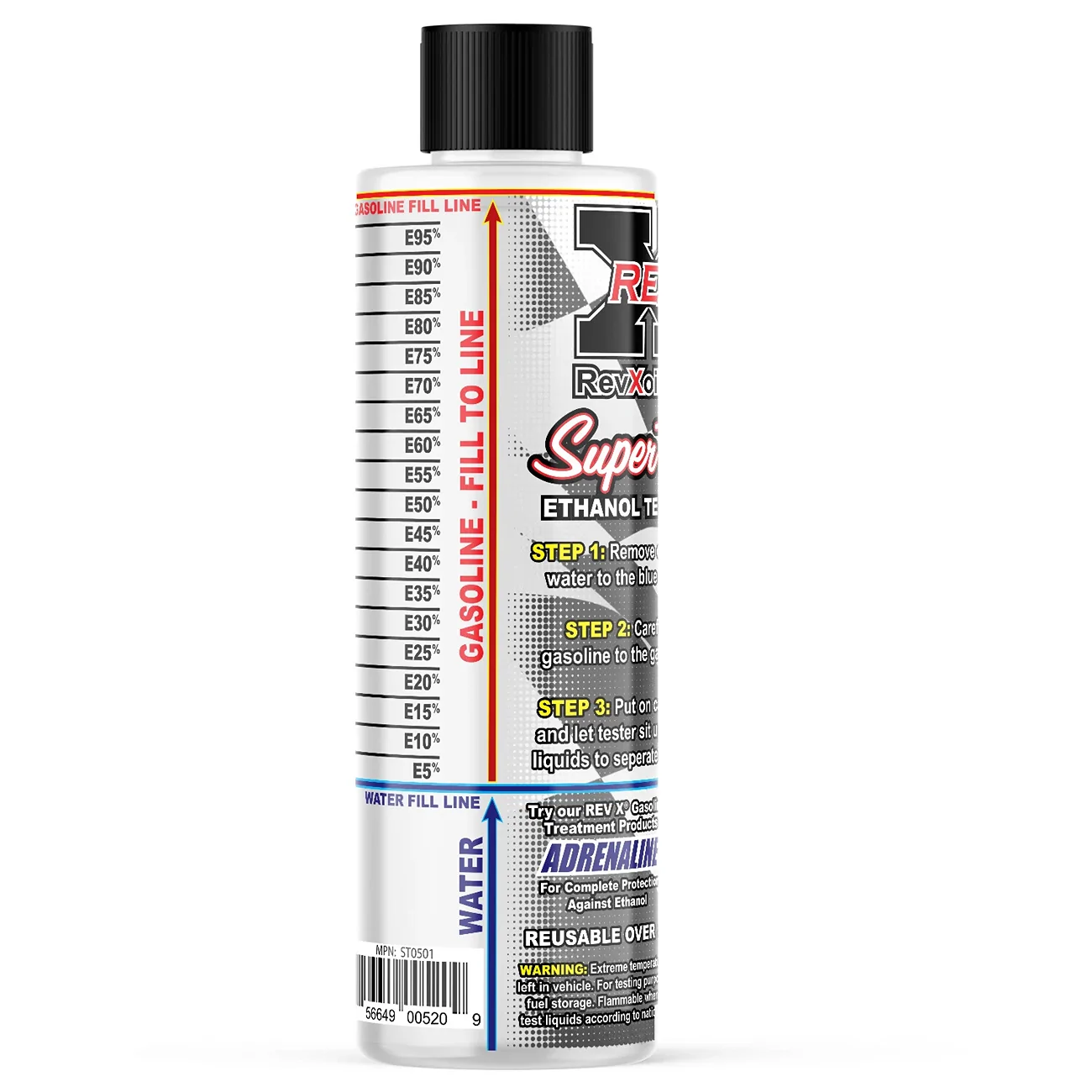

A bad batch of E85 can really mess with your performance and drivability. Purchase fuel from high volume stations that have good turnover and cater to the performance crowd if possible. If in doubt, especially with winter blended fuel, there are a variety of testers to choose from and checking for clarity and ethanol content is simple and quick. Additives are always a controversial topic but the Driven additive for carbureted engines (works fine for injected engines, too) seems popular.
