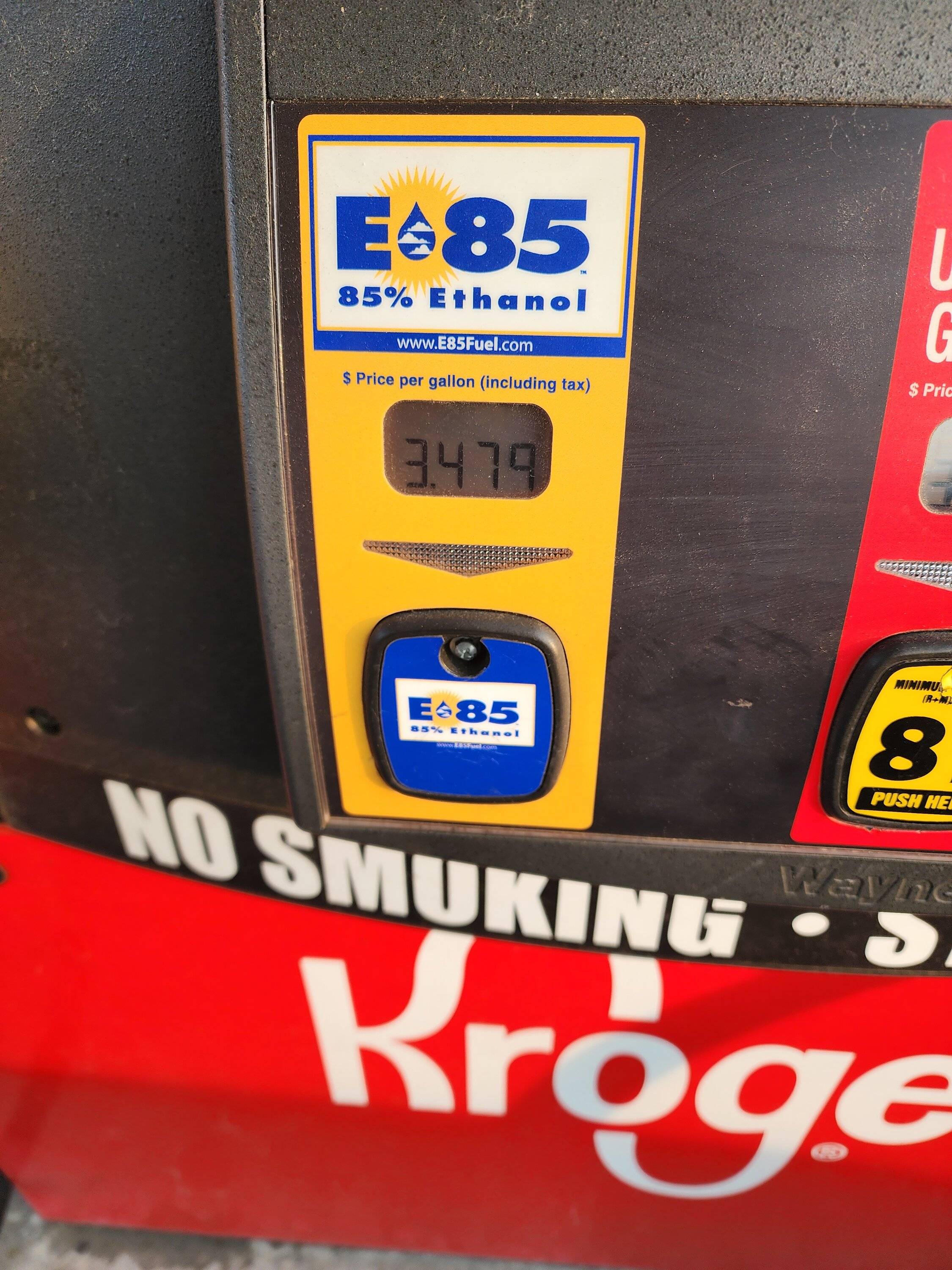

Finally a station close with true E85. Tested at E90. If I am correct this has to be at least E85 all the time, right?

That is certainly the implication. In CA we have the same stickers on pumps and we have EtOH > 85% (often ~ 88-90%) year round. Double check in the winter where EtOH content decreases in colder climes. I don't know if KY will get a "winter blend". Either way, congrats on getting the 180 proof stuff.

Class 1 is summertime E85, and needs to have a minimum of 79 percent ethanol (so even E85 doesn't have to be E85). Class 2's ethanol minimum is 74%, and Class 3, wintertime ethanol, is 70 percent.
A pump with “Flex Fuel” label I believe can be from 51-83%.
Not sure how rules differentiate from region/supplier etc these days.
Bring a test tube. Only way to be sure.

This is the Kroger off of 236 in Hebron.
