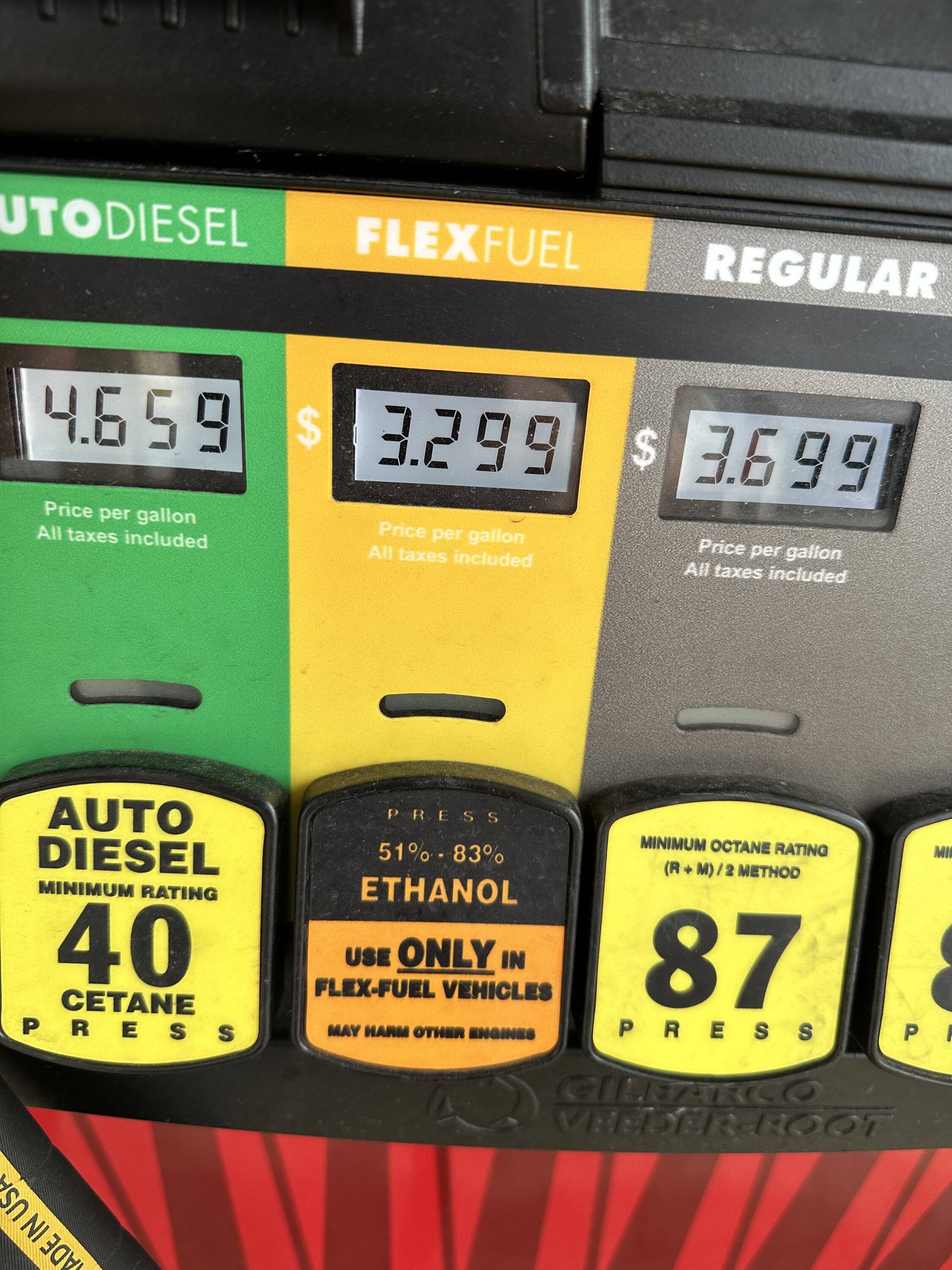

Long time diesel guy new to gassers, I’ve read what I could find on e85 an from what I’ve found 70% ethanol is the minimum you can run on an e85 designated tune, so there’s only one place near me that has what I think is e85 but not sure can someone tell me if this is e85 or something else it’s labeled at the pump as flex fuel

I wouldn't trust that pump until the summer blend starts to come around. We have 2 stations locally. One has that same label & the other one says minimum %70. Winter blend on that one is as it states. Minimum on the other one as well, seen %54 on that one most winters. Order yourself a Holley e85 tester. They're cheap & easy to use.

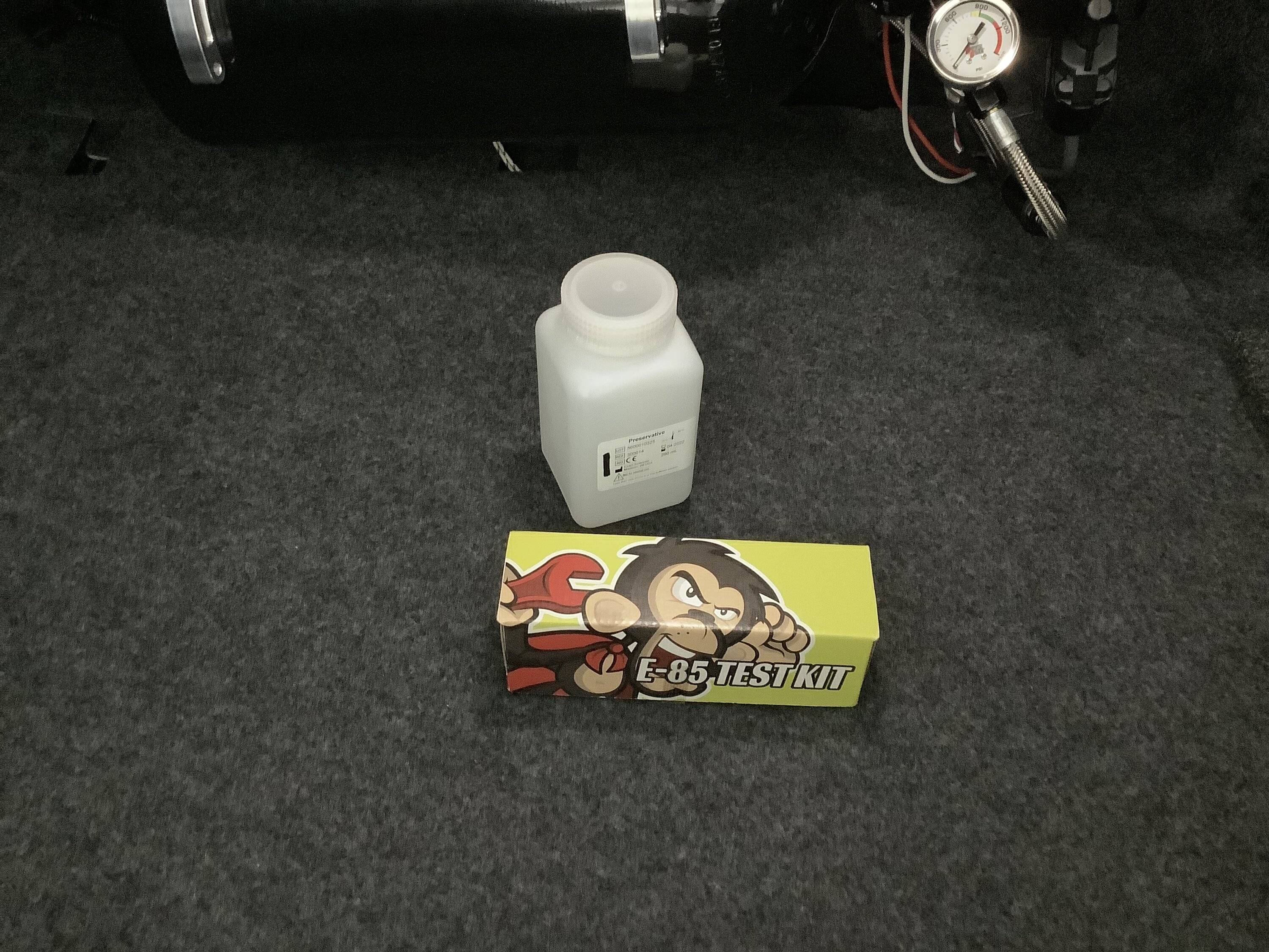

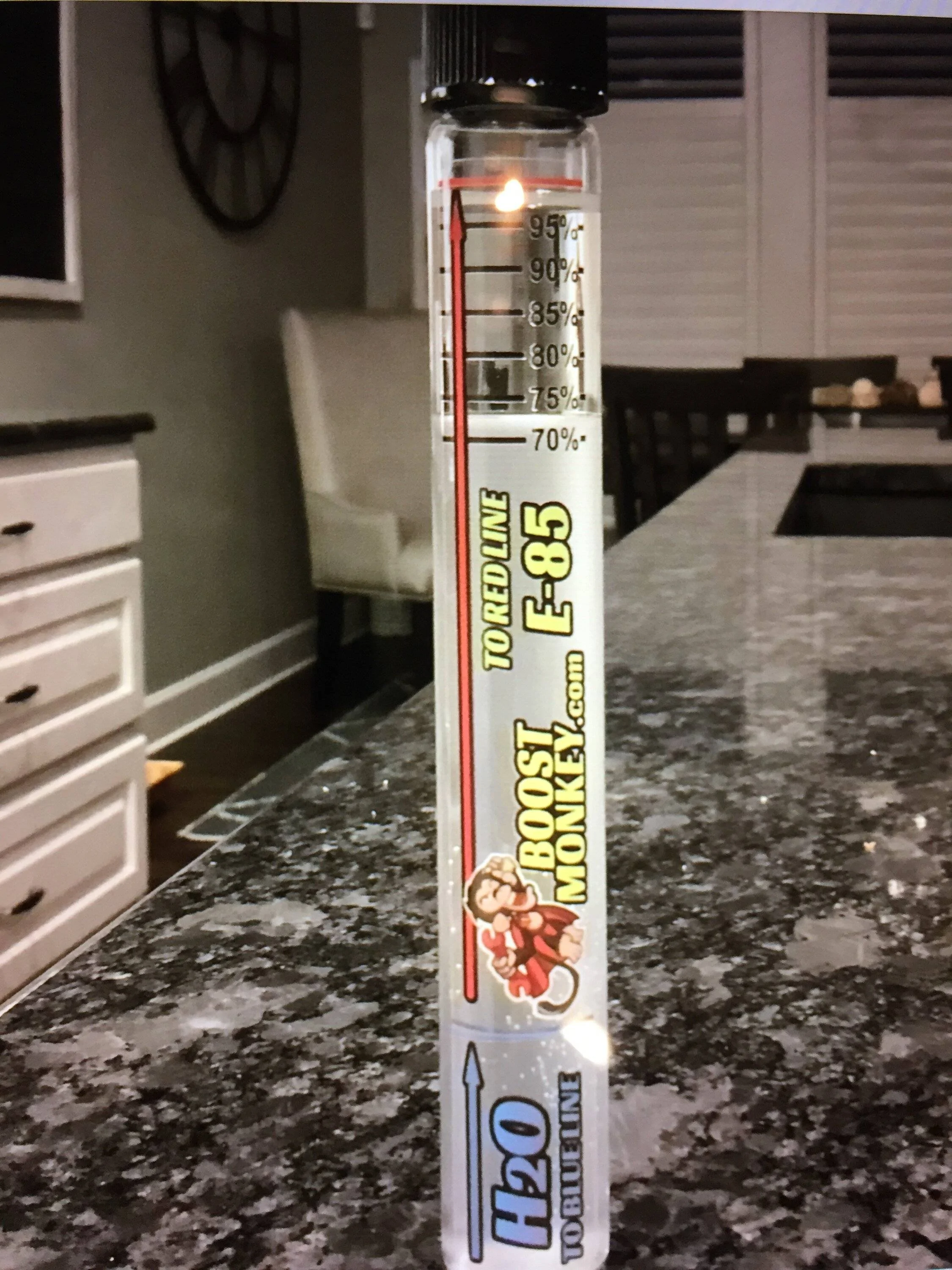

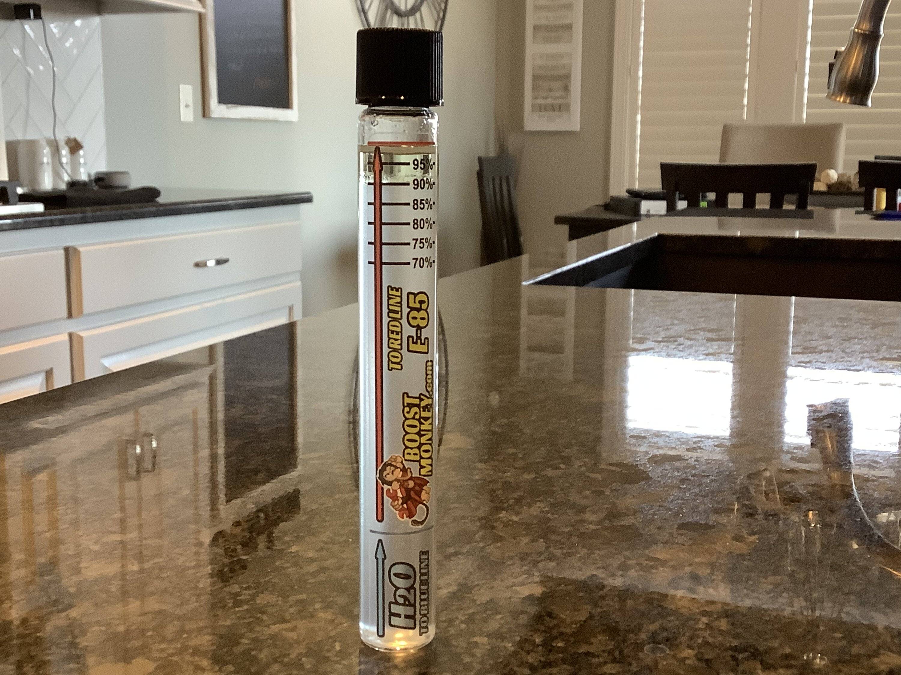

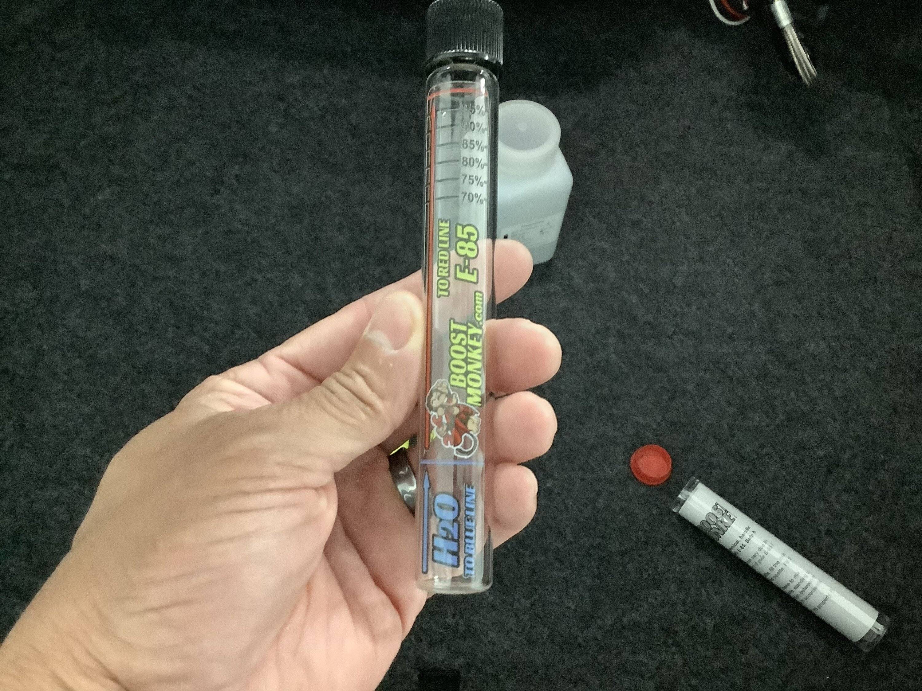

I’ve done it several times. I keep a spare container for pumping a very small amount of fuel into it. I then add water to the fill line, followed by the required amount of fuel, put the cap on shake it and let it settle for a few minutes to get the reading.
Get both (Flex tune and an E85 tune). By regulations, all pumps must say 51%-83% ethanol content. Winter blends usually have less ethanol content in them. I run my Flex tune the majority of the time, unless I intend to race the car, or I’m data logging for the tuner.

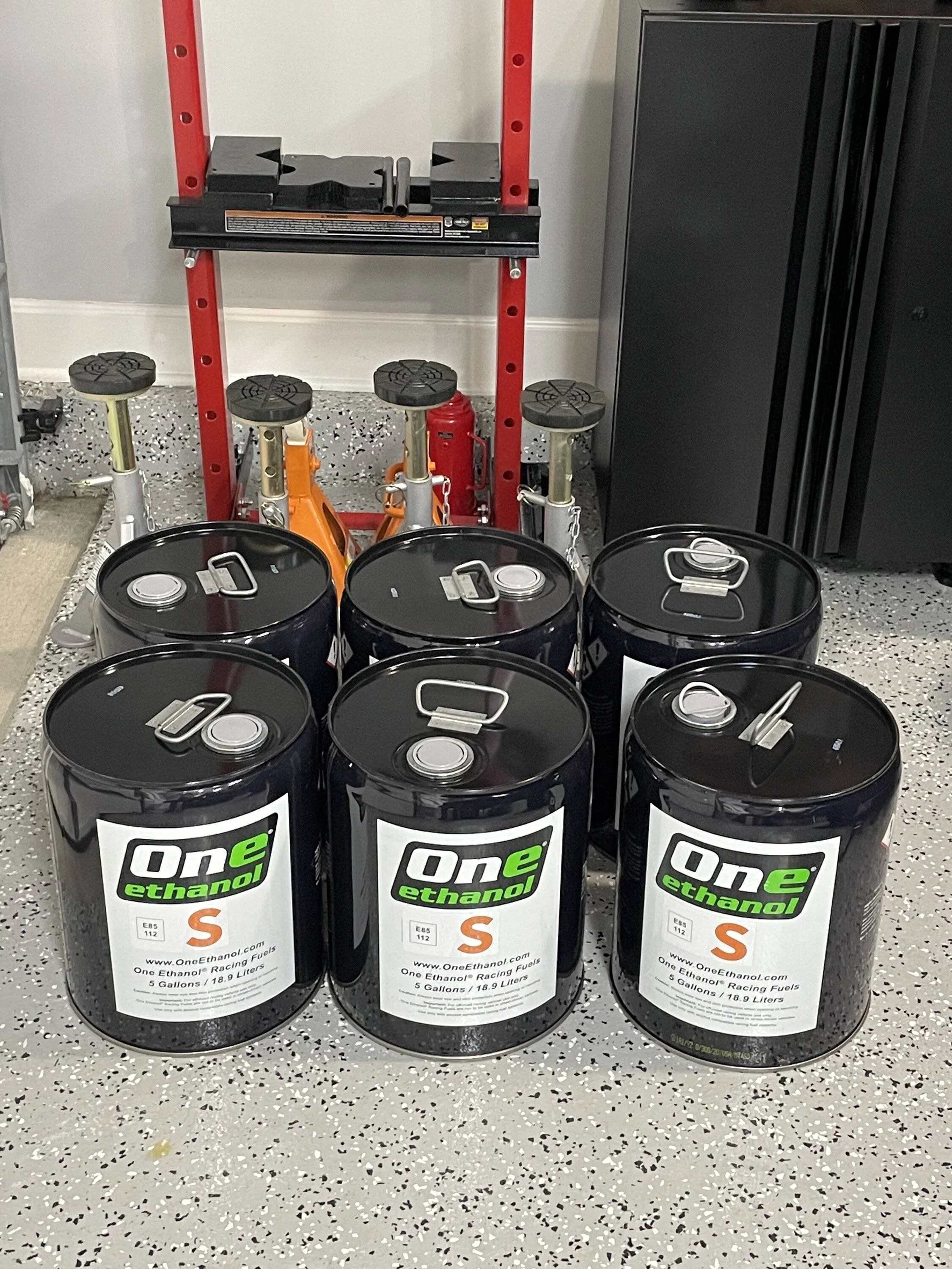

You can always buy some One Ethanol and tune with it. That’s what I did and it tested higher than 85% ethanol content (good stuff).
