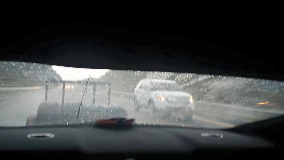

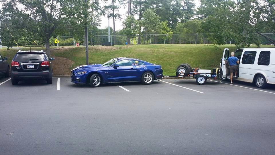

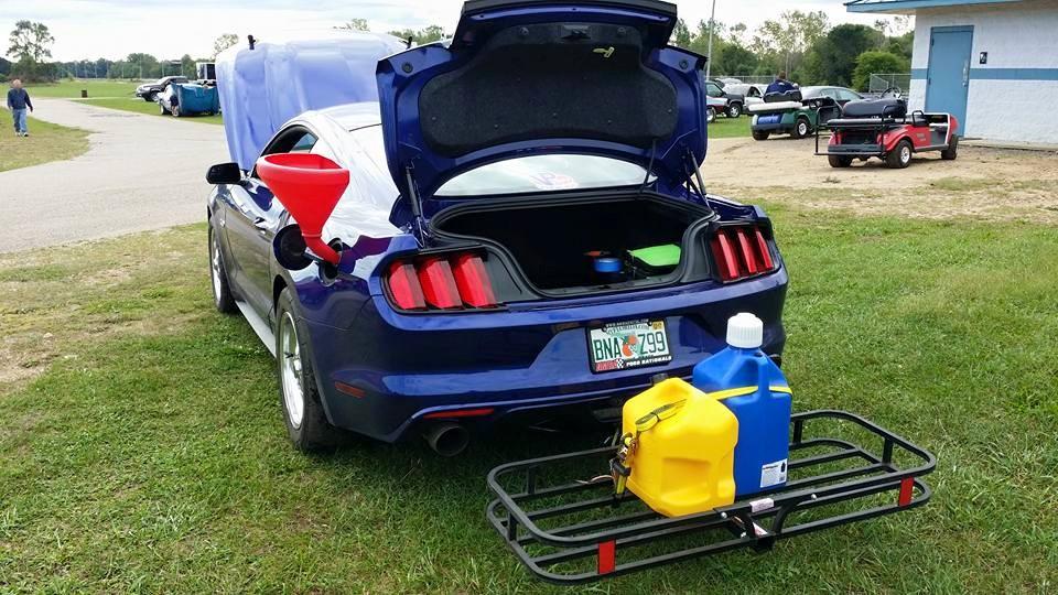

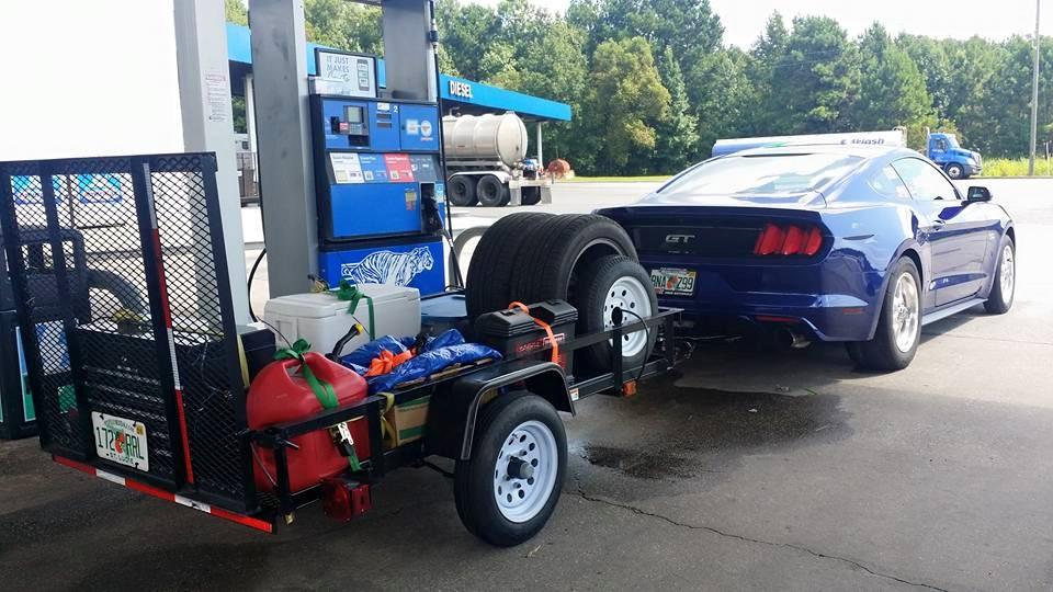

I do have more pics, but I've never figured out how to attach them in a pm. I've raced in 5 states at 6 different tracks from FL to Michigan. When I go to a local track I use the cargo carrier just for extra fuel. I race with less than a 1/4 tank to keep the weight down and ad a gallon or two at a time.

You are like Ringling Brothers but for for cars and going fast. Haha!
