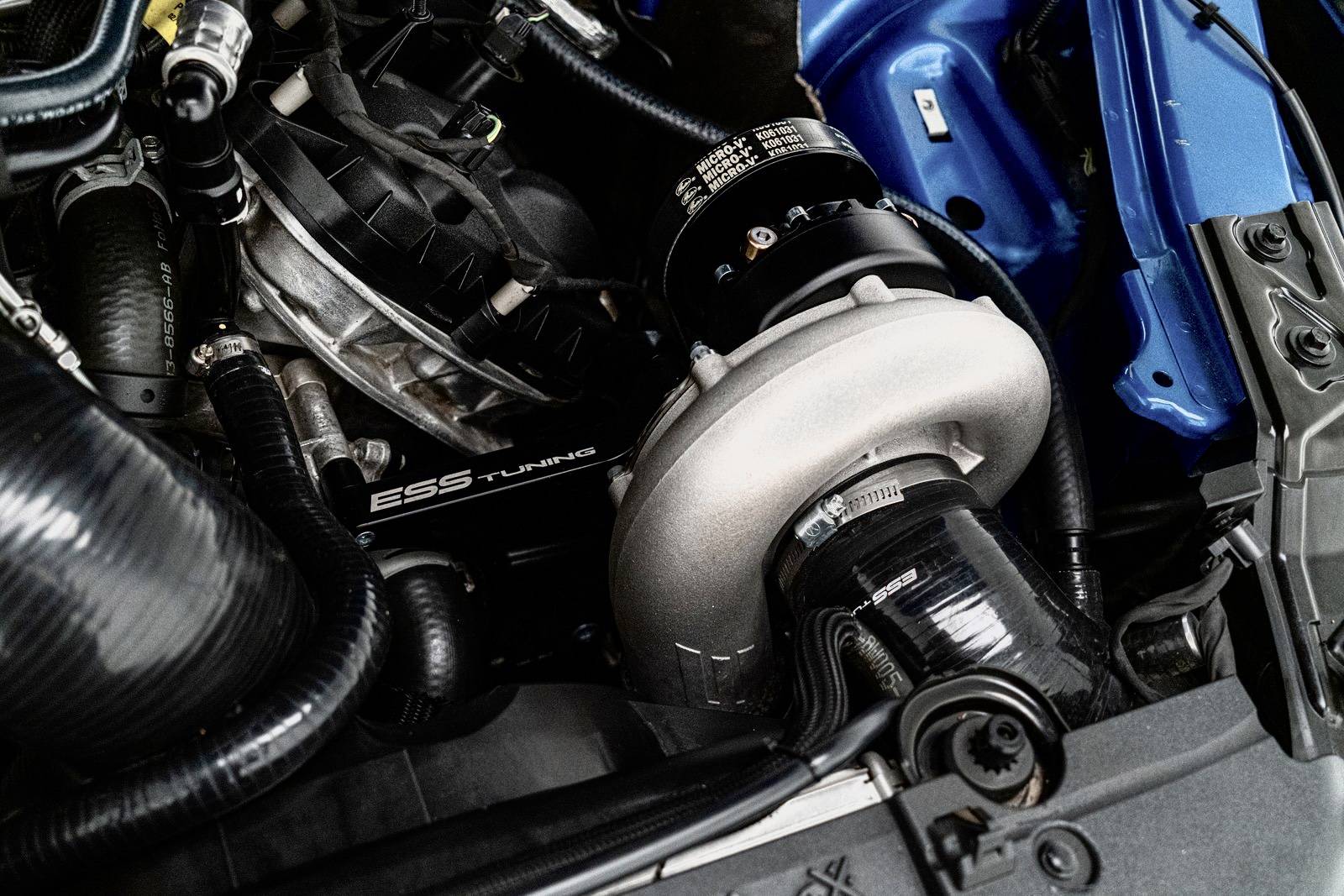

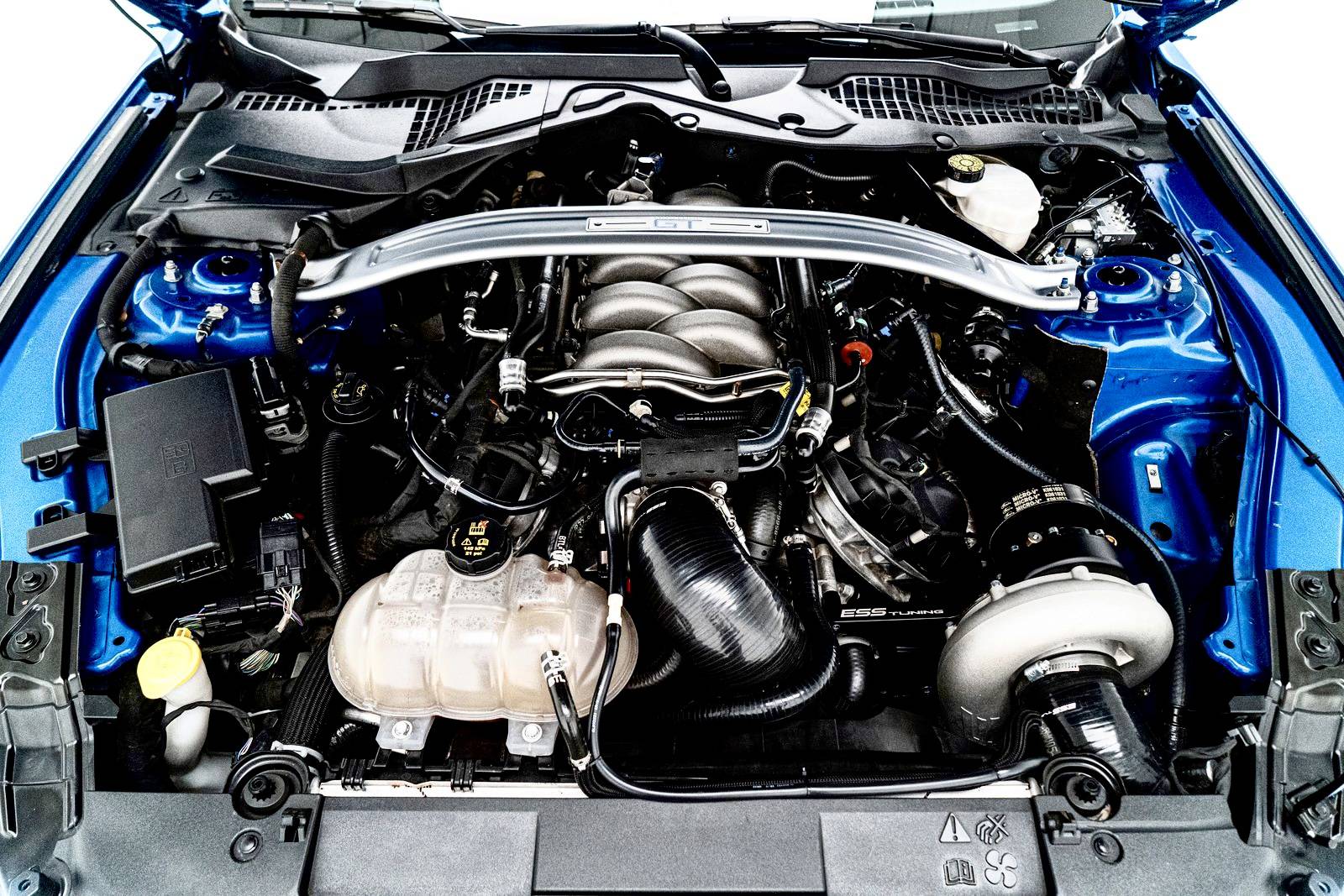

Hello everyone,
I will start off by saying I am fairly new to ford vehicles and lack higher knowledge when it comes to the coyotes and any fords for that matter. That being said I just purchased a 2019 Mustang GT A10 with quite a few mods and tuned on 93 by LUND. So my question is with the mods listed below, what all do u need in order to switch to e85, besides the tune of course. And the main question is : do I need a fuel return system in order to run e85.
MOD LIST:
Tune by LUND on 93
ESS Supercharger w/ 120 mm pulley
ESS Intake & Intercooler
Long Tube Headers
Steeda X-Pipe
ID1050x injectors
DW415 fuel pump

For any big name tuner yes you will need a return fuel system.

Lund will require a return system to run E85 boosted. They tend to suggest a FORE system but other brands will suffice.
Your current injectors are up to the task so that’s a good start.

Hello, Hasan! These are great questions, actually.
To run E85 in your car with a boosted application, I would say you're gonna need a full return style fuel system. Outside of the custom tune like you mentioned, of course. With that said, we here at Lethal Performance offer a full fuel system for your setup! Any S550 mustang with boost needs that system. Feel free to reach out if I can be of any further assistance and answer any questions you may have!

100% need a fuel system. Any tuner worth a damn will not touch it without one. You should hit up beefcake. He's been a great vendor and mustang parts supplier for years.

Hey Hasan!
For E85 on your application you will need a return style fuel system and the custom tune like you said. Over at lethal we have our own fuel system that I recommend to everyone and actually run myself! If you have questions on which system you need or options on the kit you have questions about let me know! I will throw a link in there to the fuel system so you can look it over and come up with any questions!

a level 1 fore system will do the trick
feel free to dm me with any questions
