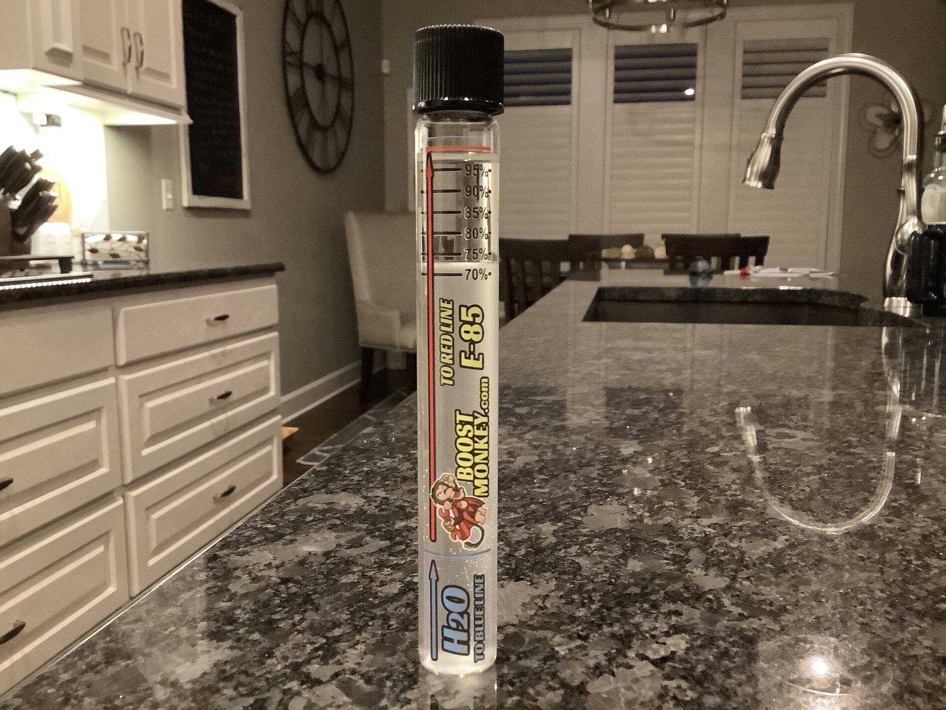

I wish all gas stations that sold E85 carried a fuel supply with high a ethanol content. So far, I have filled up at three different stations and had the following ethanol content 65.5%, 72.5% and 84.7%. Would like to stay at 80% or above, so that I can stay on the E85R tune and not have to switch back to the Flex. The R tune really wakes the motor up!
