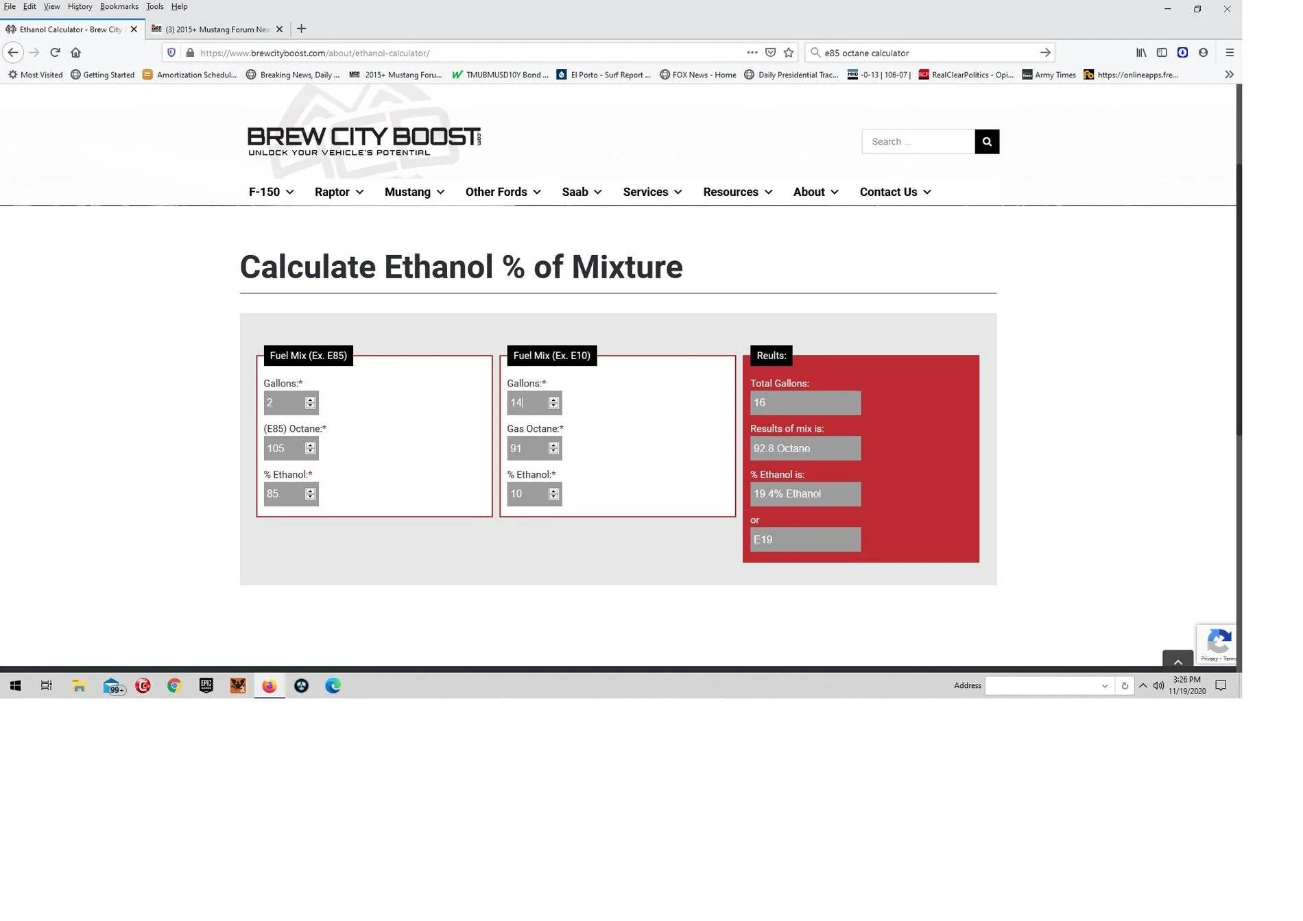

If you mix 2 gallons of race E85 and 14 gallons of 91. You get a E19.5 & a 1 point increase in octane. Now your fuel trims have to work extra hard & that 1 point will yield only a very marginal gain in power. and if you run that on a FLEX it's to little for the tune to notice. Either run 91/93/94 or straight E85.
Well thats the issue you can't get 93 or 94 octane in Cali. I also run 2 gallons of VP 101 Streetblaze with the 2 gallons of E85. My car runs like a scalded dog!! The car is rated for E15 so my E19 blend is having no issues. Also you are actually at 92.8 octane due to the fact we get the real mccoy when it comes to E85, we have to as it will be taxed like regular gasoline if it falls below E85, in fact most stations that sell E85 test out to E87.

so the e85 is purely for an extra ~1 point boost just to be safe I assume?
It gives me almost 2 points if you see my chart above. The VP101 gets me almost to 94 with the E85. Also the extra ethanol does cool down the fuel charge more, maybe just a tad but its not just for octane.
