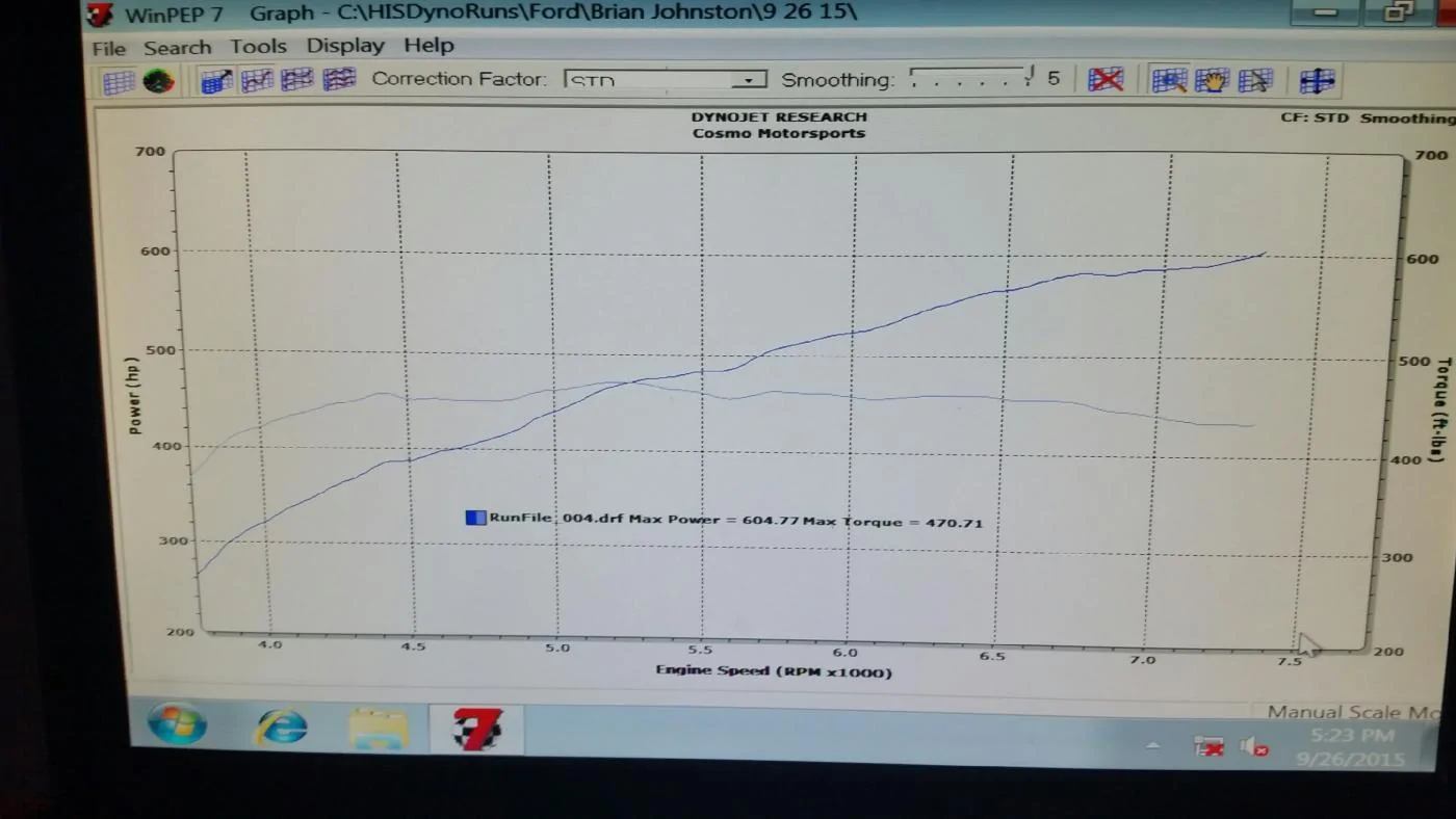

How can it be we make the same HP ( 604 ) but I make 561 TQ ? .. My HP also flat lines @ 7k .. Seems very strange to me...Here was my 2015 GTPP car with D1 HO kit. Same as on my Auto car.
It had stock manifold. It had a different calibration file than the OP's car. You can see the stock manifold is capable of holding power till 7500 RPM. The GT350 manifold is not needed, but can solve the problem if you have the $1100 for it. The two dyno charts look different. I was running 8 psi of boost.

On this last tune we did try some cam timing changes but didn't pick up anything , so it's at stock cam timing now .. We did take it to 7400 on the dyno pulls but HP flat lines at 7k.. As in flat I mean it didn't drop any HP or gain any , it just stayed at 604 from 7000 to 7400You run more boost. You have an Auto and have very good low rpm cam tuning. My old 2015 manual gtpp car was remote tuned by Lund. Yours was tuned in person on the dyno. I think those are the biggest differences. I only peaked out about 8 psi. This car didnt flatline either. Extrapolate your graph out to 7300 rpm at the same slope and you would make 20 to 30 hp more.
