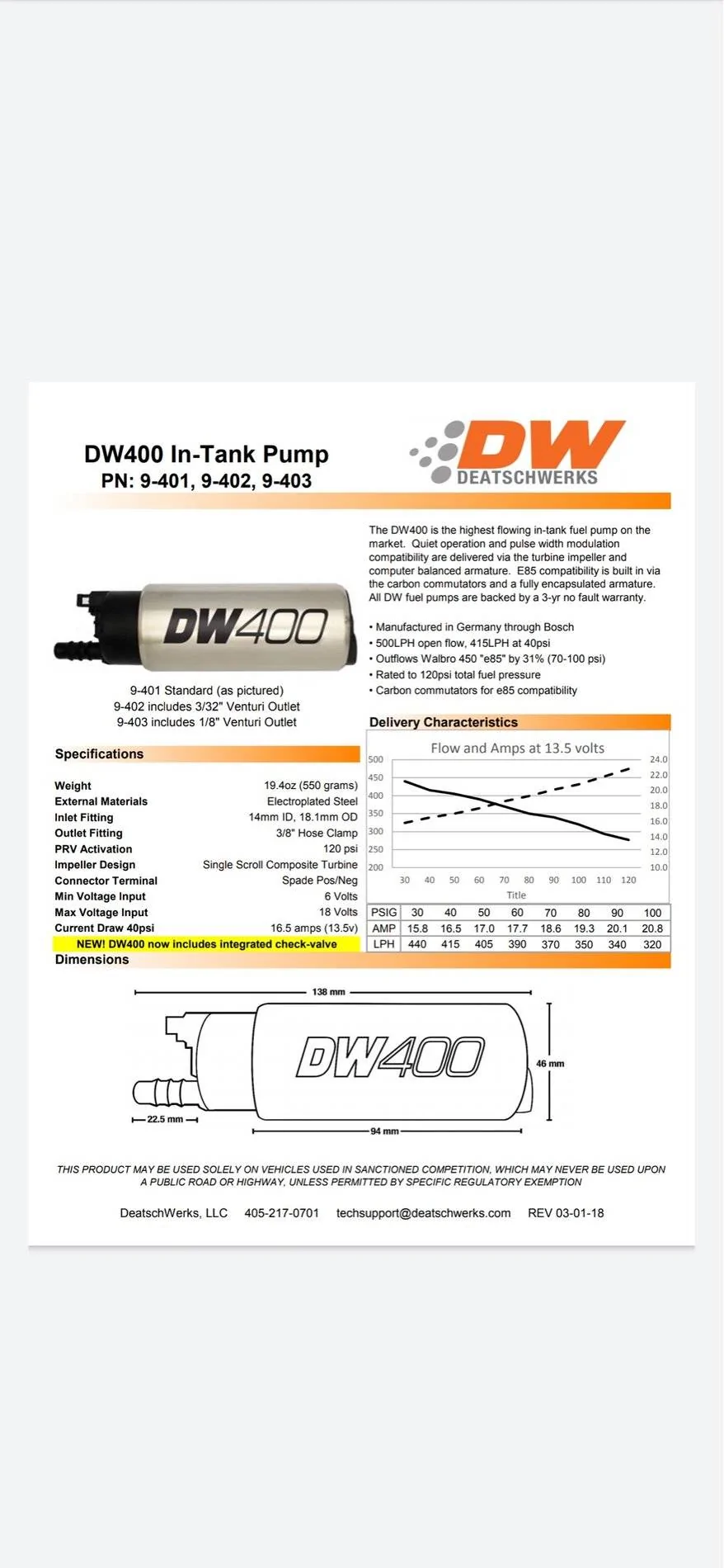

Talked to DW yesterday, their new pumps have them, even says it on the paper work in the box.
Well I'd double check it then. Could be a older pump in a newer box.

Hard to tell, this is the second pump in a week, hard to believe I’d get sent 2 pumps back to back that never got that check valve installed, but they are being sent
Back to DW so they can check them over. Then again I bought these 2 from dnahyperformance.com. The 3rd is being sent to me directly from DW, so we will see Tuesday if the 3rd one is the lucky one.

So far everything I read requires the inline check valve ? Couldn't find anything on the DW website that says it's included. I did just buy their DW400 pump & instal kit though, along with the check valve. Price was right, so why not.
Right there highlighted says integrated,
So that’s interesting you didn’t see anything

So it does.. hmmm. The kit I got was 9-403-1047.
