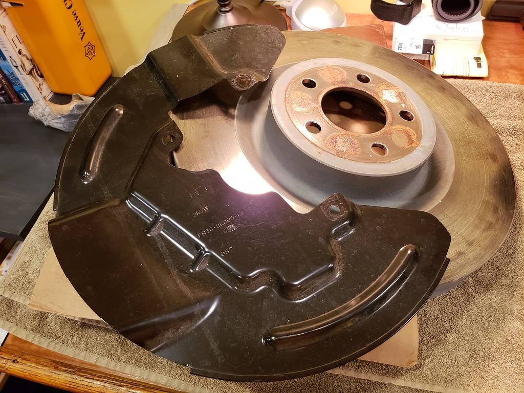

15-17 have the little petal style shields as seen below.
The 18+ have full shields with a small duct for brake.cooling.
15-17
18+
20181105_170720 by chefjpd, on Flickr

I see yeah that is a noticeable difference. Thanks for the pictures.
I still don't understand why only the left dust shield on the 18+ are pretty much out of stock across the country.

Those larger shields I showed were from a 2018 PP1. bought them from an M6G member. there are no sub models that have Brembos.

still trying to figure out in which model year Ford replaced the dust shields on PP cars with the bigger ones. Some people have the smaller ones on MY18. Anyways the dust shields have been on national backorder since early March. I posted in the FB page and lucked out finding a set from another, though i paid a premium for them. Another guy who did the swap is still using his 14" dust shield and said they're working fine
The older ones have a gap in between right where the air reflector on the control arm is located. I don't see that on the newer one.

You ultimately want the smaller ones. You only need the "shield" portion next to the ball joints to protect against heat fatigue. Otherwise you want it as open as possible to get more air to the back of the rotors for cooling.
But like OP said, if you don't track or hard brake ever, they really aren't needed.
