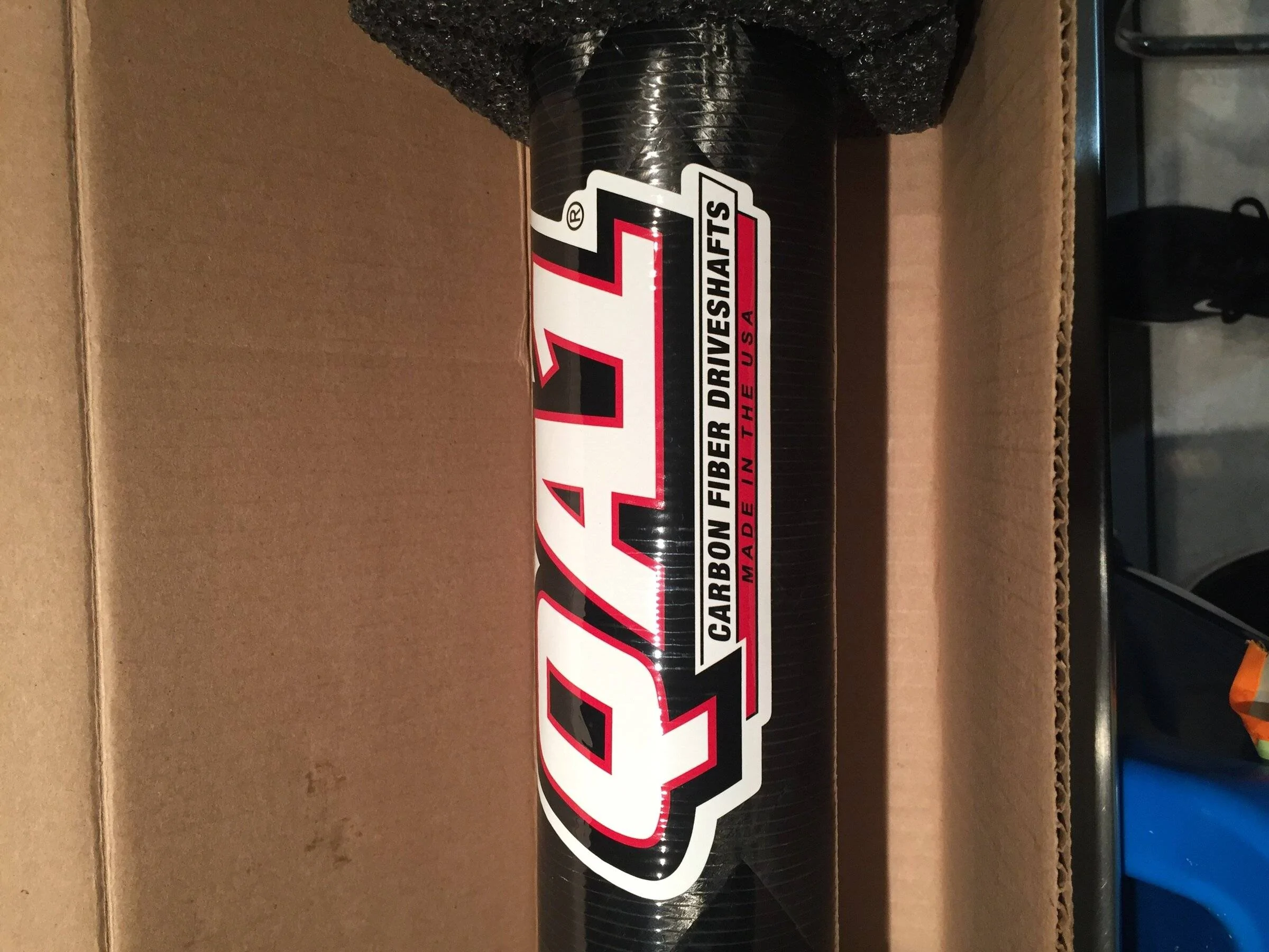

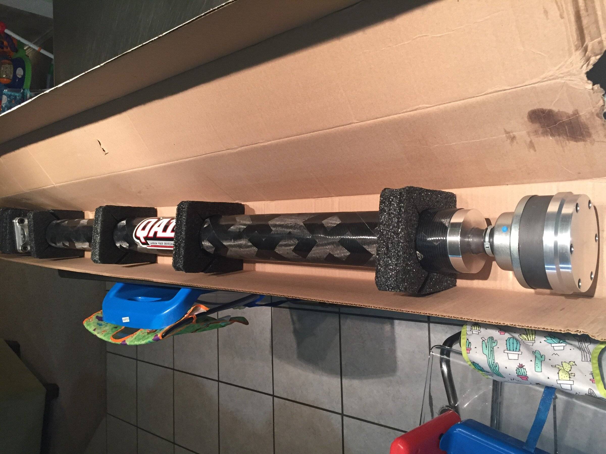

I decided to keep this thread very short and to the point…
PSA- Do yourself a favor; save your money and get the QA1.
*Edit*
Sorry guys...got in a hurry. Reply added below and here for your convenience...
Fitment - the DSS being one piece (no adaptor like the QA1) seems nice, but makes installation challenging. You gotta get the universal up past the tranny shaft so that you can get the adaptor into the pinion on the axle end. Not impossible, but you gotta find just the right spot or it won't go. The QA1 slides right in. Put the adaptor in the pinion and the shaft just goes right up in there. (Removing the DSS for this reason was a PITA)
Hardware - QA1 comes with everything nicely labeled and marked. New, complete hardware for both ends. Great instructions, torque specs, the whole bit. The DSS not so much. Came with no instructions, no specs, and an incomplete bag of (nice) bolts only for the pinion end.
Performance - I never really expected much of a difference in driving, much less a night and day difference...but night and day was what I got. Much smoother almost everywhere. I didn't really consider my DSS to "vibrate", per se. I wrote it off as feedback from the carbon, and single piece shaft. I was wrong. Don't get me wrong, my DSS didn't feedback to the point it was annoying or seemed like a problem (I could see out my mirrors, LOL), but still...wow. Smooth as glass now, everywhere.
That smoothness amplifies the perceived performance increases of the carbon shaft in the first place. I've tried to differentiate between the placebo of the two brands and not overstate that there is actually a performance difference between the two, but that change/increase in smoothness sure does play into it.
Why did I change in the first place? Got a descent deal on a QA1 from Weir Racing. I had always wanted the QA1, but Lethal had a black Friday sale that was tooooo good to pass up at the time. Lesson learned.
I will say this...on the workbench, the DSS is just as pretty. The carbon, the end joints, everything seems to be every bit on par with the QA1. No nod either direction in appearance or 'perceived' quality.

Okaayyy fiinneee...LOL ;) That's fair! Here we go...

I’m left a bit confused after reading the first paragraph of your write up. You say the DSS has no adapter like the QA1 but then you say.
“You gotta get the universal up past the tranny shaft so that you can get the adaptor into the pinion on the axle end.”
Can you clarify please? Thx

Aahhh, sorry. The DSS has the flange that mates directly to the pinion cup on the axle. But that cup is just that, recessed. So it makes it a challenge to get the flange over and down in the pinion mount. The QA1 has an adaptor about 1.5" thick that mounts in that pinion mount. Then the flange on the shaft connects to that. It just slides right up in place.
