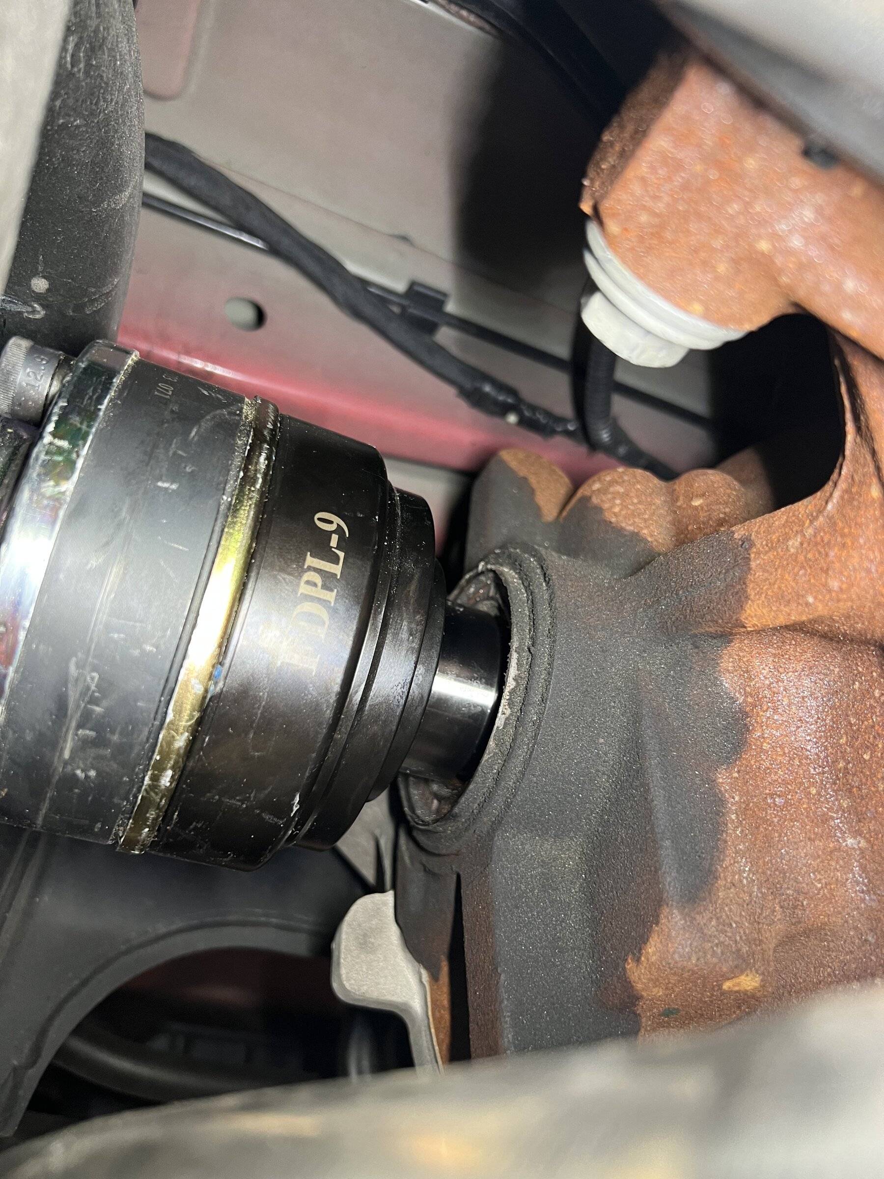

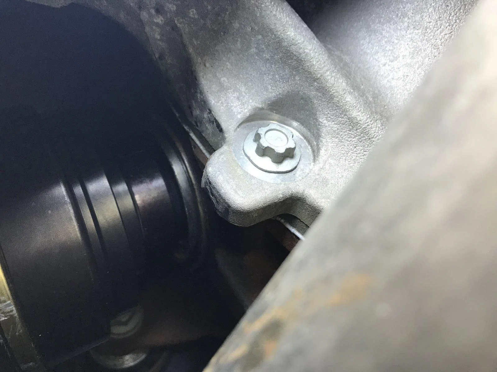

I know this is an old thread but what was the fix? Had the same issue on my passenger side yesterday. It is bigger by 0.01MM than stock.

Hopefully I do t run into this installing my 2k dss shafts. But I’d say you need to replace that seal first. Looks like she been leaking for a bit
It’s old and discolored. Probably excess fluid from factory

There's the clip that has to get by. Give it a couple good shoves and it'll go.
Yeah we tried that lol. Compared to the driver side it’s not normal. Driver side clicked right in. We measured the shaft and it was .1MM thicker than stock. That’s not the case on the driver side one
Ya there's tons of room in there. Try harder.
Unless you have the shafts on the wrong side.. then don't try so hard.
