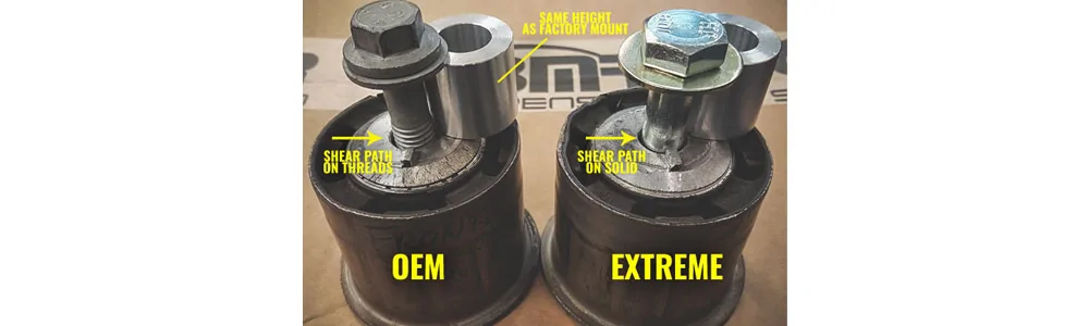

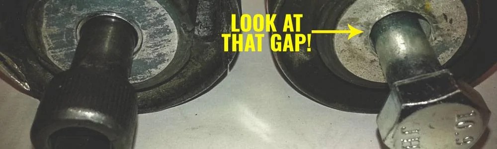

You shouldn't need to replace the pinion seal if you're just replacing the rear cover. Is there a reason you need to?
I would get this:
https://www.lethalperformance.com/lethal-performance-s550-extreme-diff-bolt-upgrade-kit.html
And use the sleeves from that kit in the rear diff bushings. They take up the ~3 mm oversize between the bushing and the bolt, improving bolt durability and bushing life. You could also install the whole kit and through-bolt the front ears for durability.

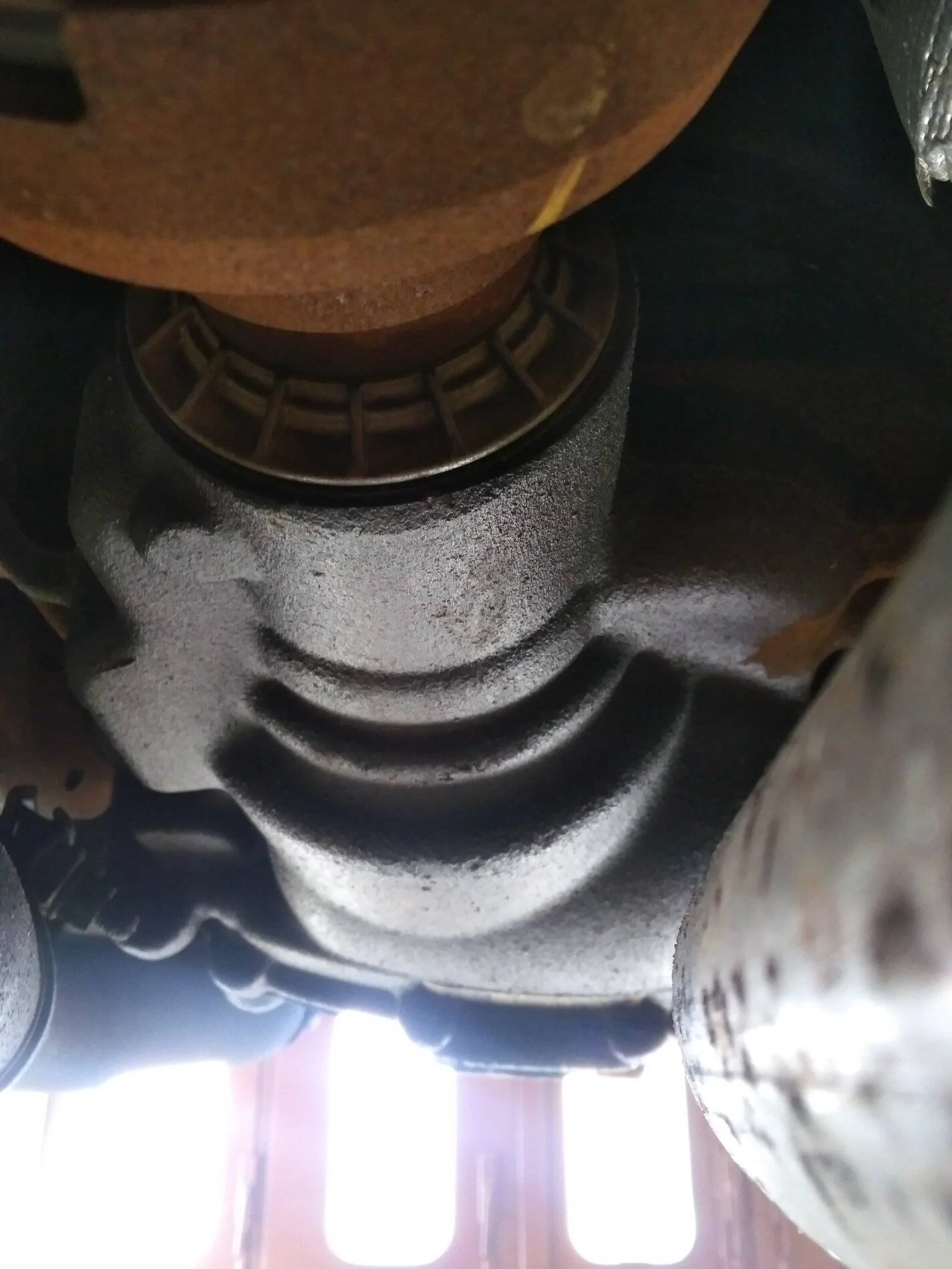

Pinion is leaking
@Brian@BMVK Are there seals for the half shafts where they go in the pumpkin?

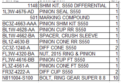

Figured that. You wouldn't happen to have the stock numbers?
This may be worth you keeping on record if you are messing around with your diff :
If it helps, here is the parts list for the diff rebuild kit (supplied to me by ford performance) :
