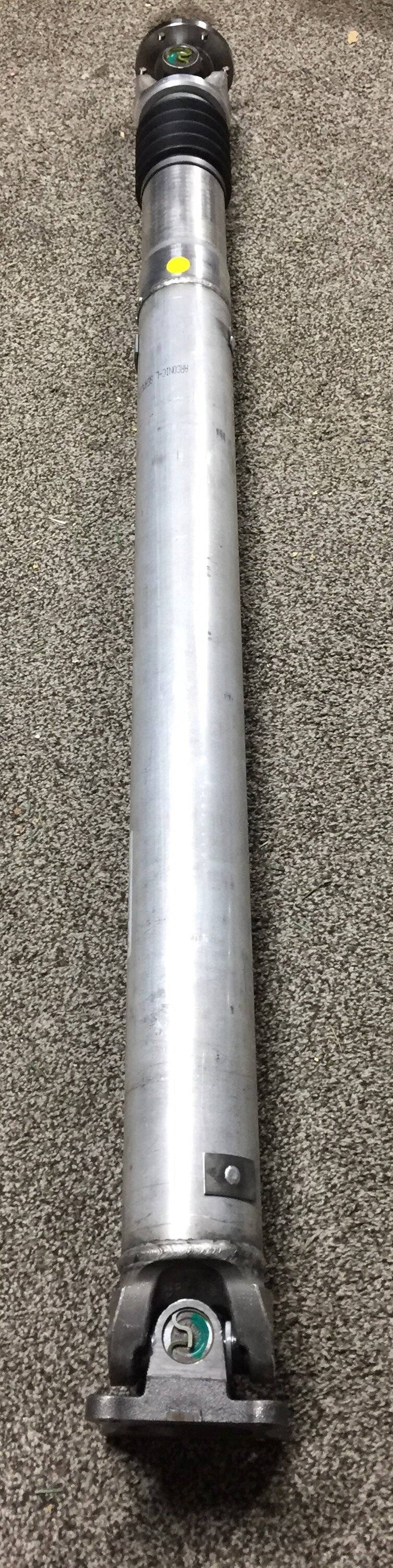

Been hearing bad things about the brand dss drive shafts. Was looking at a steeda or dynotech one but people are saying there's noises/vibrations when they install a one piece drive shaft is it only from dss or is that all brands?

I can only say my Steeda aluminum one piece is doing just fine. No NVH

Steeds shaft on mine. I can see how some experience NVH with it if not careful on the install. I had to work out some issues with mine, but thankfully I was able to catch them during install and fix them. Car has been super smooth since the install. Read about it here (start at post #64). Great ds and no regrets with this purchase.

I've had both, DSS and Steeda (< still have). And yes, the DSS adds a ton of NVH; the difference is that the Steeda is foam filled. FWIW, for a daily driver, Steeda all the way.

Had two Gforce alum driveshafts. First one bad, second one good. Had 1 qa1 carbon, good. Currently have DSS carbon, good. Car traps 173, smooth as glass.

Steeda did send out updated hardware, but before they did that, I went to Fastenal and bought my own hardware and modified my factory shims. The updated hardware that Steeda sends does not use the factory shims. I just wanted to retain them because it made sense to me to have them on there.

Ty all for the information I'll go with steeda

I have the DSS one piece aluminum on my 800whp Vortech car, no issues it's been great. Didn't really feel much NVH when we first installed it.
