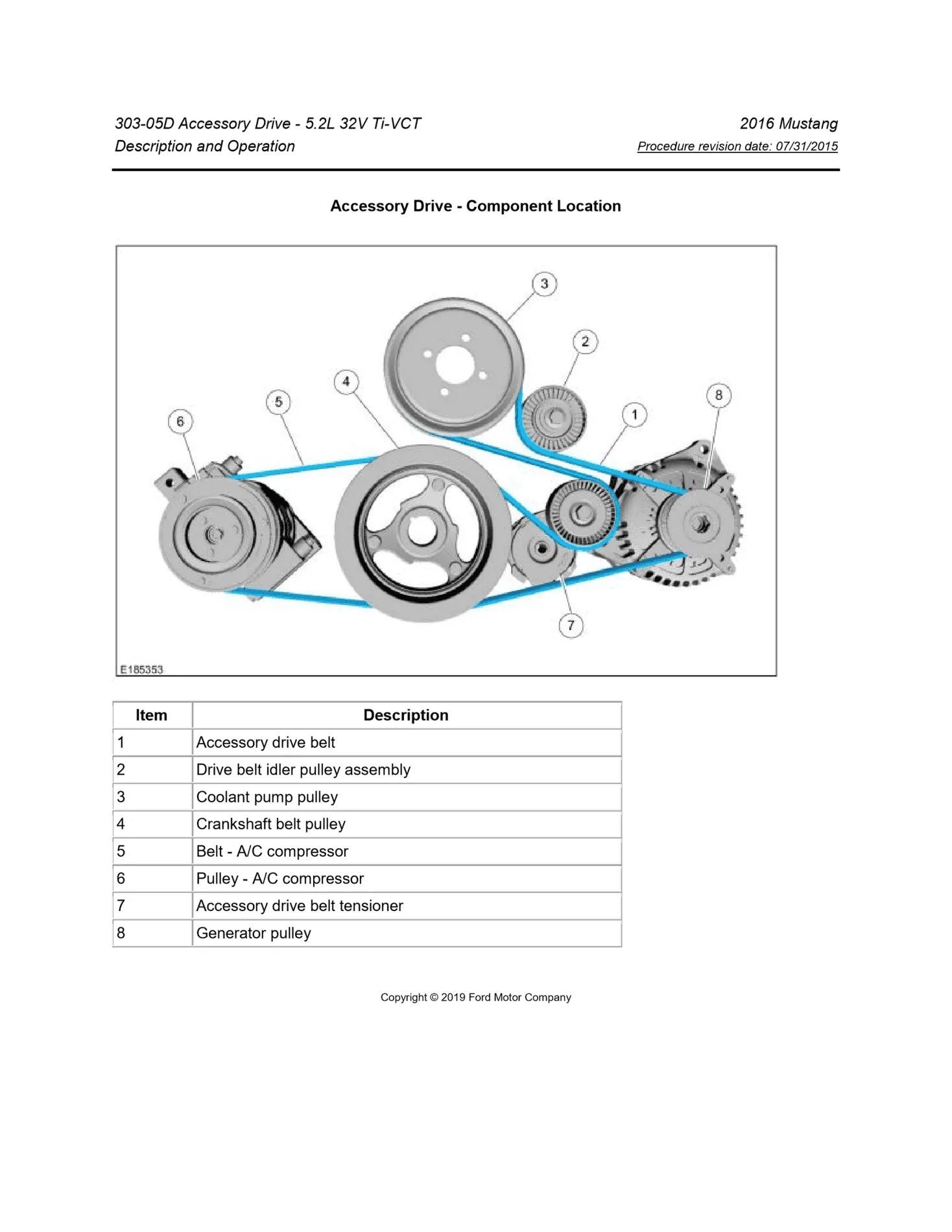

Hello All,
Does anybody have a step by step procedure on replacing the ac belt and serpentine belt. I have 100k miles on my 2015 Mustang gt and the belts has never been replaced.
Thank you in advance

Check on YouTube, try to source a master service book from Ford.

This thread may help only with visual of front FEAD system of a Coyote on a stand with bels installed:
https://www.mustang6g.com/forums/th...c-belt-fell-off-during-track-days-wtf.126202/
This thread has the info from the Ford shop manual for how to replace the A/C belt:
https://www.mustang6g.com/forums/th...tentially-a-c-compressor.129712/#post-2686995

I dont know if you still need it but yeah. This is for a 5.2 voodoo but they are basically the same belt wise. The ac belt is an absolute pain, but with enough muscle you'll get it around the compressor. Edit- there is not really a procedure just do it like a normal belt install, wrap it around all key locations and put a socket on the tensioner to release pressure and as far as the compressor belt you just need to man handle it on there
You can also replace the stretch/cut factory belt with the traditional belt and tensioner set that Ford sells.

Thanks everybody. I used zip ties on the pulley and man muscled it on turning the pulley with a ratchet. The serpentine belt was easy.
