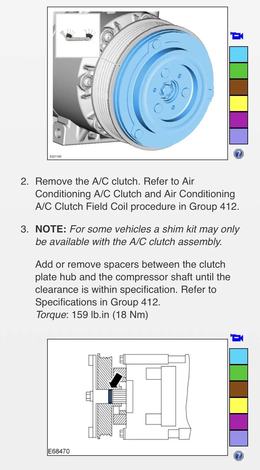

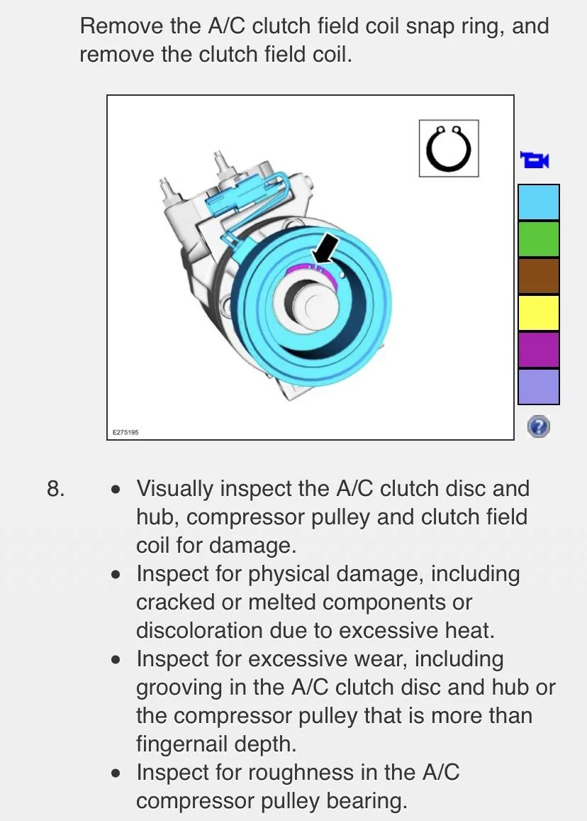

Cobra Jet
Feb 12, 2015
771
17,605
20,056

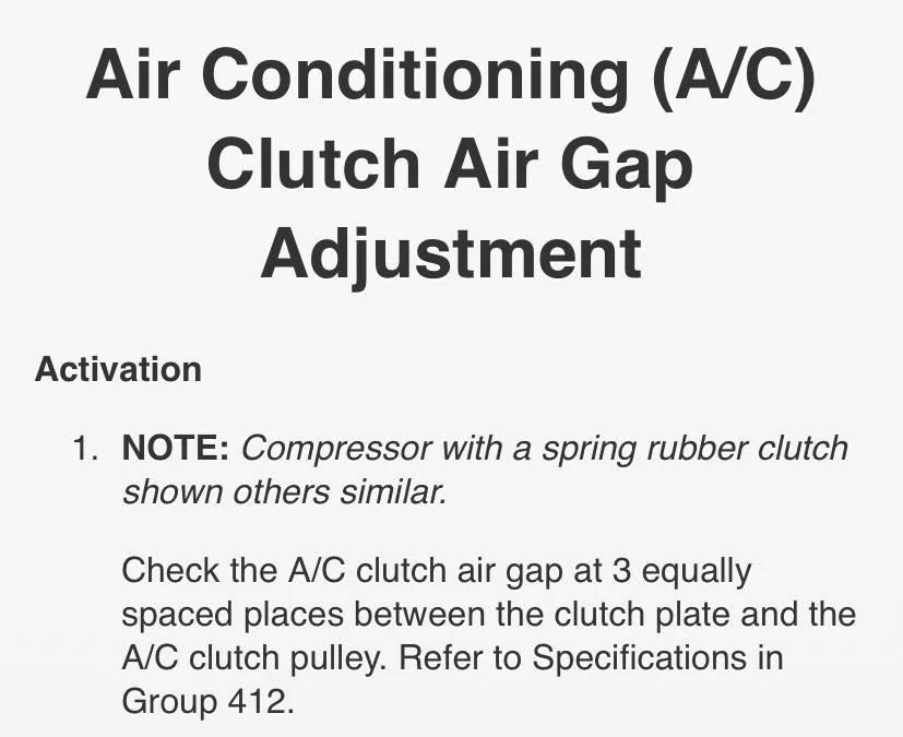

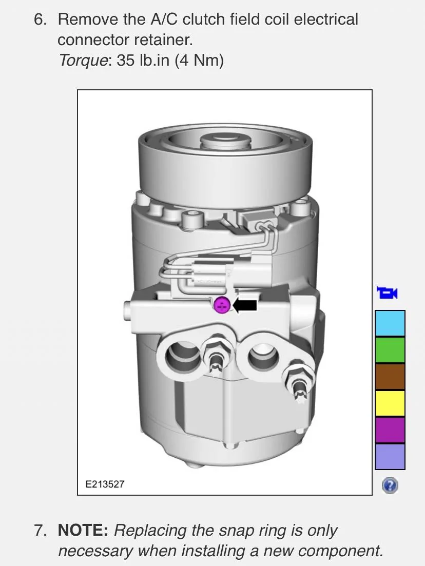

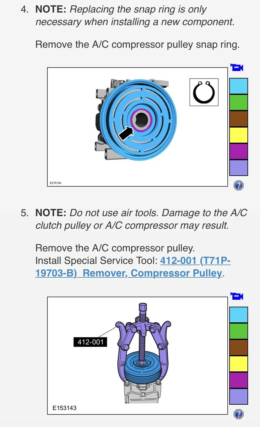

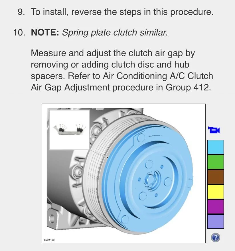

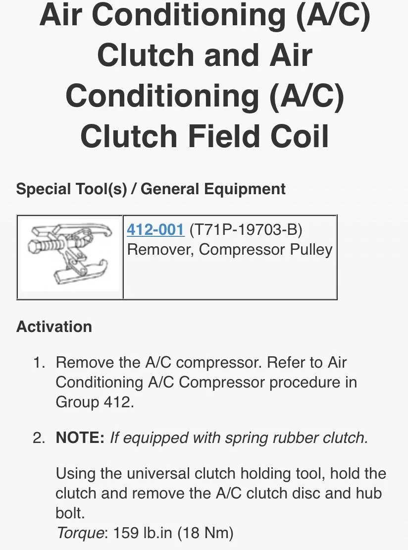

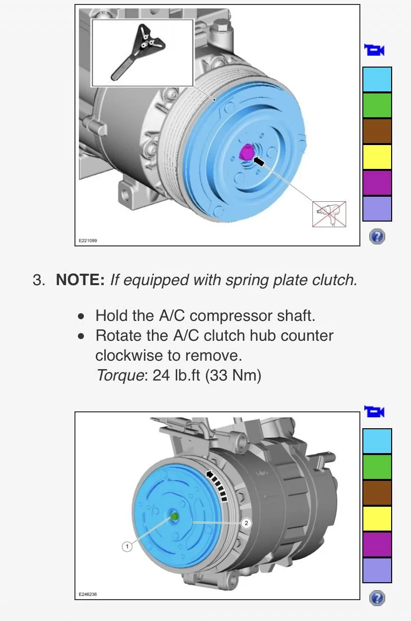

Here’s the info on how to replace just the A/C clutch (for those that need it for future reference):
