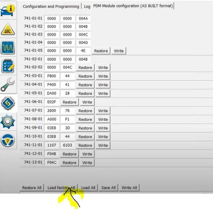

Since you said you're familiar with FORScan, can you reset to factory "As Built"?
You may lose your current custom settings if you have any.
Example (needs internet connection):

I have tried using that button in the past but it can never connect to the server for whatever reason. However, using Ford's site I do have the as built for my car. I can definitely load it back into the car but then I'm left with the same issue. I cannot find the correct changes to make for the 2018+ cars. All of the posts on here show the changes for the 2015-17 and my ABS/IPC stock values are always different than theirs. Someone on here with a 2019 made the same changes I did and it worked for him, but I don't know if he used some sort of witchcraft on it lol.
