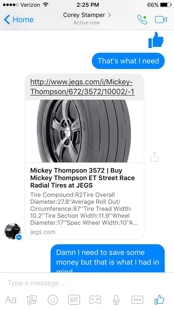

So it looks like Mickey Thompson ET Street R 305/45/17 and the sportsman ss front 28/6/17. Just FYI the speed rating of H on those front tires is actually higher than the rating on the drag front runners which we see go 260mph in the quarter on the fastest cars out there. So they are good to go for anything I will be throwing at it.
