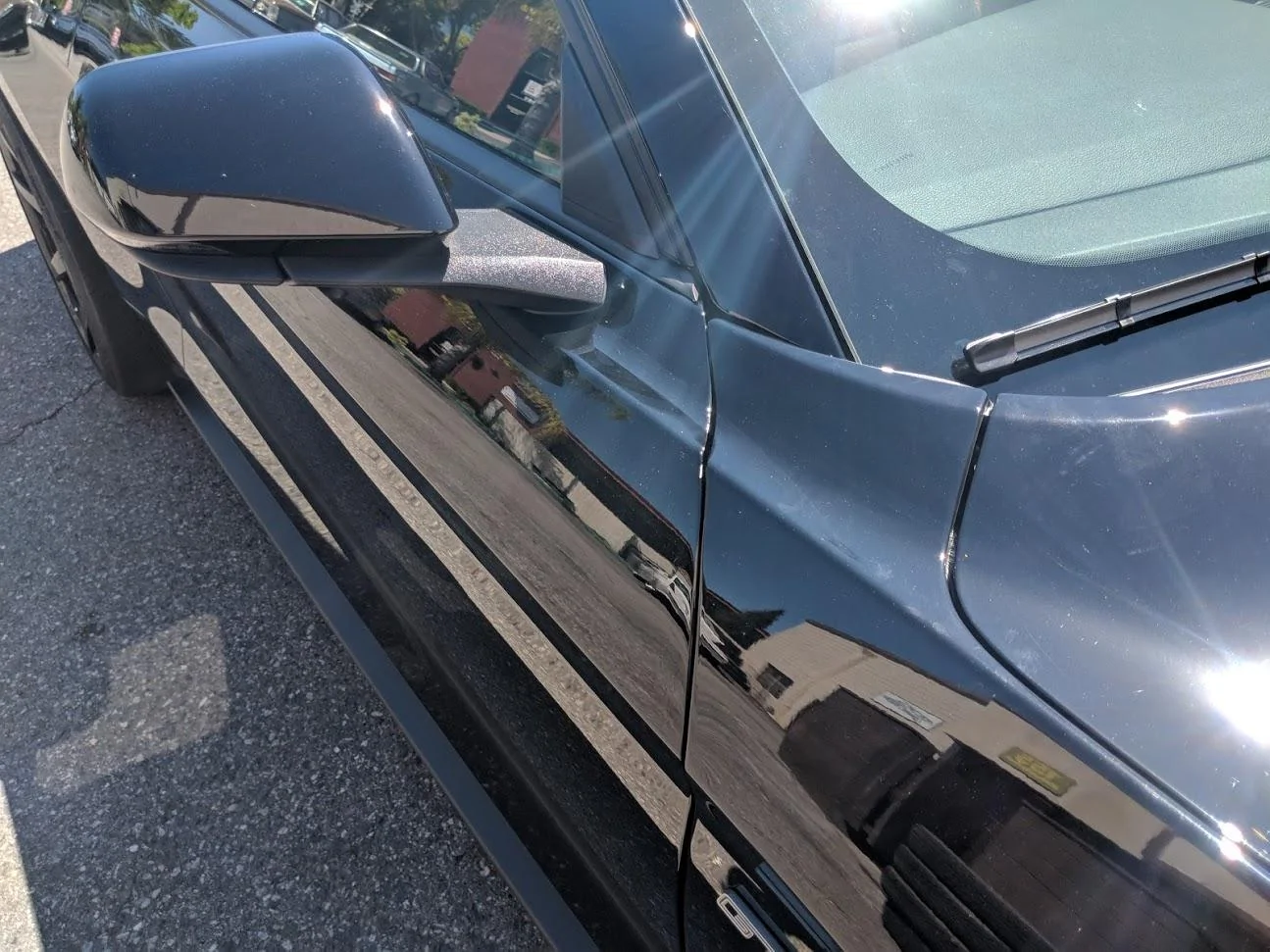

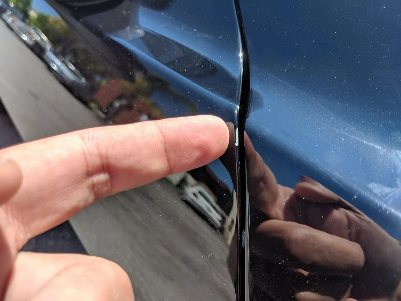

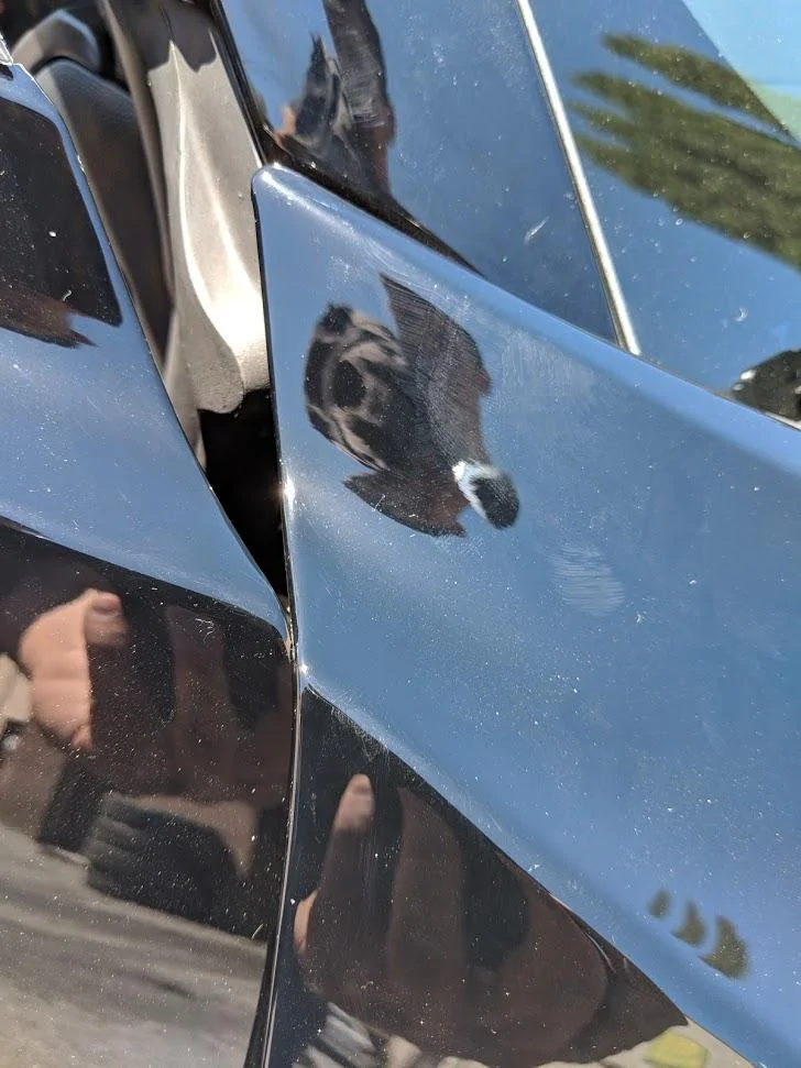

Not sure if this has happened to any of you guys. Nothing different about today other than it's full sun and hotter.
I went to open passenger door and this fwd edge took the paint right off. :mad:

Any chance someone backed into your bumper while it was parked? That might explain the fender being set back a little. Otherwise, that is pretty unusual.

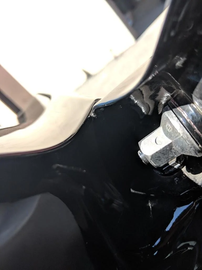

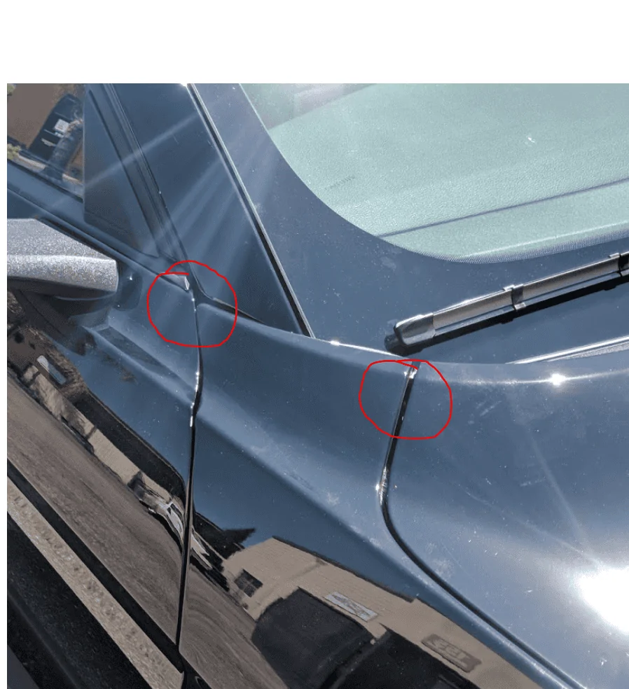

Don't have pix post adjustments, but it was not easy to get clearance without mis-aligning some of the "lines". I managed to get about 1.5mm of clearance after adjusting it.
There are 3 10mm nuts on the flat side of the fender under the hood. Then there are 2 8mm nuts in the areas I highlighted in the picture. This was enough to give me some wiggle room to adjust (There are additional bolts on the lower part of the fender but did not need to loosen). Make sure you bring the hood down slowly and correct the hood gap before final tightening.
