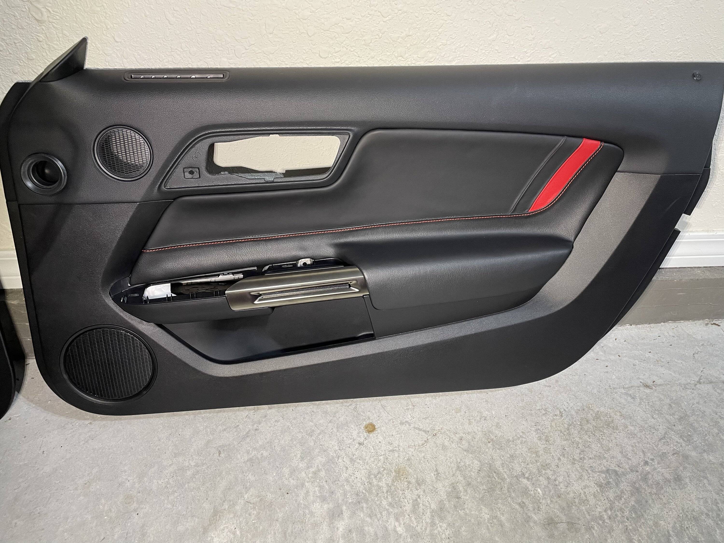

Door panels are all interchangeable unless you have a 3-way speaker setup in your doors you obviously don’t want to install a door panel that only has the woofer grill.
I took my panels to a local uphosltery shop and had them replace the leather panels. Katzkin also makes them.
Exactly ^^^
Aside from the speaker grille cutouts, be aware that some door cards are not "soft touch" on the top portion. These would be older door cards or those that were not in Premium models.
So in looking at the pic supplied by @Evolvd, where you see the "line" or "split" if following the top of the card down to the door latch/pull, that entire top piece can be soft (padded) or completely molded hard plastic based on year/make/model/option package. You can't tell this from a picture; you have to either ask the seller to confirm material or be able to physically touch the top of the card in person.
