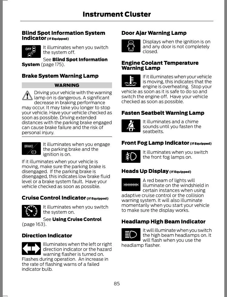

On page 85 of your 2018 US Owners Manual; yes all S550’s have a coolant temp warning light, (see right side of attached page).
It will normally illuminate near the coolant temp gauge.

Thanks, but I was wondering if there was any kind of warning for low coolant level (regardless of temperature). As far as I can tell there isn't.

Revisiting...
So I can see how there might be some confusion, as I saw another thread regarding the coolant temp icon. In my 2018, the coolant temp “icon” is permanent on the anaolog dash cluster and illuminates the color of the dash gauges. It’s presence is always there (strange).
I’m assuming that IF the coolant level gets low enough where engine/head temps get to an abnormal level, this same icon must illuminate another color to warn the driver???
