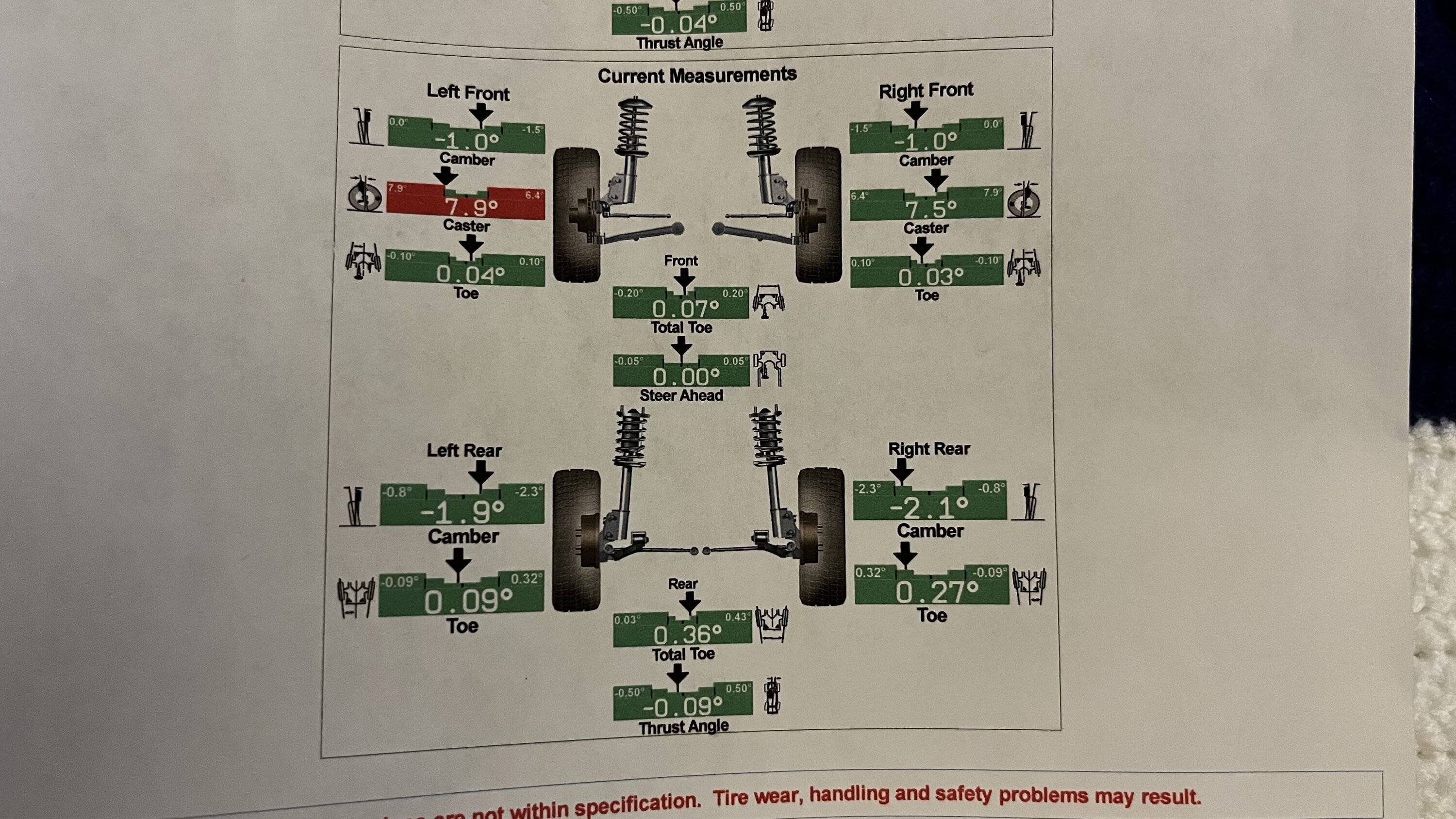

Somewhere I remember reading that caster differences side-to-side can cause symptoms like this.
I know that caster is not adjustable on the S550 from the factory, but I'd imagine that some subframe shifting or careful manipulation of various suspension mounting point fasteners could even out the difference.

I re-aligned my car yesterday and added some front toe-in as well as some more negative camber up front.
Currently, I’m sitting at -1.0 camber in the front (OE Spec is -0.7) (previously I only was running -.3 camber up front) and I have a total toe-in of +.07 in the front (approximately toed-in .035 on each the left and right side) (previously was at zero toe)
I took my car for a lengthy test drive immediately and I no longer have a shimmy in the wheel.

Unfortunately my shimmy has come back. I’ve been pretty busy over the past few months and have just lived with it. I might dig into this further when I find the time.
