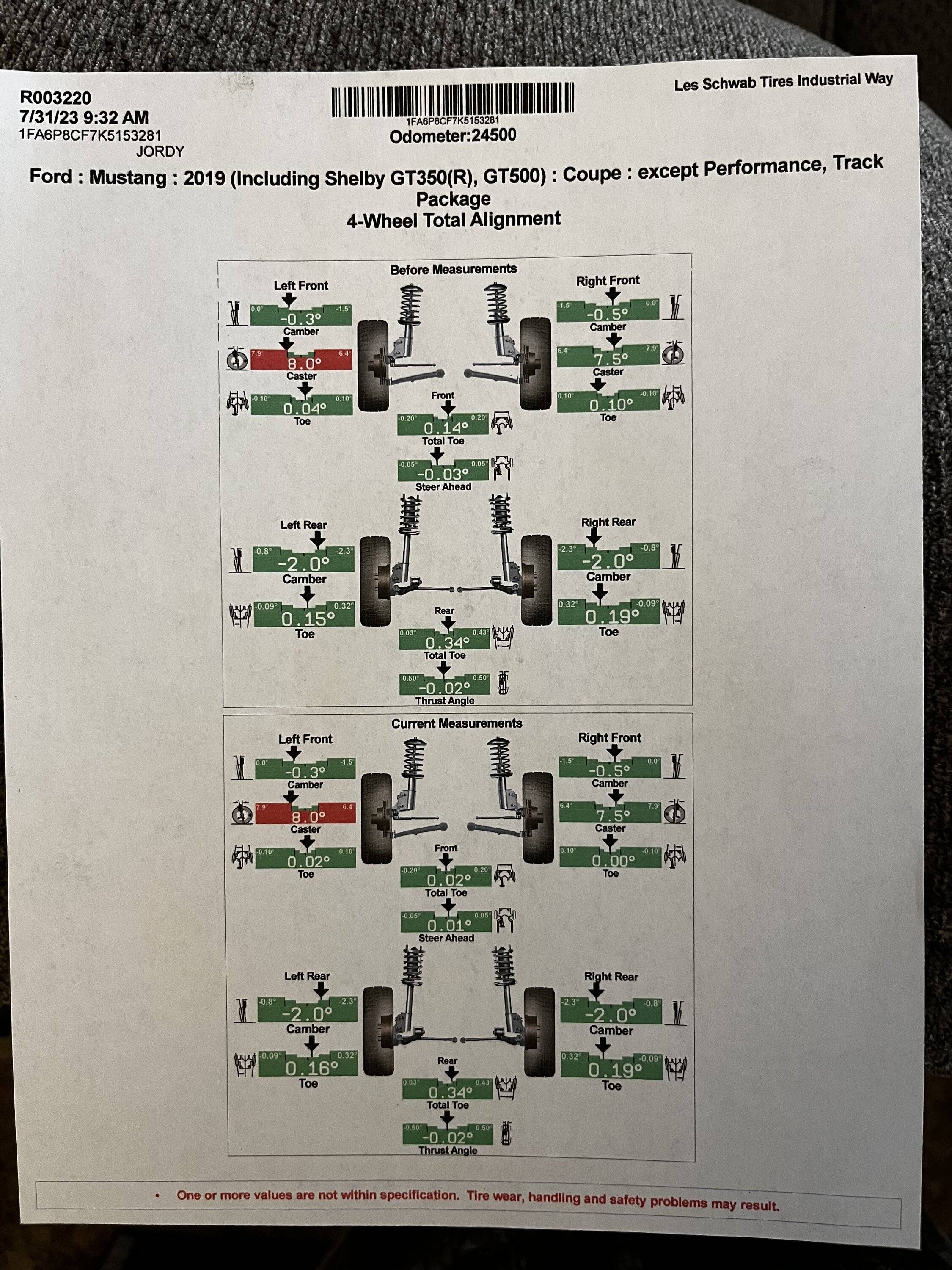

Are you sure it is not tramlining? What are your alignment specs?
I don’t believe my car is tramlining, however, I did price out the front subframe brace to reduce tramlining since it appeared to only be about $150.
I’ll find my alignment spec sheet from a few weeks back and post a picture of it, I’m drawing a blank on what they were.
I was experiencing this issue prior to alignment. I figured I’d double check where things were at in case something was super out of spec. I decided to get rid of as much toe-in as an experiment.
Next week on one of my days off, I plan on adding some additional negative camber into the front since this car came with visible negative camber front the factory, possibly adding some toe-in.
