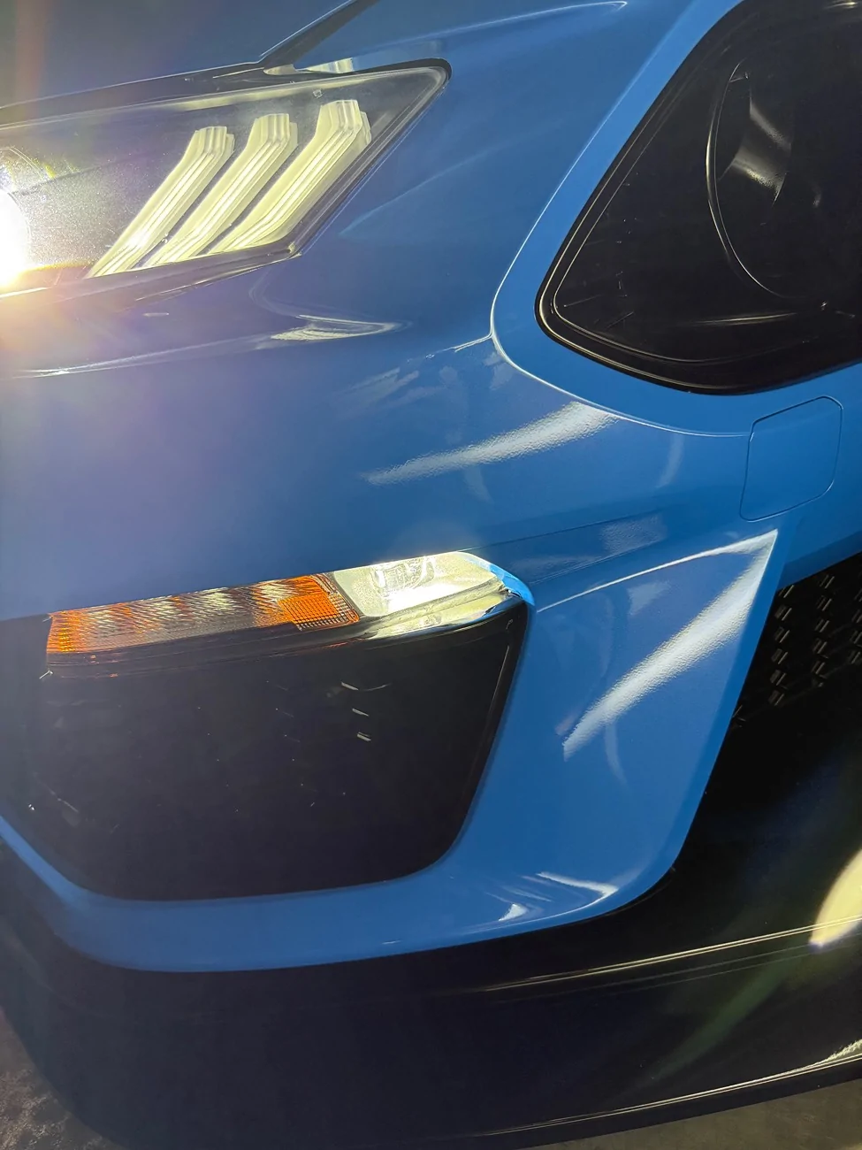

Fog lights button does nothing during day with the lights on auto on off
If the lights are on, you should be able to turn the fog lights on. Even if you just set the lights to the parking lights, the fogs should still turn on if you push the button.

When I have the lights on auto, the fog lights button does nothing during the day
