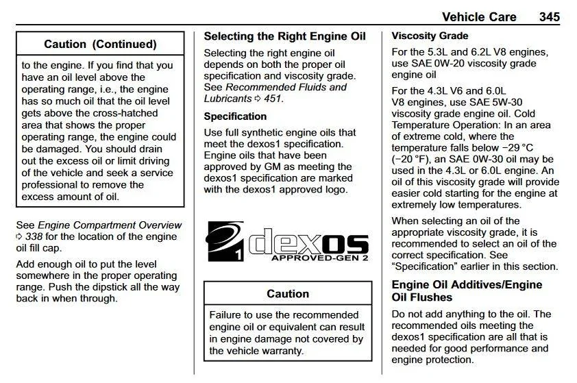

"I switched to 0w-20 Royal Purple"
I am no expert but I can read.... see if this helps
Reference owner manual
For the 2018 it''s this one
Sorry had 2012 in mind, will take the appropriate time out, be over in the corner . :computerrage:
Just a side note, another fuction of the oil is cooling, smelling burnt oil, might consider 0W-30 ?
