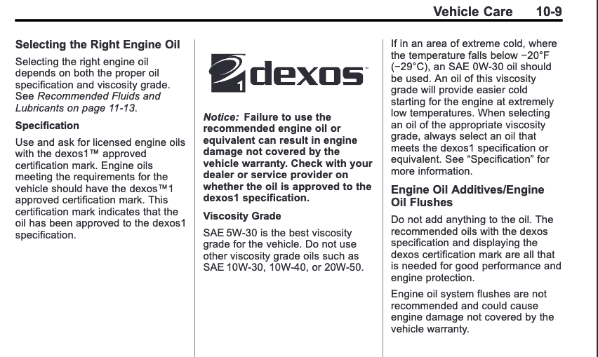

"I switched to 0w-20 Royal Purple"
I am no expert but I can read.... see if this helps
Reference owner manual
sk47
Nov 12, 2020
6,915
3,203
North Eastern TN
Jeff
Hello; Question for the OP. How did you come up with the oil spec of 0w20 for your engine?
