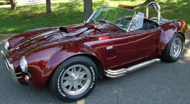

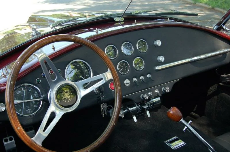

I built a FFR (mine in the pic, sold) a while back. Great experince, total fun in the build. Engine selection (I did a F.I. 5.0) doing it again, probably would do a carburated 289/stroker 302, why small block? 427's were big, heavy, a handful to drive, and never won a race of any significance, small blocks kicked ass. The hidden cost in the FFR kits are tires/wheels (again, don't cheap out here) and a quality paint job. I did my own prep (I did all prep, a buddy squirtted the paint) which was the biggest task on the build, drive in/out will cost about $9G's at a good body shop (doing stripes of course). No heater or a.c., hell, no roof, so keep an eye on the weather. It was a blast to drive, and always got attention at the gas station or car show. Vettes disappear next to them.
On the subject of tracking them, maybe Autocross, safe and relatively low speed. A high speed road course or track? No way with out a full rollcage, a 5 point harness and helmet. Look at the grille opening, now hold your hand out the window at 120 mph, hence the development of the Daytona coupes, the GT 40's. I took mine to the drags, best time of 12.9 @ 109 mph, stock 302 and a 5sp, 3:73 rear. Car weighed around 3200 with me in it and a 1/4 tank of gas.
Ken Miles and all had Balls, HUGE balls, I can't imagine pushing those cars at 180+ in competition, I sweat just thinking about it.
Anyhow, BUY ONE, you won't regret it, just get used to smelling like exhaust, and having helmetless biker hair.
P.S, standing next to one, the bodies of the 427 style cars are absolutely drop dead gorgeous, the curves, tiny doors, bulging fenders, kinda like that one girl in high school...

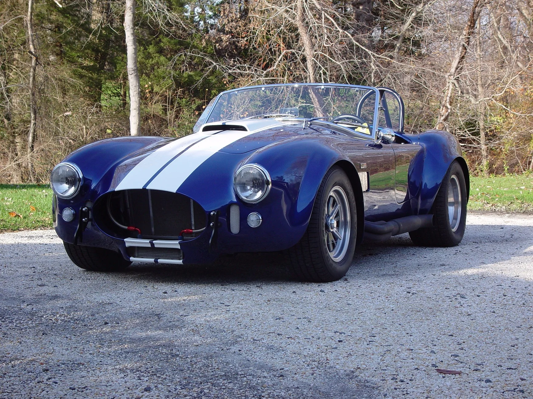

Lots of sage advice here for a prospective Cobra owner. I own a Superformance Cobra that I purchased in 2002. I cannot recommend Superformance enough. The car arrives as a rolling chassis and you (or an installer) install the drivetrain. The chassis arrives painted, interior installed (wool carpets, leather seats, Smiths gauges and such. Other niceties on the Superformance include real knock-off wheels, Wilwood disc brakes all the way around, and the ability to accept either Ford Big Blocks (both FE & 385 series) or, small block Windsors, or Coyote. The paint is remarkably nice.
If you must have 100% authenticity, then you would want to get either a Shelby Continuation chassis or a Kirkham chassis or an ERA. Superformance does take some liberties for comfort and performance. If you are looking at Factory Five, know your limitations before tackling a pile of parts that arrive on a pallet. I may be wrong (because I haven't looked in 20 years) but I believe Factory Five also offer rollers now.
Depending on which state you reside in, the title and registration process can be daunting. I lived in NJ when I purchased my roller and I had a tough time legally getting a title, but I got it done. I now live in Virginia, and they are very friendly to replica vehicles.

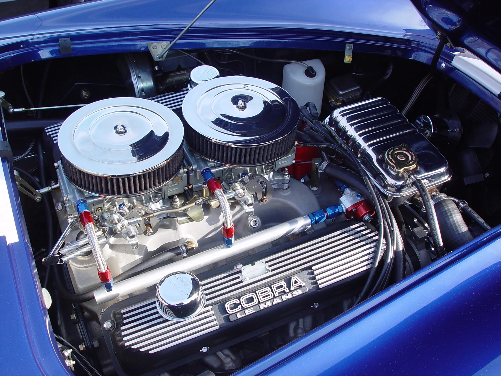

As far as drivetrain, I have a 427 aluminum FE side oiler (Genesis block) that I had built by Keith Craft. It is bored and stroked to 496 CI with twin 750 carbs. Crank dyno at 700 HP. It is more than a handful in a 2500 lb, short wheelbase car. I like using a gun analogy - you better know where it is pointed before pulling the trigger. A nice pushrod Windsor stroker is the much cheaper and easier to live with.
I am currently crating up the FE motor to send it off for getting some snot taken out it. At 70 years old, I am no longer young and dumb, so I don't need all of the headaches that come with a serious high performance engine.

A Superformance Cobra SC in All-American Blue with white stripes and an aluminum 496FE.

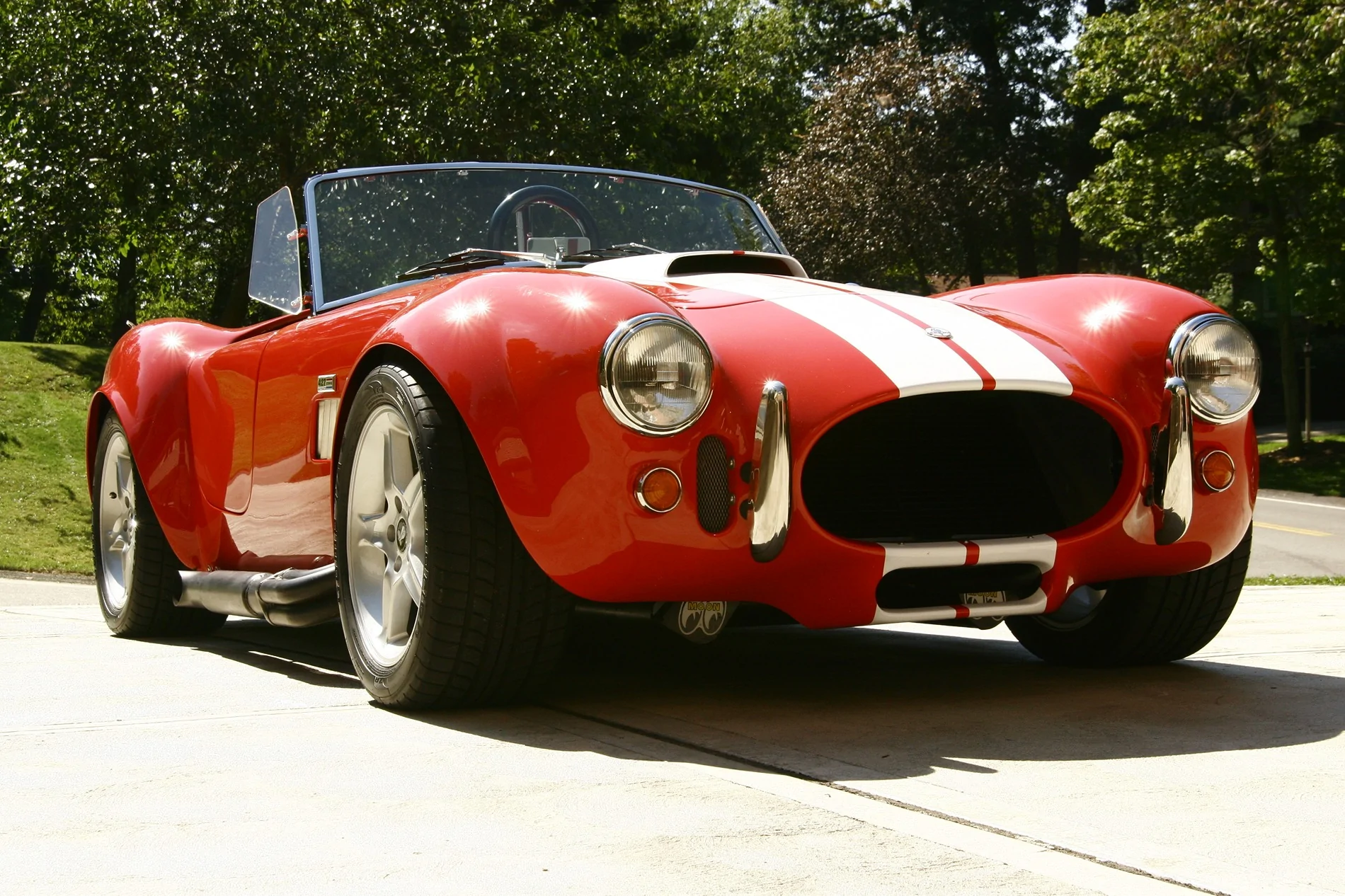

I built an FFR cobra over a period of about three years starting around 2006. I built every part of the car with the exception of paint. Building it was an absolute blast, but takes lots of mechanical experience, which I am lucky enough to have. I built a hot small block and were I to build one again I would still do a carbed engine. Factory Five does not sell any rollers as one poster said above. It’s a great experience and you will emerge with a car that YOU built, just the way you wanted it. It will be as good as you make it. I would for sure have power steering and brakes, with big tires they are a bear at low speeds without power.

Car looks great! Nice job!
