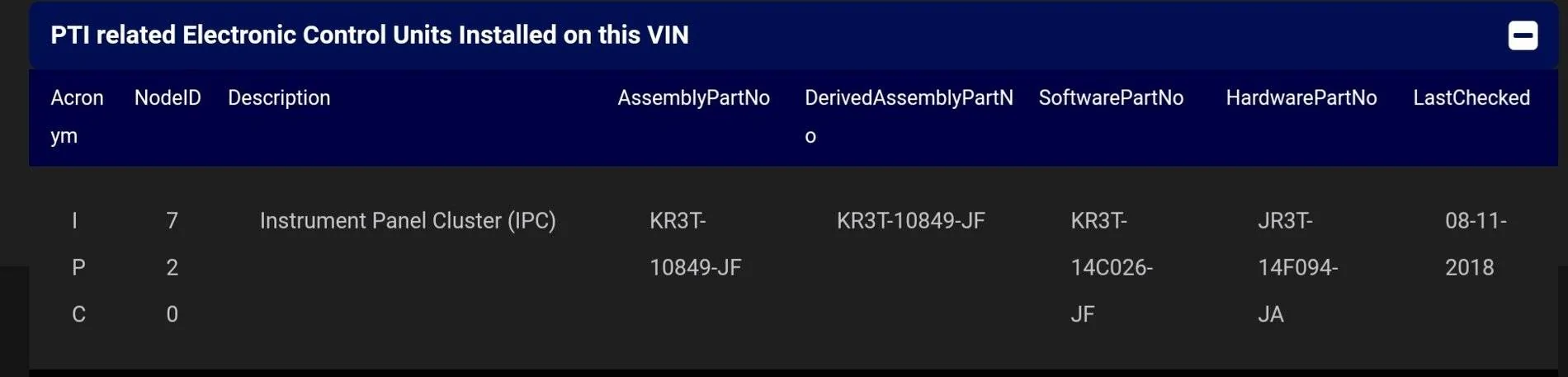

A little; thank you :). The date at the end of that chart could be your build date, so we know at least your car is that old, which makes it an early build. My 2019 was built a year later (8/9/19 vs 8/11/18).
Got a TSB notice from Ford 1.5 months ago on the Digital dash, just have not done it yet.
I see you have a K3993 Bullitt, and mine is K7979, so yours must have been built quite a bit earlier. The one above has a 'lastChecked' date (whatever that means) of Aug 11, 2018, so that's also an early build.
I don't have the FordPass crap activated on the Bullitt, but just checked the Ford website, and my car is up to date, so guess I'm out of the woods. Having said that, it seems to be just a software issue, which is great news. I was fearing there was something wrong with the electronics. Still sucks having to take the car to a dealer, but at least it won't be torn apart to replace the damn dash. Good luck.

I also came accross this which has some useful information.
Thank you. And that's for 2019s. However, it just says that it goes blank on start-up. Mine has always taken a couple of seconds to 'wake up' after turning ignition on, but that's perfectly normal IMO (self checks, etc). Unfortunately, that complaint doesn't say how long, which is crucial to identify a normal condition or a defect. The way it was worded, doesn't appear to be a defect IMO.
Having said the above, when the cluster goes blank while driving, THAT is an obvious issue. Fortunately it hasn't happened to me, at least not yet. Ha ha. But the good news is it appears to be a software/firmware issue, rather than the hardware, which is great news.

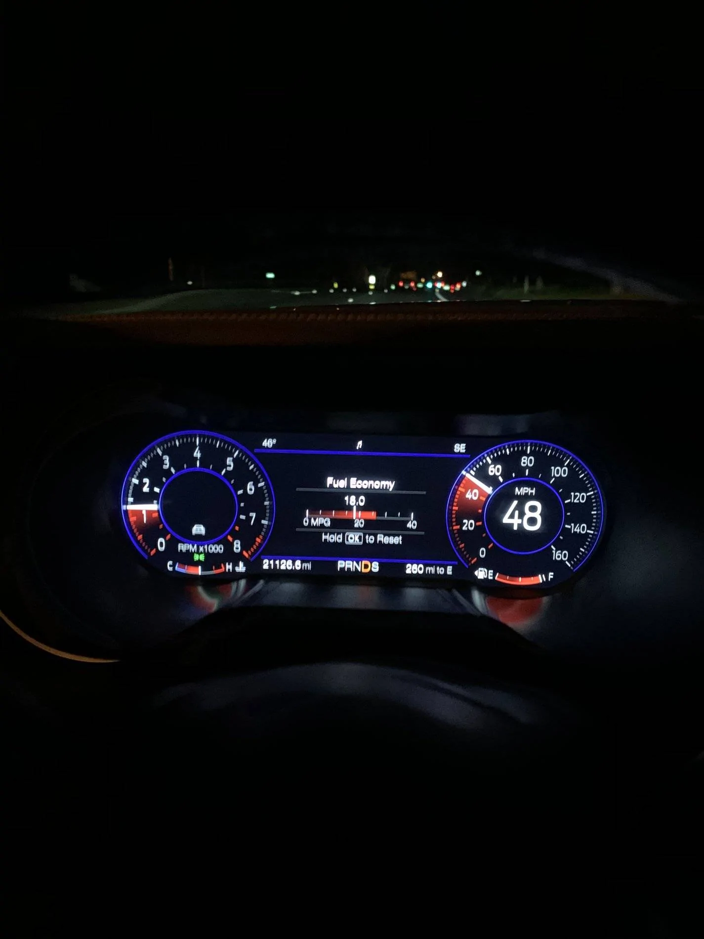

Anyone else have their digital cluster go blank while driving? On my way home last night about 5 minutes into my drive the cluster just shut off, blank, no back light or nothing, stayed off for about 45 seconds then came back up. Everything seemed normal except it no longer showed what gear I was in just showed my speed. Popped it into neutral at the light and it went back to normal, first time that's ever happened. Anyone else have any issues? I attached a picture showing the no gear displayed
Dealership just called, Ford approved replacing the digital cluster, it's been ordered.
