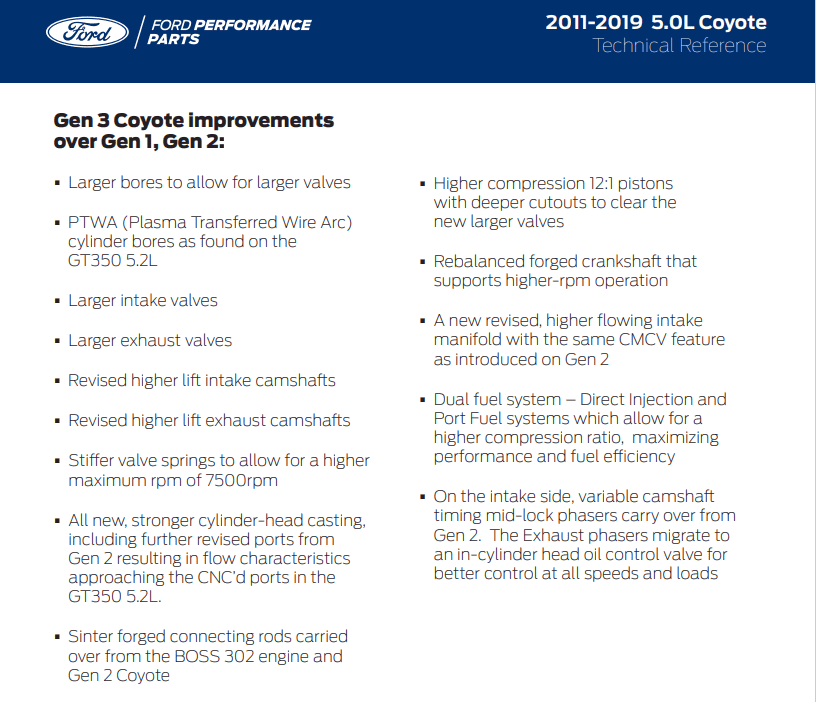

There are numerous differences between a Gen 2 Coyote and Gen 3 Coyote, some small, some significant. Here's a complete list from Ford:
The physical component dimension changes are incremental - Cams have 1 mm more lift (intake and exhaust), bore is increased by 0.8 mm (overall 307 ci vs 302 ci), valve diameters are increased by less than 1/2 mm. The compression ratio is increased from 11:1 to 12:1, a pretty big change IMO. The head bolts are 1 mm longer.
Read this entire document, it contains a lot of info.:
https://www.mustang6g.com/forums/attachments/coyote-technical-reference2-pdf.450266/
