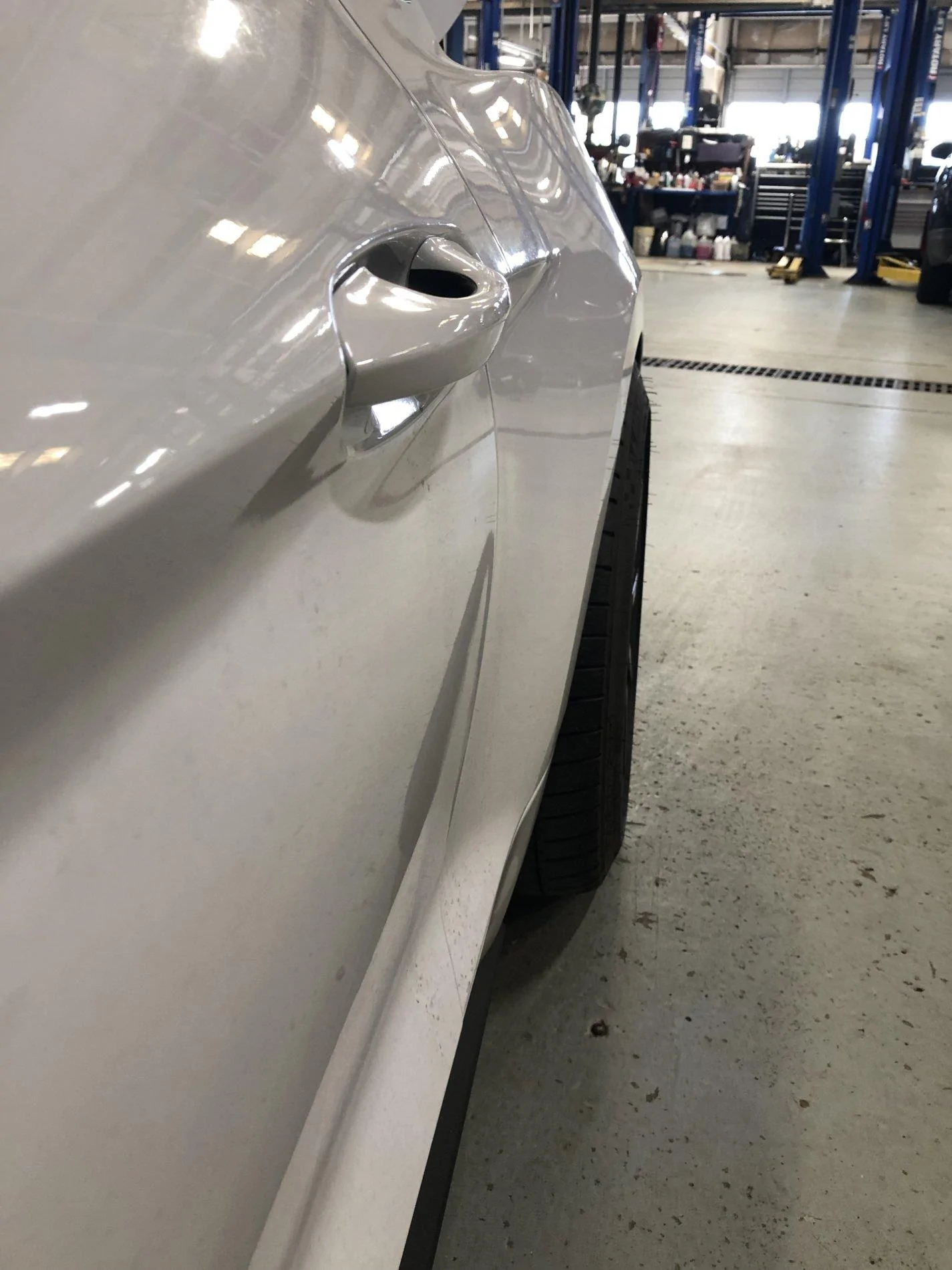

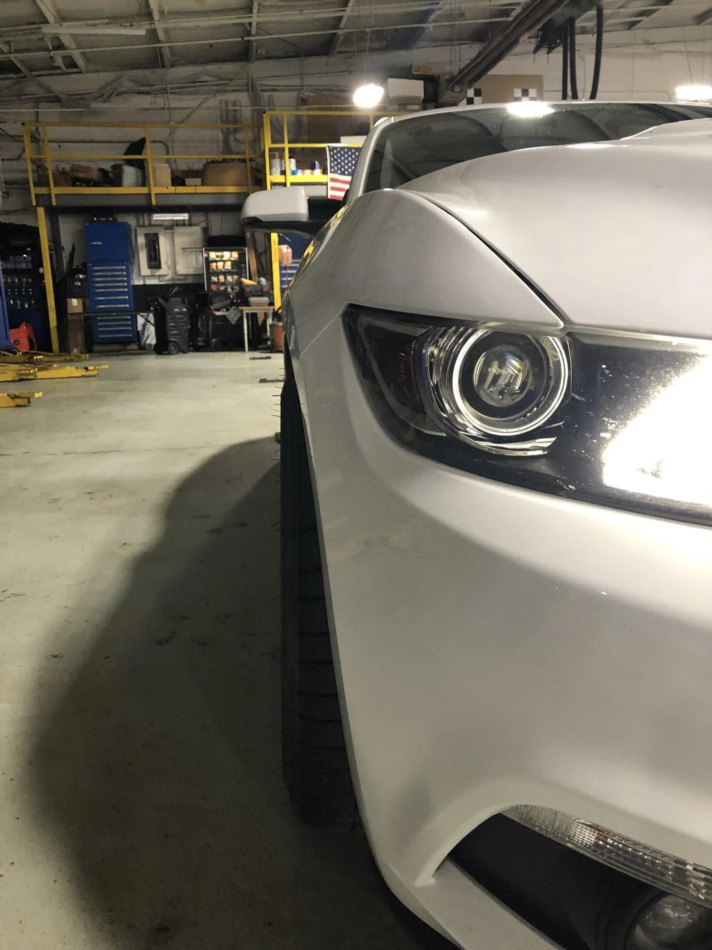

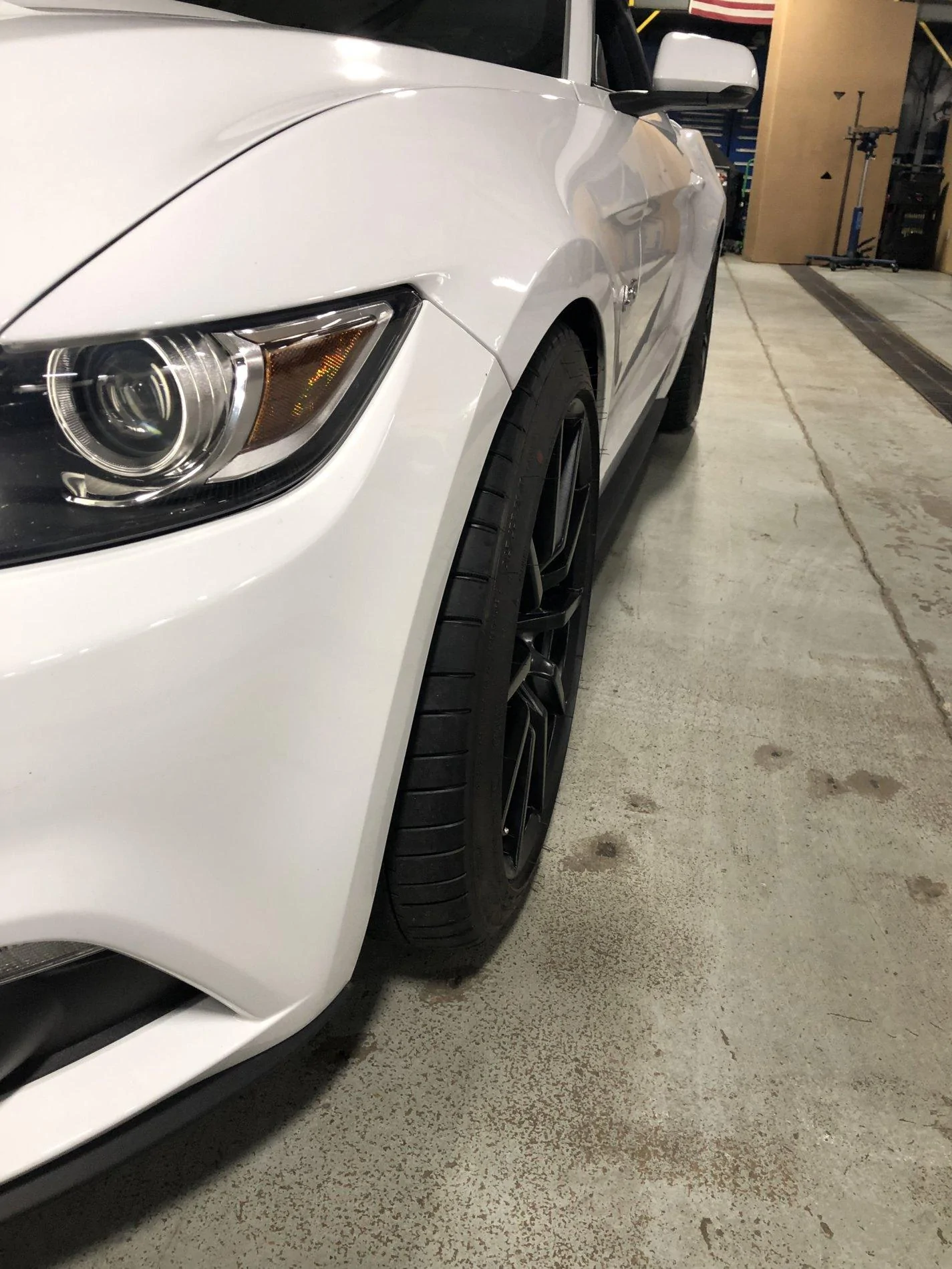

First two are 19x10.5 +30 on the front with -1.3 degrees of camber. Last two are 19x10.5 +30 on the rear with -1.7 degrees of camber. These are on a non pp ā€˜15 gt. If you’re looking to do 285/35/20 all around, I’d probably stick with a 20x10 + 35 if you can find them

Thank you sir. Tires are Michelin Pilot super sports in 295/35 on the front and 305/35 on the rear. PP2 wheel offsets are +24 and +48 respectively
