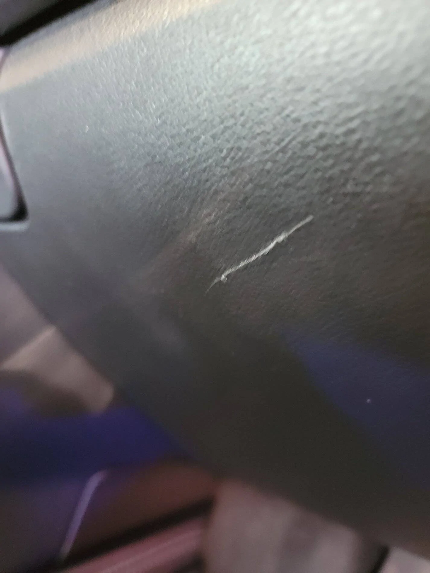

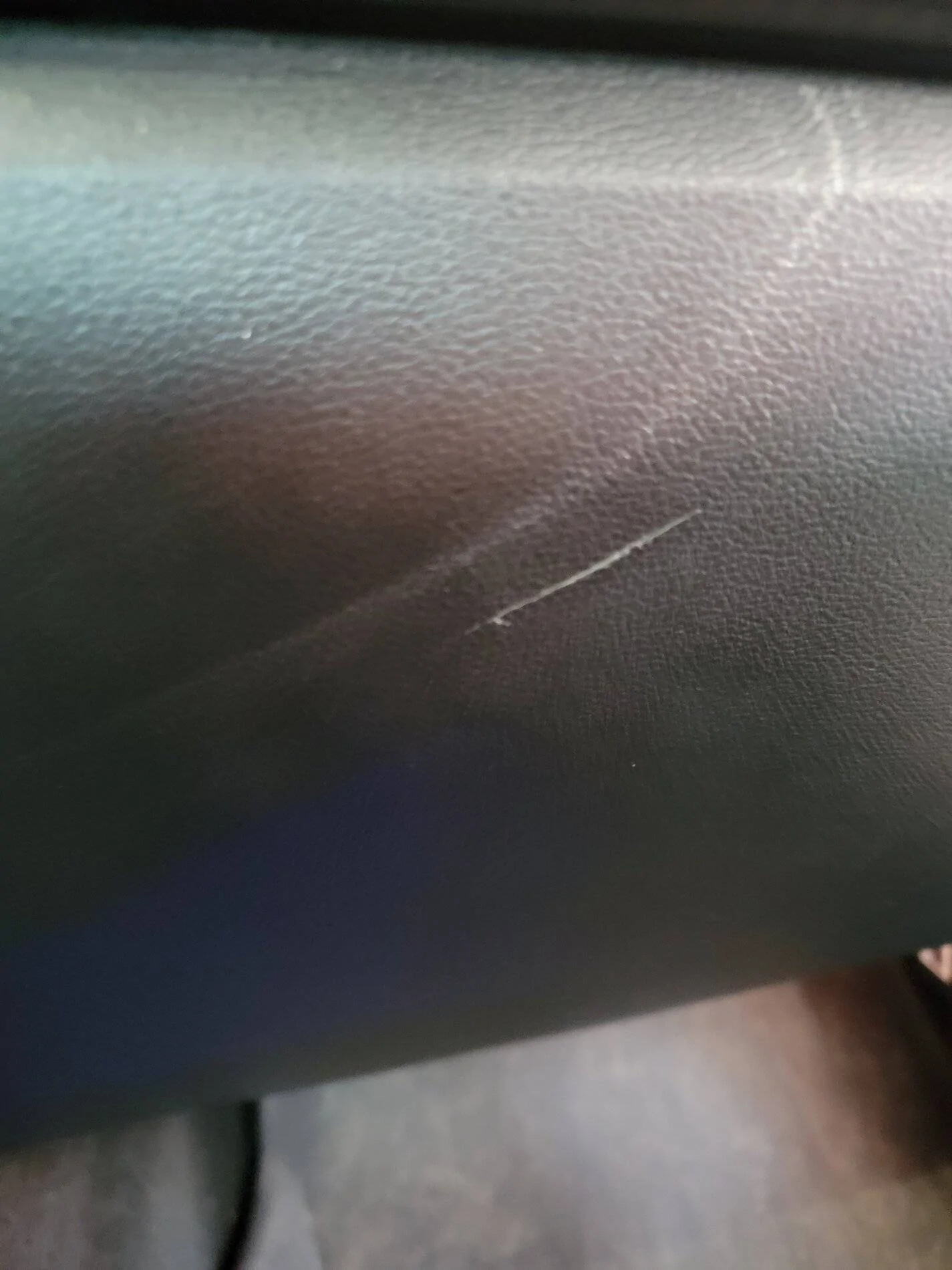

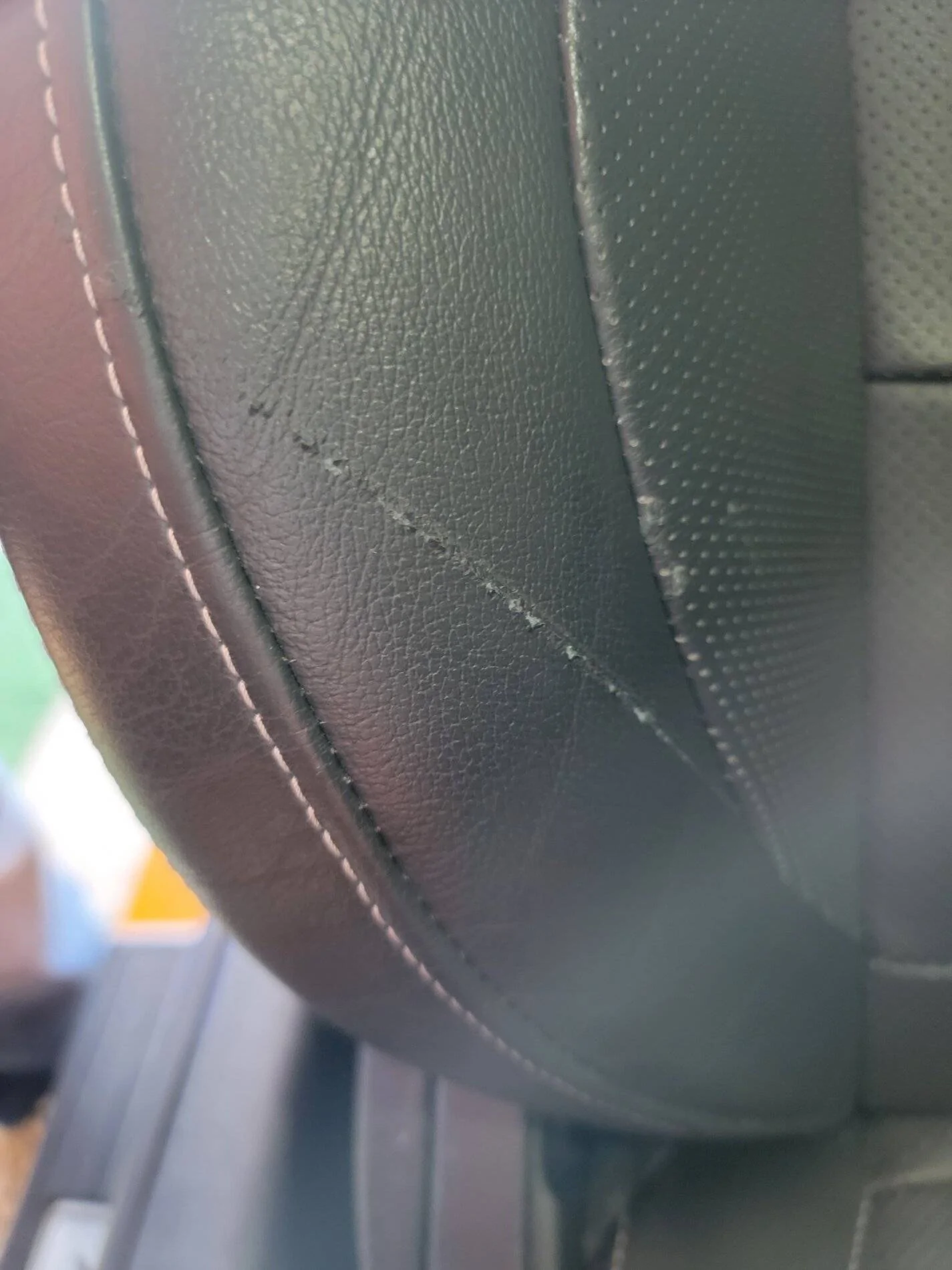

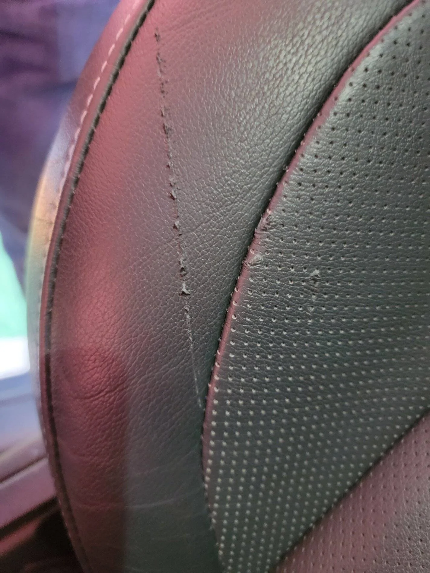

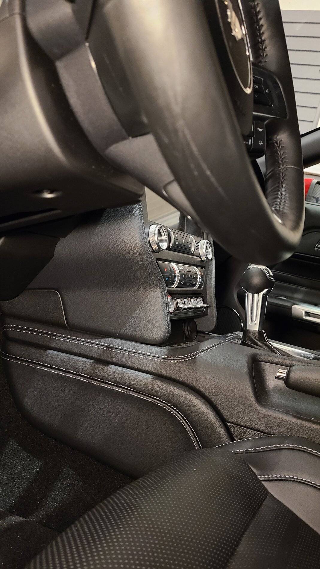

Any realistic way of repairing these? I guess I gotta keep a closer eye on my passengers since they apparently love carrying semi sharp objects. Maybe its time to place a seat protector on the passenger side, I dunno.

Unfortunately I don’t have a solution for you. That’s rough though. We’d have to sit down and talk about our friendship if one of my ā€œfriendsā€ gouged my seat up like that

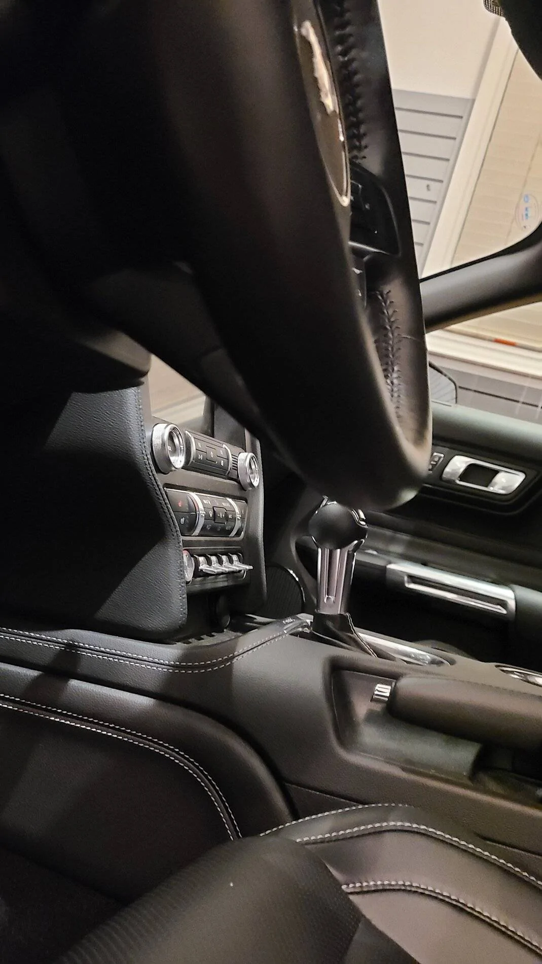

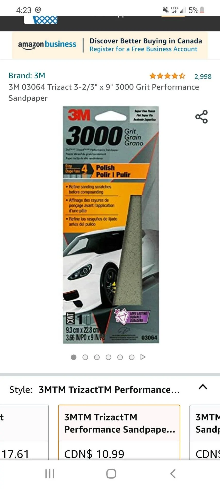

I had a bad scratch on my steering wheel. I used 3000 "sandpaper" (it's more like a spongy fabric) by 3M to take down the "burrs", then hit it with black shoe cream. Use shoe cream, not polish.
98% like new.

For the glove box door, I’d just source another on eBay and replace it - easy repair.
The leather, well it looks like that ā€œscratchā€ is more of a cut that went pretty deep beyond the initial layer. I don’t think it can be repaired or made to go away. Again you could skrice another seat cover off eBay and just replace it.
